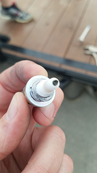

Well, big thanks to Derek @srtthis for his help last night. I went to Atlanta Motor Speedway's Friday night drags, designed to mimic street racing, sorta. They did add a tree recently, but no timers. 1st across the stripe wins. I entered the Street Mod class, consisting of a single power adder and hard tires.

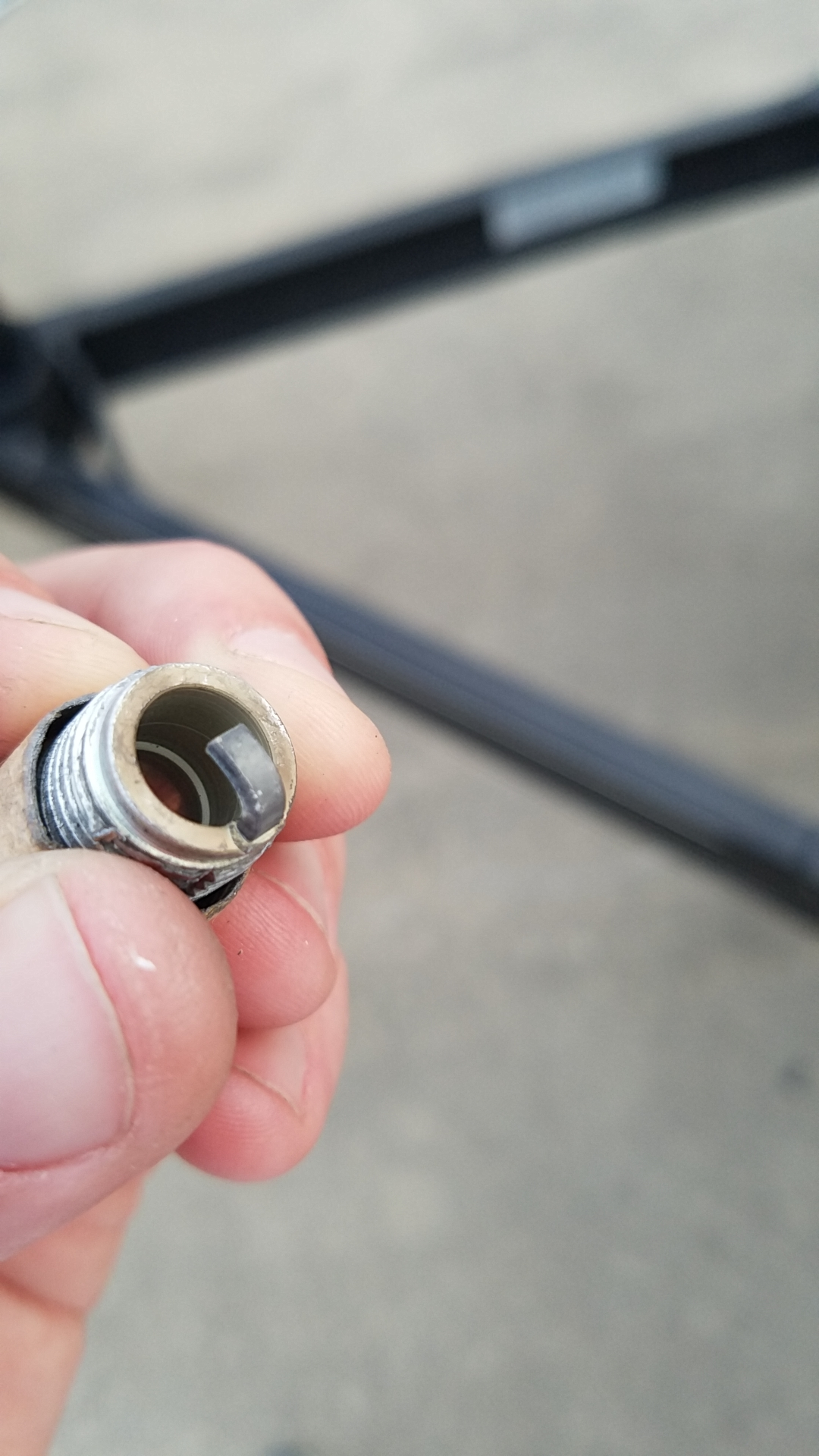

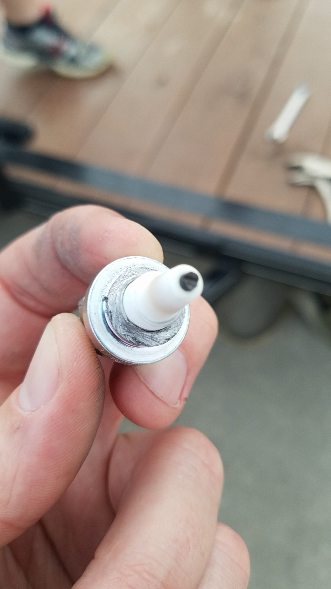

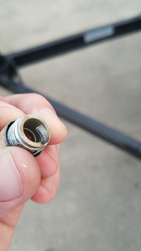

I jetted it with a 100 shot and left the timing at 10 with a 110/93 mix. Progressive was set up with a .5 second delay, starting at 30% - 100% in 1 second. 1st run felt good and I killed the motor at the end and pulled off. Sent the pics of the plugs to Derek and he provided me with some great advice. Ended up adding a few degrees back in and ran it this way the rest of the night.

just curious how much timing did you end up putting back in it?
I ended up at 12, but looking at the strap I think it could take more. I wanted to ask if you think the heat range 7 is still too cold? I kind of think it may be.
