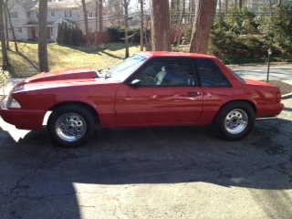

It would help to have a pic of the car they are going on. Lots of factors like color/body/them go a lot into picking a wheel.

I have a red 92 notch w/ 4" hood, Im not sure if the pic is going to come out. It looks awesome with the welds its just not what I want. @ gearbanger rims look good, what did you have to do to get the rears in ? You still have tail pipes so it cant be to tight
Nothing much really. I tried flipping the quad shocks and ended up snapping off the bolts where they mounted to the chassis, so I removed them altogether (no wheel hop what so ever.) I loosened my exhaust and pulled it towards the center a little bit. Otherwise, I've got no clearance issues. They sure do look good from behind though….
I am getting some rubbing on the front wheels however that makes itself really apparent when I turn into a dip in the road, or off the street into an uphill driveway. Looks like the inside of the wheels is making slight contact with the lower front control arm. So plan on a little "massaging" if you go with the 9" wide wheels in the front....or just go with 8" and not worry about it.
