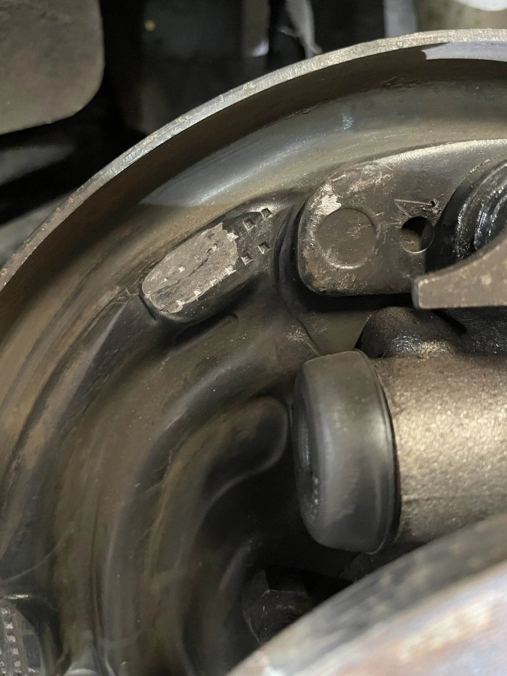

Picture of the driver side and the shoe with the shorter pad is in the front as it should be on both sides.
Figured a picture would help?

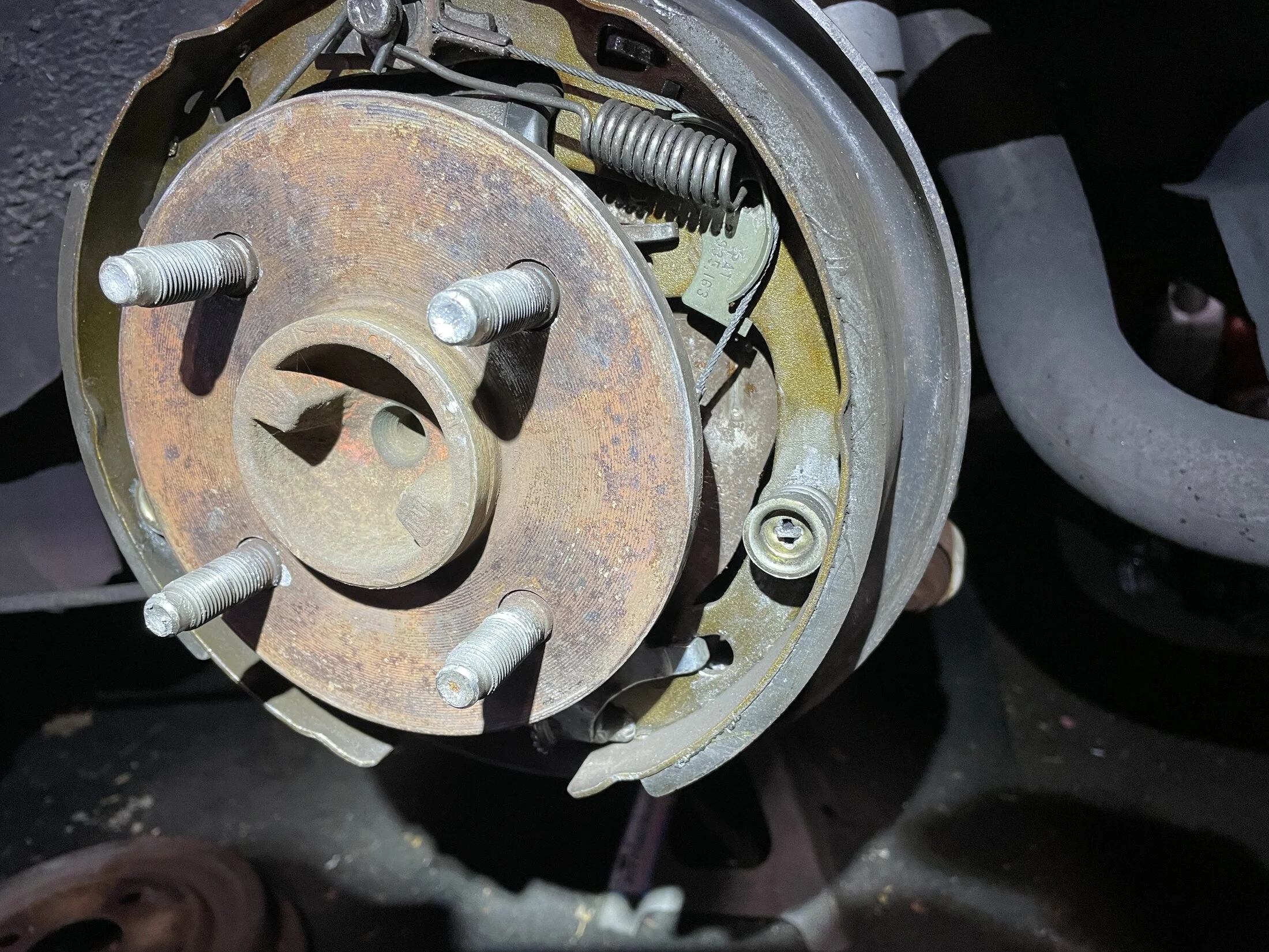

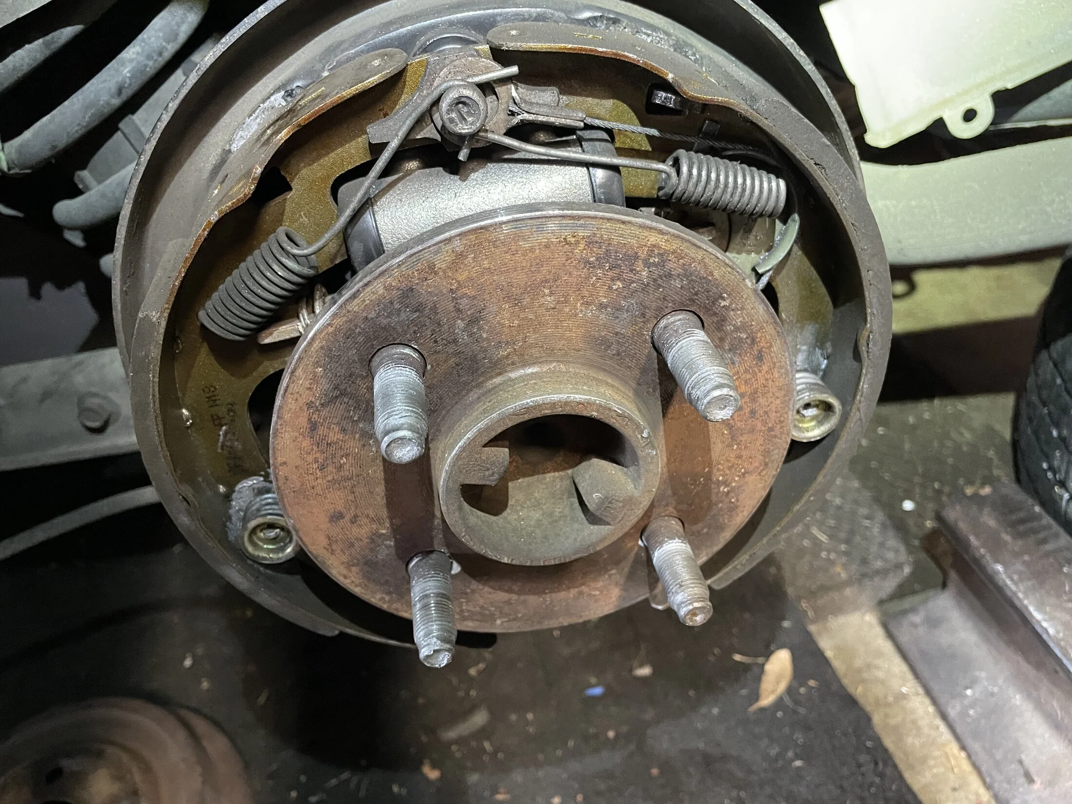

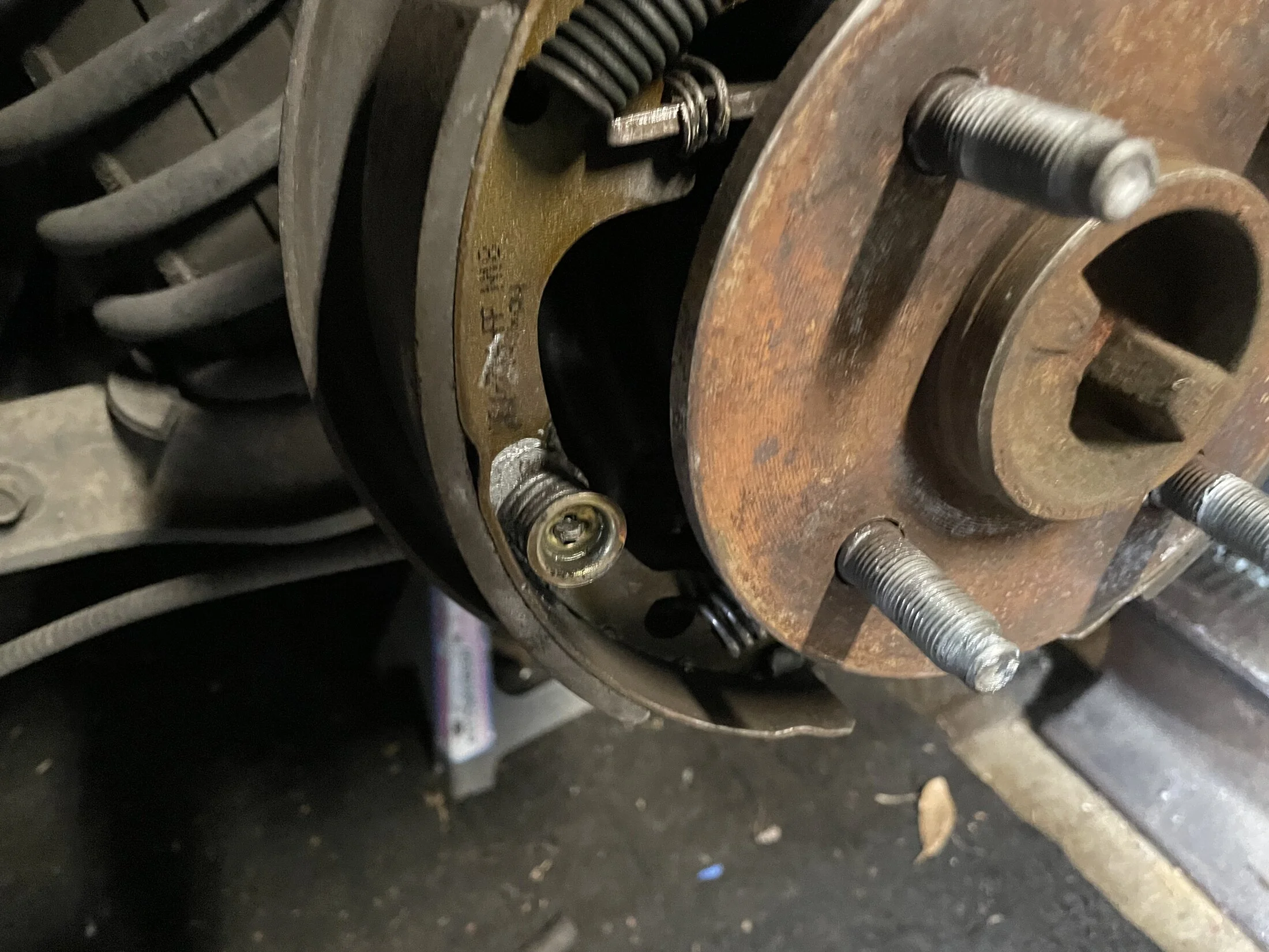

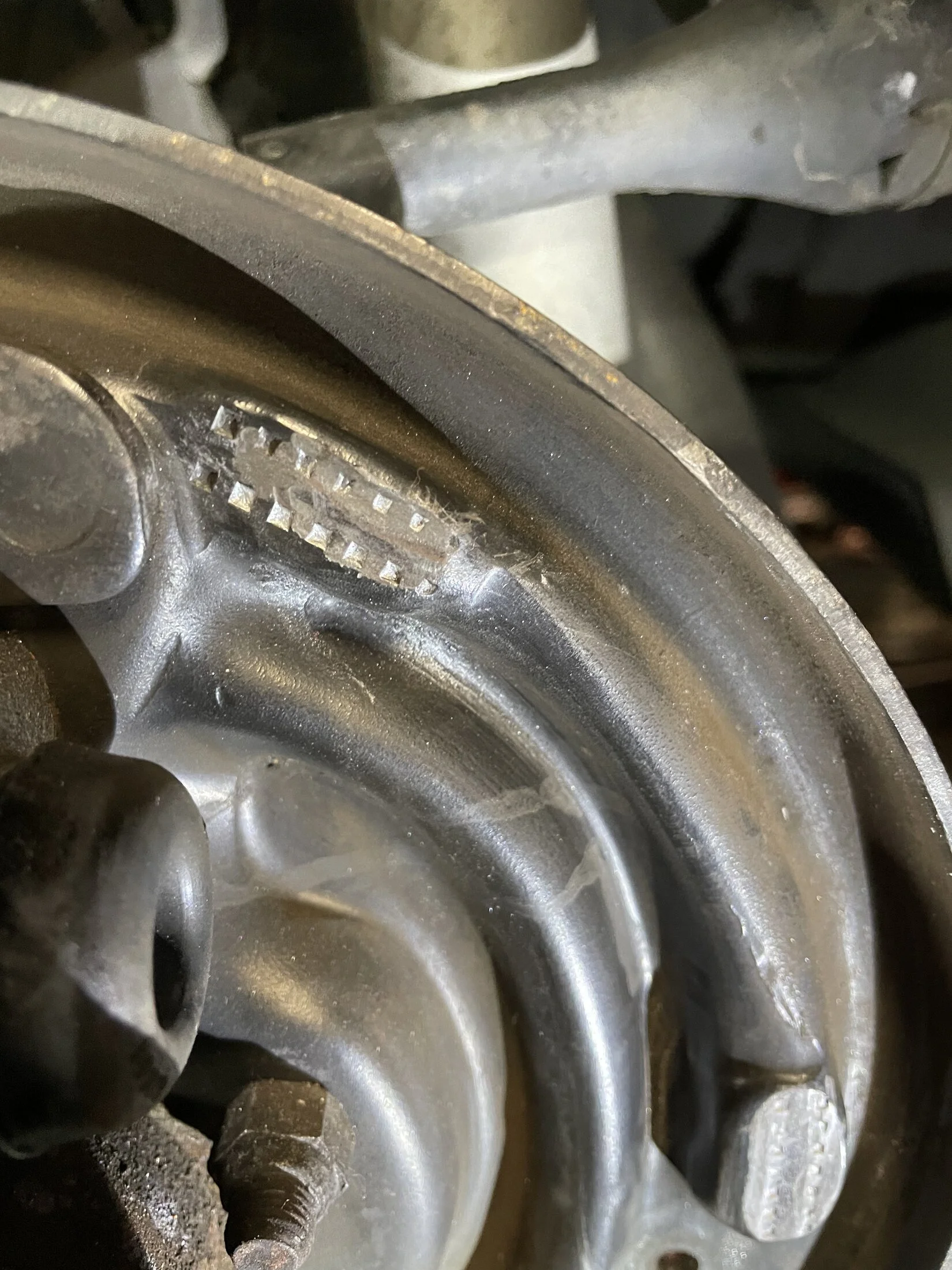

Back at this again because the clicking is driving me crazy. Pulled the wheel and drum off. I don’t see anything??? Took it all apart again as well. Still no smoking gun. Backing plate is worn up top but not super bad in my opinion. I’ve seen worse. Here is what everything looks like.

Third picture. Can you get a better picture of the ebrake auto adjuster, auto adjuster spring, and auto adjuster plate. Reason I ask is that plate looks bent / wrapped around the end of the auto adjuster in that picture.
