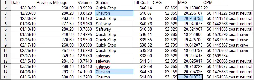

I just wanted to resurrect this thread and share my 2c. I have been making a conscious effort to try and drive under 2k rpm as I heard that was a sweet spot for good fuel economy.
I'm driving an 03 so I don't' have a gas mileage indicator. But lately I have been resetting the trip odometer each time I fill up and then logging my mileage/refill qty in a spread sheet to figure out my mpg. During the last 4 fill ups I have averaged 20.08 mpg with my best at 20.958 mpg (I still had half a gallon before filling up). I'll be filling up again in the morning and I expect to be close too 21 again.
My commute distance is only 12 miles (but sometimes a little extra city driving after work to get some fast food)
Basically the last few weeks my driving practices have been as follows. Stay under 2k rpm (even when getting on the freeway). Sometimes I can't help it cause one on ramp is a steep incline but usually I'm barely over for just a short time.
Coast down hill
Coast exiting freeway (typically until stop sign/light)
Coast to stop signs/lights.
I encounter several hills during my commute and of course on the return trip too. When school is out I can typically get to work in about 12 minutes so that's a 60 mph average. When school is in it takes about 25 minutes so that's about 28.8 mph if my math is right.
So with my main goal being low rpms I just figured low rpm = low fuel consumption. Prior to reading this topic I never considered fuel injection would shut off during coasting. All I knew was the RPM's would would stay around 1500 vs about 900 when coasting.
Now, I did know that keeping it in drive provides a slight breaking affect but breaking doesn't help fuel efficiency because you lose a lot of momentum and therefore cannot coast as long. My max coasting speed is about 75 and I don't break that much.

Hey everyone. Just wanted to report back here with my fuel log.
One important thing to realize is the MPG is based on the fuel from the last fill up because you can't know your rate of consumption until you, you know... consume it. hehe.
I have logged all pertinent info, date of fuel up, mileage since last fill up, volume fille, name of station, fill cost, cost per gallon etc.
What I find interesting is I have achieved the best MPG when filling up at chevron. And keep in mind I always fill with regular no matter where I go.
And as you can see, chevron always costs about 10 cents more per gallon. So in a full tank of 14 gallons, I am paying $1.40 more for chevron than other places...BUT I get half a mile more per gallon efficiency which is like getting like 1/3 of a gallon saved for if that makes sense. Or tell me if my logic is flawed.
One thing I hope to see more clearly is how much traffic really plays a role in fuel economy for me. As I mentioned I have a pretty short commute but I do no i'm on the road longer when school is in. So hopefully this summer I'll have a good few months to fill up at a variety of stations and get more consistent results.
Just in case the attachment messed up when I replied here's another link.
attachment.php
