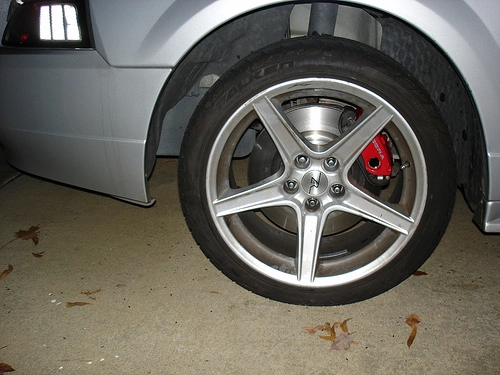

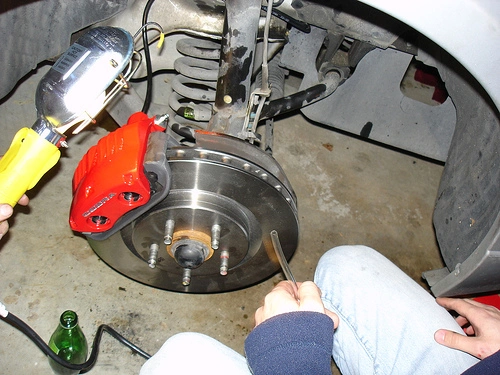

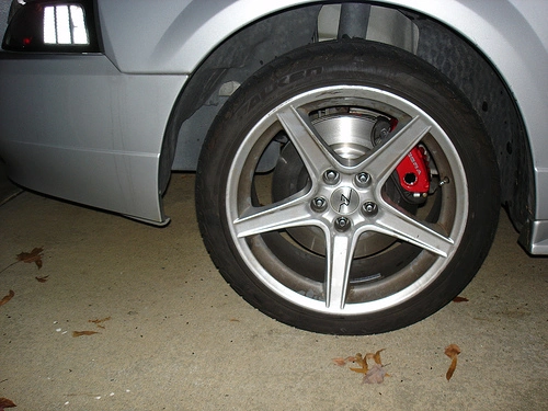

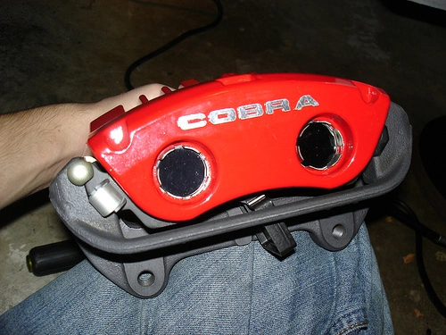

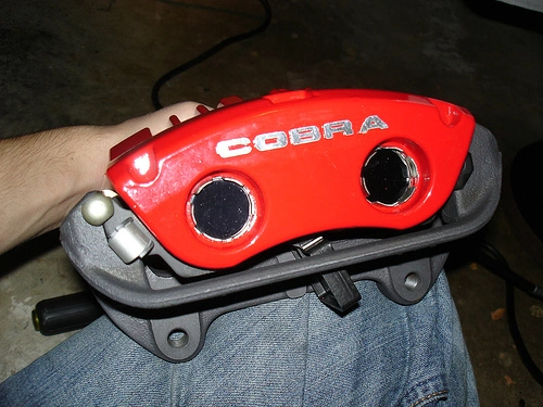

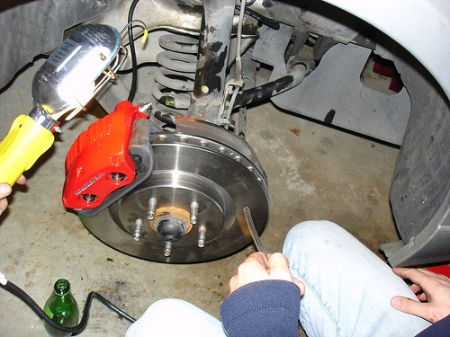

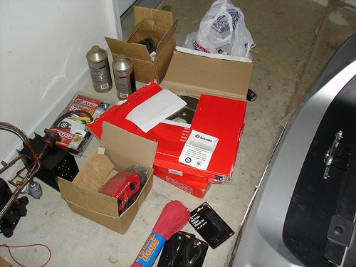

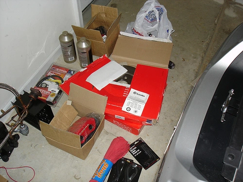

Cobra Brakes installed on my 02 GT *pics*

Looks awesome! I have my Bullitts in transit, and I can't wait!
I got a few questions if you dont mind. Did you buy them from buyfordracing? If you did, did it come with new banjo bolts and crush washers? If not, did you reuse the stock banjo bolt?
Thanks!
Stang|ess, yup i got it from ford racing. the SS lines it came with had the banjo bolts and all that. The only things I reused were the two very large bolts that hold on each caliper to the spindle. torque them to ~65ft-lbs if you have a torque wrench. ALSO they are VERY VERY HARD to loosen, at least for me. I got a mapp gas blowtorch and heated them up for about 25 seconds, let it cool for a min and then it loosened like butter. =)
also, the SS lines are left/right specific. I wasted 20 minutes tryign to fit the right line on the left side to find out they are slightly different sizes and it wouldn't fit.

You might want to paint the center of the rotors or they will rust up badly!!!
For some reason Brembo isn't painting the centers anymore.
What i did was drive on the brakes to figure out where the wear area would be, then use electrical tape to mask off the pad swept area and then covered the calipers and sprayed the rotor center and outer edges with high temp paint and let dry.
I did mine in silver to match the car
