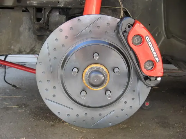

Bleh. Life got in the way and well...I just wasn't inspired to do much. So I took a break for a while and worked on my other ride, a 95 GT. It's hard to keep doing all this work and not being able to drive it, y'know? Some upgrades and maintenance on the GT and I'm feeling much better. First off, a pic of work I finished about a month ago - the rear brakes complete with rotor:

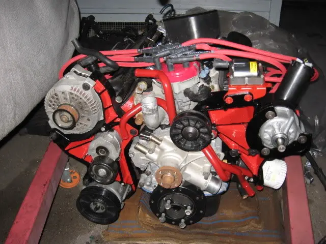

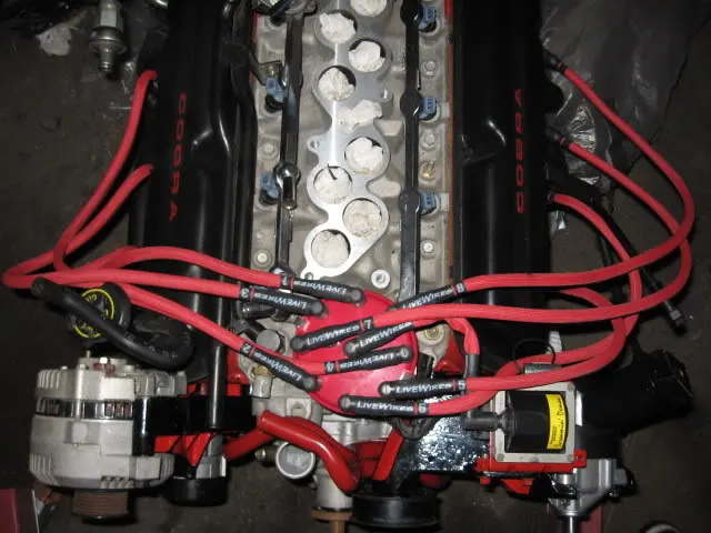

Next, work I finished this weekend. There really isn't much left, just installing parts on the engine now:

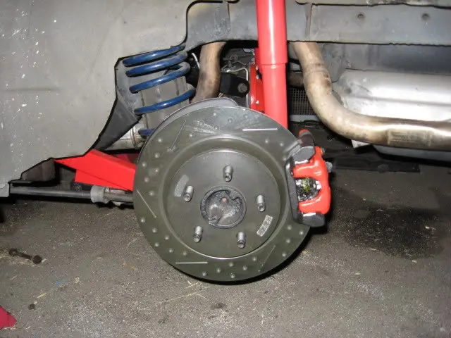

Well, despite HollywoodStang not replying to my question about his girlfriend, I got some more work done this weekend. First off, I got the front brakes installed:

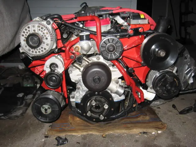

It took most of the day yesterday to finish wrapping the harnesses. The Cobra got hit hard enough in the front that the battery cracked and spread some battery acid on the motor. We found some dried acid in the injector harness, but fortunately no actual damage. So I'm glad I re-wrapped the harnesses. Here's what the engine looks like now:
