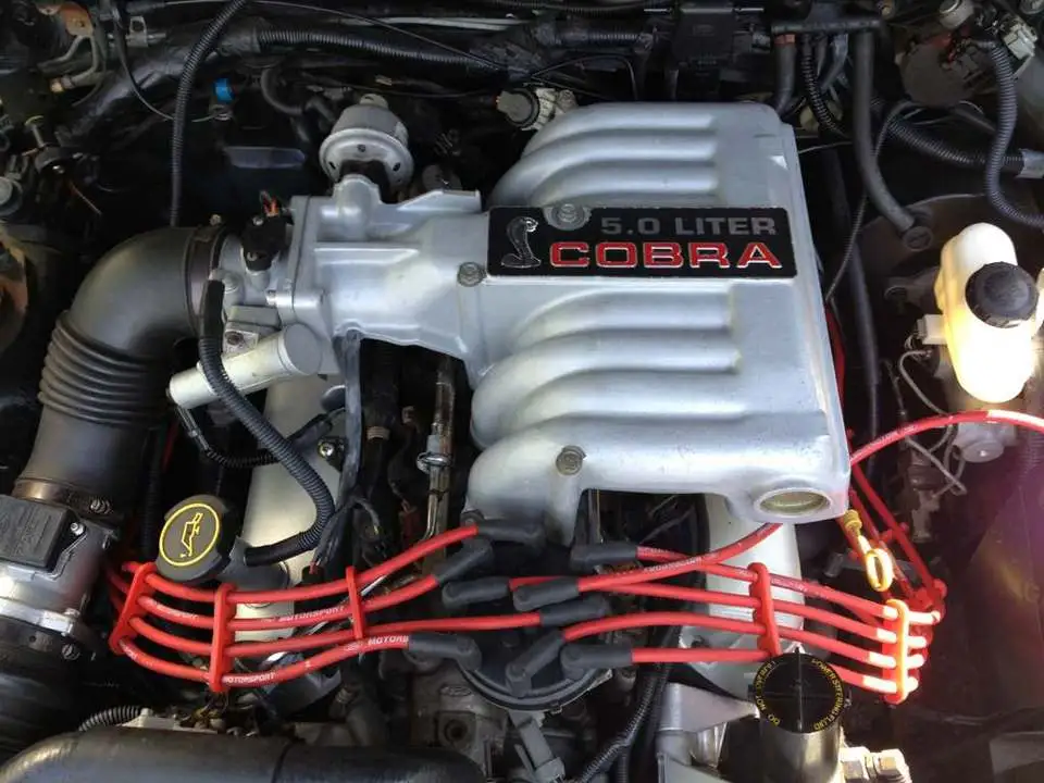

You don't run a spacer...it's built in. If you don't run the egr you need to block it off. Here is mine:
Edit: also that rubber hose coming from the nipple from the built in egr spacer in the front is NOT for the coolant hose from the hard pipes. That is not used on this intake. It is capped off on the hard pipes. That nipple is for the charcoal canister return line. I found out the hard way on that! :)
