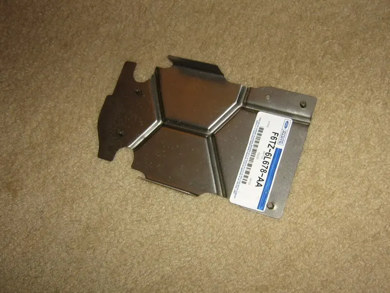

well the baffle in the Cobra Intake (china one) is identical to your HO Intakes.
So technicly it shouldnt suck any more oil than a stock intake.
Ive ran my car for ~ 1 hour since installing the new intake and the PCV is dry.
o.k, so i guess im going to install the "new baffle". Where do i get one?
I also did a search and someone had a pic of the new baffle installed but now i cant find it, anyone know where i can get this pic? Thankx for the replies!!
Had the same problem with my China one. But it only seems to be a problem in HCI combo cars not on stock cars because of the increased crankcase pressure. I re-routed my PCV to my driver side valve cover (tall FRPP polished covers) and it slowed down greatly but still get some in the oil seperator. I now may try a 2nd PCV in the original location as the velocity of the intake pull will be decreased and it should be better. I just hate to pull the intake off after the install.
