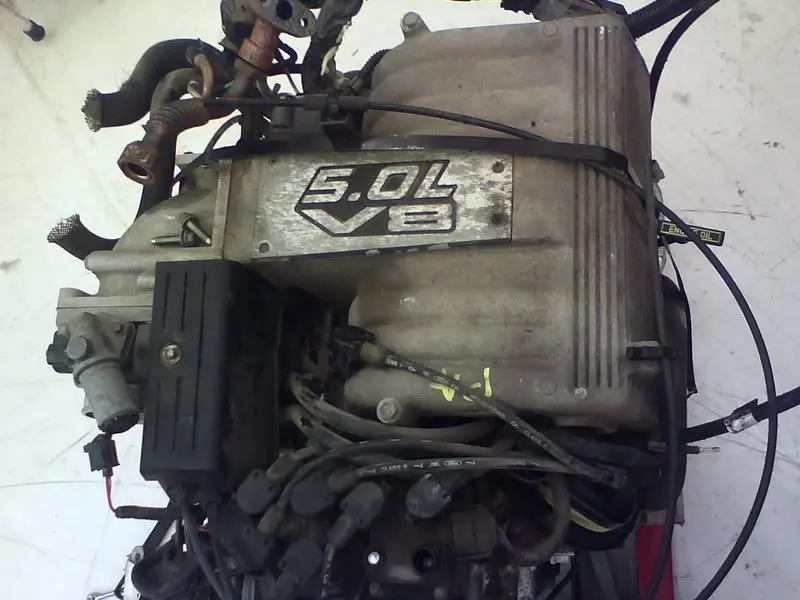

Anyhow, I'm finally getting around to building up a budget 5.0 and I found a 90's Mercury Mountaineer that no longer runs and so I'm going to pull the intake off it to use.
So my question is: Is the right manifold (similar to the 1993 cobra) that will boost HP for about 30hp right?
Also, is it pretty easy to take the intake manifold off with basic tools? How long should it take?

30 horse...crank maybe, but still not likely on its own. you can get it off with basic hand tools pretty easily. How long depends on the person. Take the heads off of the mountaineer also.

Get the throttle body too. It's 65 MM vs. the stock 60 MM on Mustangs.

30 hp is very optimistic but anything is better than the stock piece. It's not a bad intake if you can get it cheap enough.

Explorer intake swap.
I got mine off a 96 Mountaineer with the 19# injectors and 65 MM throttle body for $250.
The ACT (Air Charge Temp) sensor will probably need to be moved. The GT 40 lower manifold isn't drilled & tapped for it to go into the intake like the stock manifold was. There is a boss cast into the GT 40 lower. You will have to take the manifold off the engine and put it on the workbench to drill & tap it. The ACT uses a 37/64" drill or 9/16" drill and a 3/8" pipe tap. See Industrial Supply Equipment from MSC Industrial Supply or McMaster-Carr if you can't find the drill bit or tap locally.
The next best spot for the ACT is the stock air box if you don't do the drill and tap thing. You get to cut and splice the 2 ACT wires in order to make them long enough to reach the air box. Solder the wire extensions on the existing wires & use heat shrink tubing to cover the splices. Offset the place where you cut the wires so that you don't have a big bulge when you put heat shrink over the 2 wires to cover & protect them. The air box gets a hole (5/8" or so) for the ACT drilled about 1 1/4" down & 1/1/4" in on the front top side near the upper radiator hose. A brass fitting nut from Home Depot or Ace Hardware secures the ACT into the air box.
If you are very clever, you will find that the ACT connector comes apart so that you can remove the pins. A very small screwdriver releases the lock in the front of the center insert, while another small screwdriver inserted in the back pushes it out. Once the center insert is out of the connector shell, the pins come out easily. New pins are available from AutoZone in a $5 electrical pin kit for Fords. Crimping the pins on the extender wires saves you from having to splice them twice: once to put the connector on and once to extend the wires.
6 ft black 18 gauge wire
6 ft green 18 gauge wire
6 ft 1/4" heat shrink tubing
1 ft 3/16" heat shrink tubing
Measure the 2 extender wires & cut them to length, crimp one set of pins on them. Then mate up the extender pins with the wiring harness & slide the 3/16" heat shrink tubing over them & shrink the tubing. Then slide the 1/4" heat shrink tubing over the pair of wires and shrink the tubing. When you are done you'll have about 1" of wire left without heat shrink tubing on it to strip & crimp the new pins on. Stick the new pins in the old connector shell, assemble it and you are done. It looks as good as factory. Some wire loom can be used to enhance the "Factory Look".
Use the TPS and IAB from your old throttle body. All the EGR passages were there and fit OK. Use you old fuel rails and regulator. You will probably need a new EGR spacer adapter and gaskets. Without the EGR spacer, there is no place to mount the throttle linkage support bracket.
I used the stock water lines on the Explorer manifold and they connected up to the EGR without any problems. I made a “U” out of ½” copper pipe and sweat soldered it together. Then I used it and some hose with clamps to bypass the leaky heater I have. You don't need heat very often here in Central Florida...
The vacuum lines you need are 1 small line for fuel pressure regulator, 1 small line for A/C,1 small line for EGR and another small line for the smog pump. One big line at the back goes to the vacuum tree for the power brake & A/C, one big line goes to the PVC valve. The other big line goes out the front for the carbon canister. In a pinch, one of the small lines can connect to the spare port on the vacuum tree. Cap or plug the remaining lines since they aren't needed.
The stock Explorer linkage didn't come anywhere near fitting, so I made an adapter plate for the throttle linkage so I could use the 65 MM throttle body.
