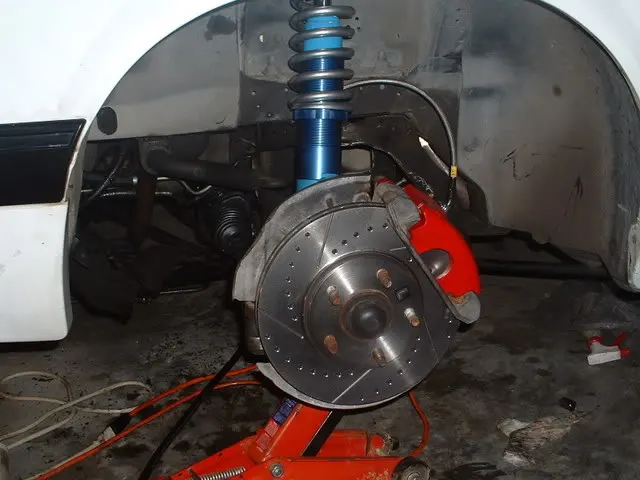

Heres UPRs kit...The ride is very nice...Better than stock...
Kelly
