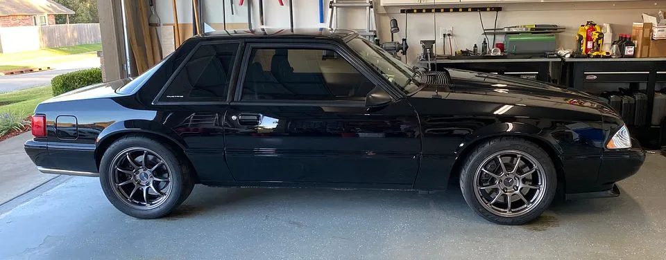

Griggs valved Koni DA’s with Maximun Motorsports coil overs front and rear:

I will say that the best ride my Coupe ever had was on the H&R Super Sport springs and Tokico Illumina shocks all the way around. Had stock LCA's up front with rubber bushings, Maximum Motorsports LCA's and stock UCA's in the rear. Car was great on the street and handled very well. Coil overs I have now are far superior to what I had but I gave up some ride quality. When I went to a full Maximum Motorsport suspension all that went out the door. Car kills it in the corners and hooks like mad coming out of them but again the ride quality suffered compared to the stock stuff with good springs and dampers.

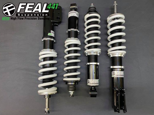

EDIT: Feals are another high-priced option. I've heard guys say good things about them but i have no experience with them
