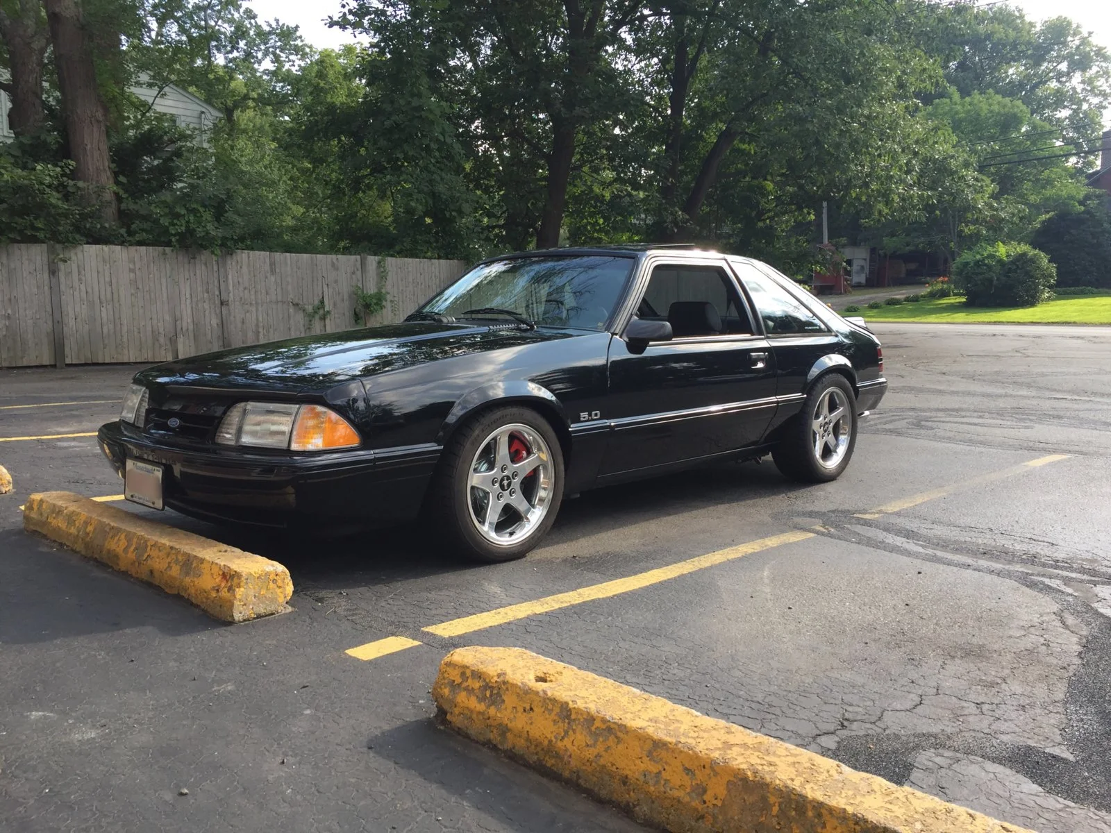

Haven't been to the track with my car , probably won't just a street cruiser but figured I'd post for reference.
Strange front coil overs w/12" 250 lb springs, Koni orange all 4 corners, BMR tubular front control arms,
Eibach pro-kit rear springs.
Rides and handles great on the street, much better than stock.

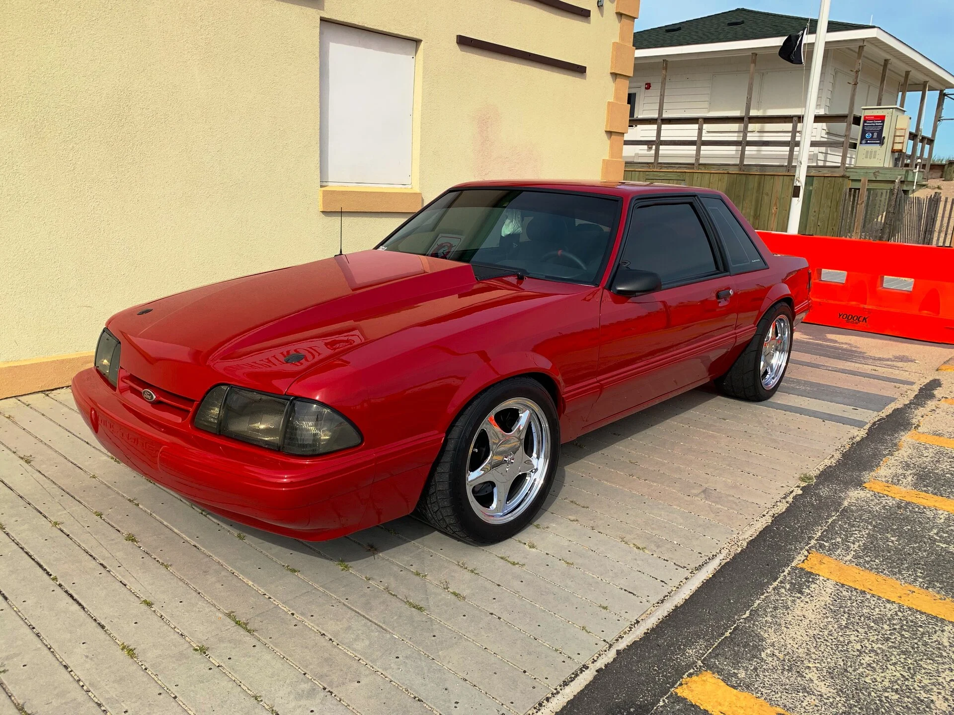

I don't drag my car, but I mostly street cruise with it. I have most of the MM catalog under the car and love the way it rides. Honestly, every time I get out on the rough roads here in MA with it, I swear i'll never ride in a standard coil spring setup again given how smoothly it takes bumps.
I have the ride height set to about middle of the range, just because I am street driving and need to deal with driveways and speed bumps and such. I've had it down low and it still rides great. MM stuff is great. Only negative about them is, of course, the cost.
I'm running 250# front springs, and Bilstiens all around.
