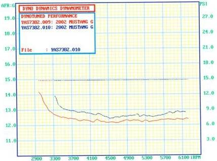

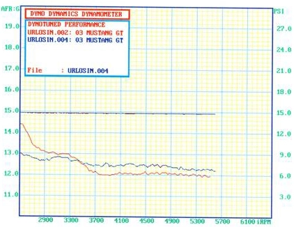

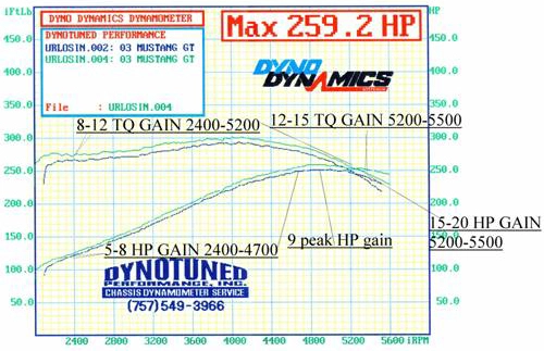

We dyno test all our kits and post the results on the forums and our web site for all to see. I never see a true back to back comparo from the other companies.
Remember, ALL dyno testing needs to be done the same day and on the same dyno. This is the ONLY true way to test any product. You can not compair a dyno from Feb. to a dyno done today. We've seen 5-10 hp difference in the same car with no changes only days apart.
Ask K&N for dyno info like this:
2003 GT
A/F results:
the A/F did lean, but to a more ideal zone! Very safe.

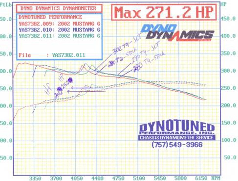

Here's another:
2002 GT Test was done same day and at the same time. JLT vs. MAC CAI
Gains of 10 RWHP and 10-12 RWTQ were seen on this test. These gains were made over the MAC intake!!
A/F results:
Again, only a slightly leaner A/F, but well in the safe zone.
More power and better MPG!
Your reading from several JLT owners here with near the same results either in MPH or HP. If no HP was seen in a dyno test I can only assume the test was not done the same day.
The dyno doesn't lie. Dyno stock then swap a part (keep temps the same) and dyno again. The difference is the gain or lose.
So when we hear people make blanket statements like CAI's on a 2V are worthless without any documented proof we challange that statement.:)
Thank all,
Jay:nice:

Then you can't really validate that the entire gain was from the intake either. Had you corrected the a/f ratio's then any gains would have been from improved flow and not from lean it out. And even though it is in an ideal range in this case, unless it was tuned to correct it to the commanded a/f ratio, it may cause problems for someone else for someone who may already be tuned to an ideal a/f ratio.
I think you make one of the nicest products I've seen but lets be fair on the results you posted.

I'm curious, what other modifications were done to these 2 dyno sheets shown above? I'm seeing 259rwhp and 271rwhp, neither of which are even close to a stock 2V GT's dyno results, which is what the majority of owners here have.
I'd like to see a dyno sheet from a totally stock 2v GT with the JLT stuff on it.
Perhaps if some of us saw a decent gain on a completely stock 2v, we'd change our minds that without supporting mods that actually make USE of more air, not just allow the POTENTIAL to use more air, we'd be more interested.
I personally look at a dyno sheet and say "Ok great, that's on a car with cams and heads. I don't have those. Does the 2-3rwhp it gains on MY car justify the $200 cost?"

1st car: This car was a 2003 GT in bone stock trim. Before and after tests were done back to back
2nd car: 2002 GT
Automatic Transmisson
Full Exhaust
Pulleys
MAC CAI and Chip
If we were getting 8-12 RWHP with a full point or better leaner A/F I'd feel the need to correct it, but we actually give the stock A/F a better slightly leaner A/F.
