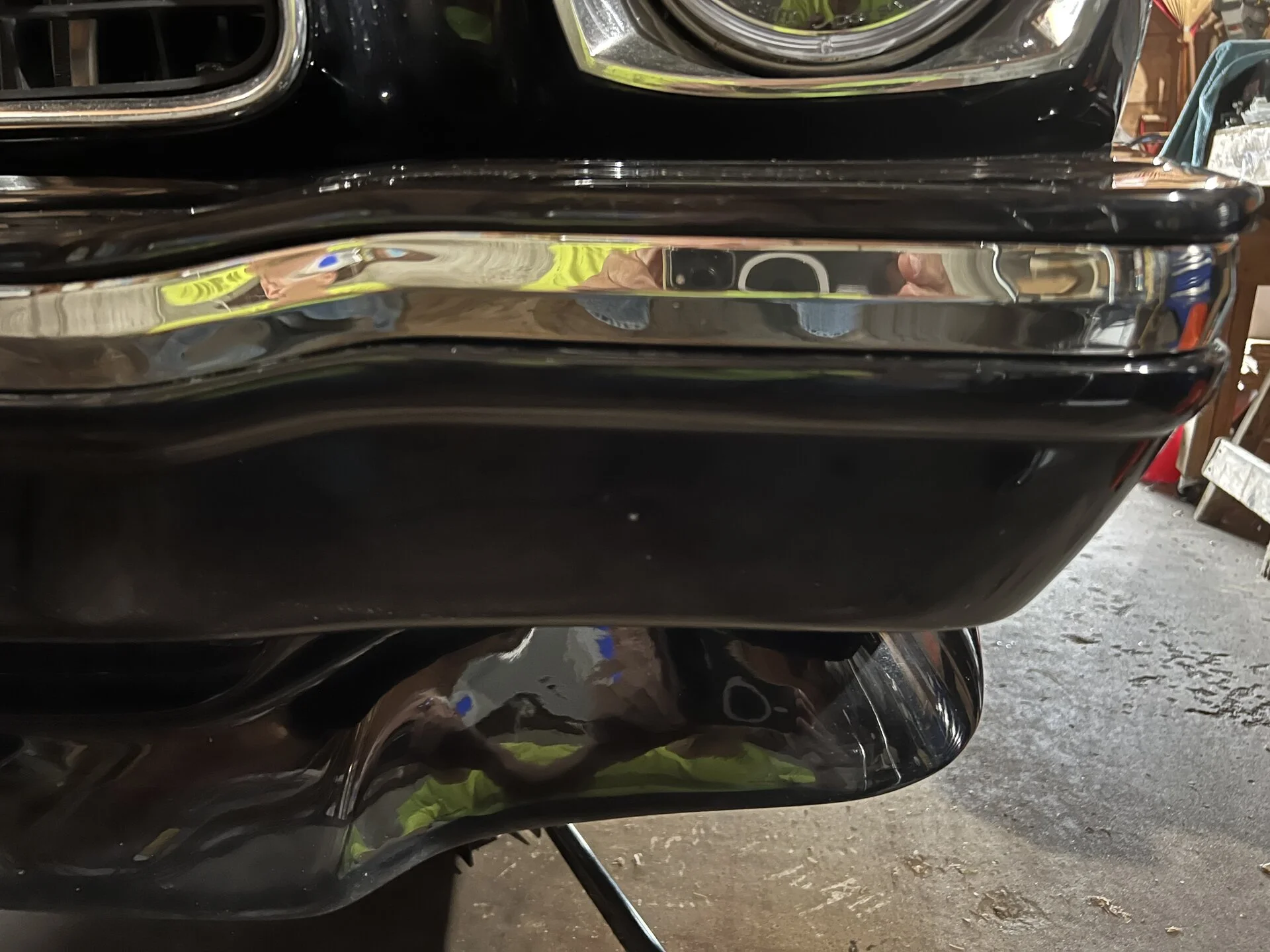

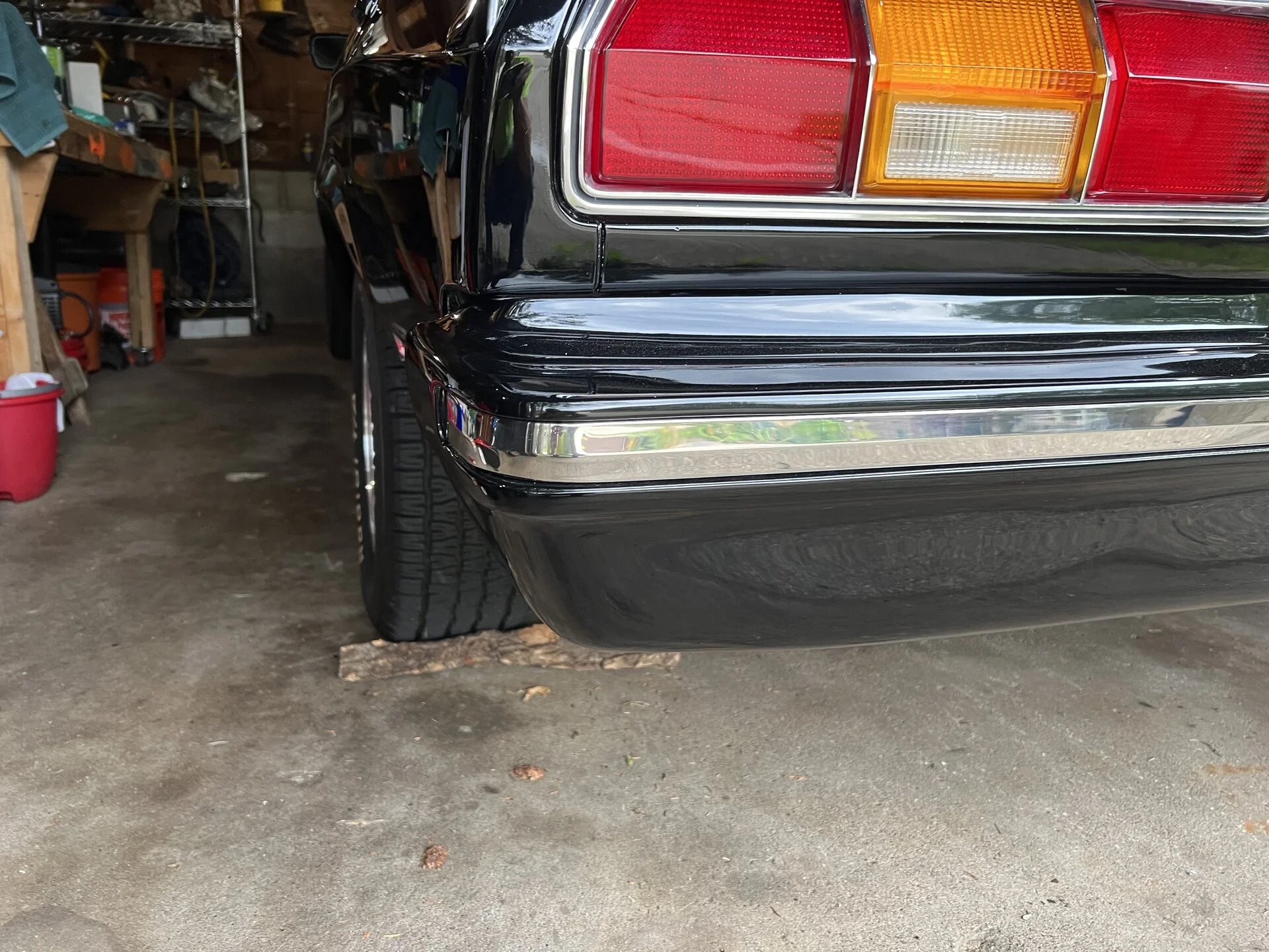

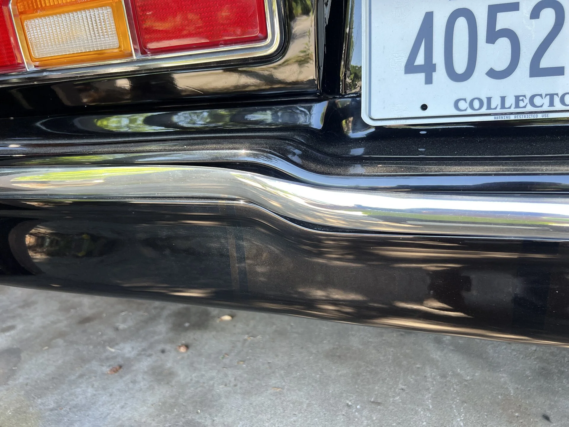

Had the bumper trim refurbished. They look awesome.
Before:
After:

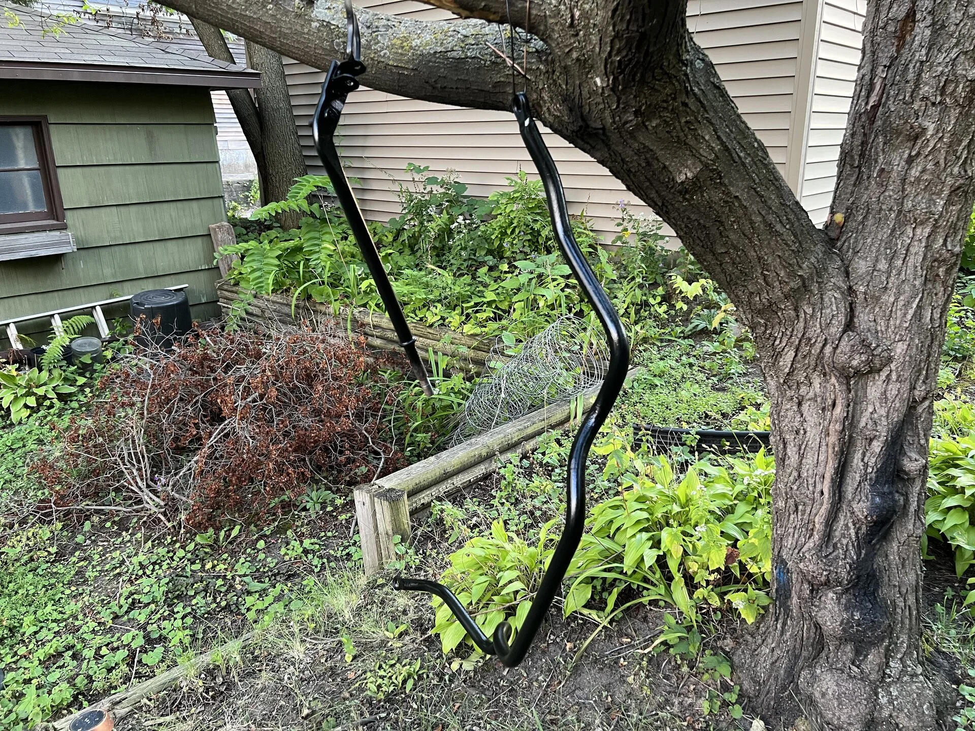

Taking a que from @LILCBRA I got my lazy ass out in the garage and pulled the stabilizer bar and the struts out today despite the heat.
Tomorrow if I can get the motivation I'll clean up the parts and paint them. Then get it all put back together over the weekend.
Reactions: LILCBRA
It was Hot and I found a shady spot on the deck and used a wire brush and course sandpaper strips and worked on the parts all day. Lots of water consumed. Now Lot Of Beer!
