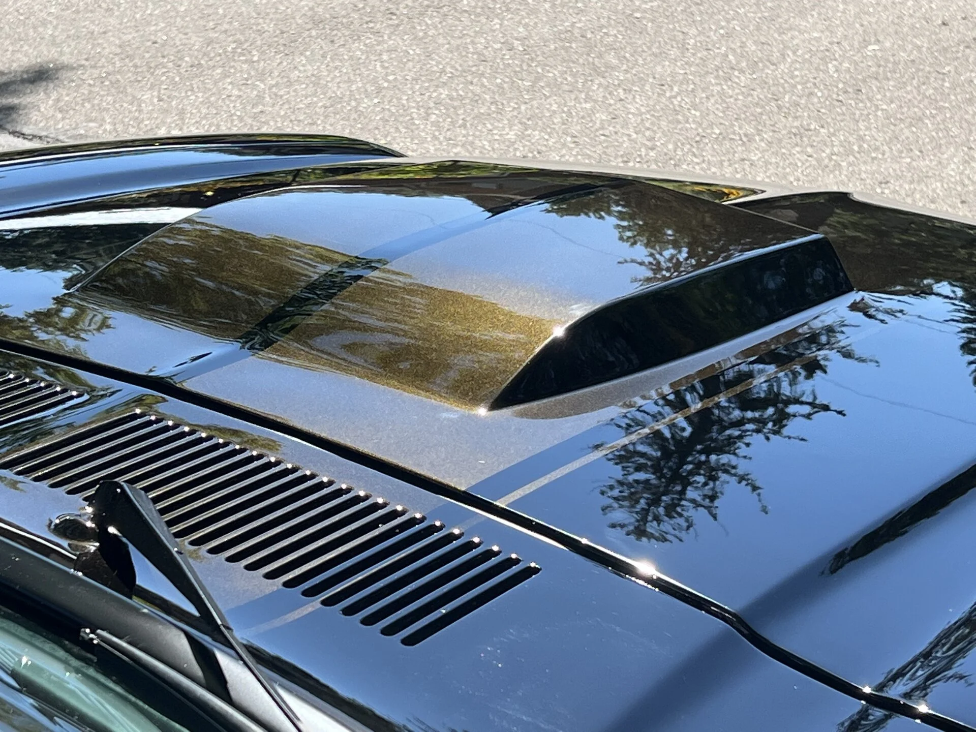

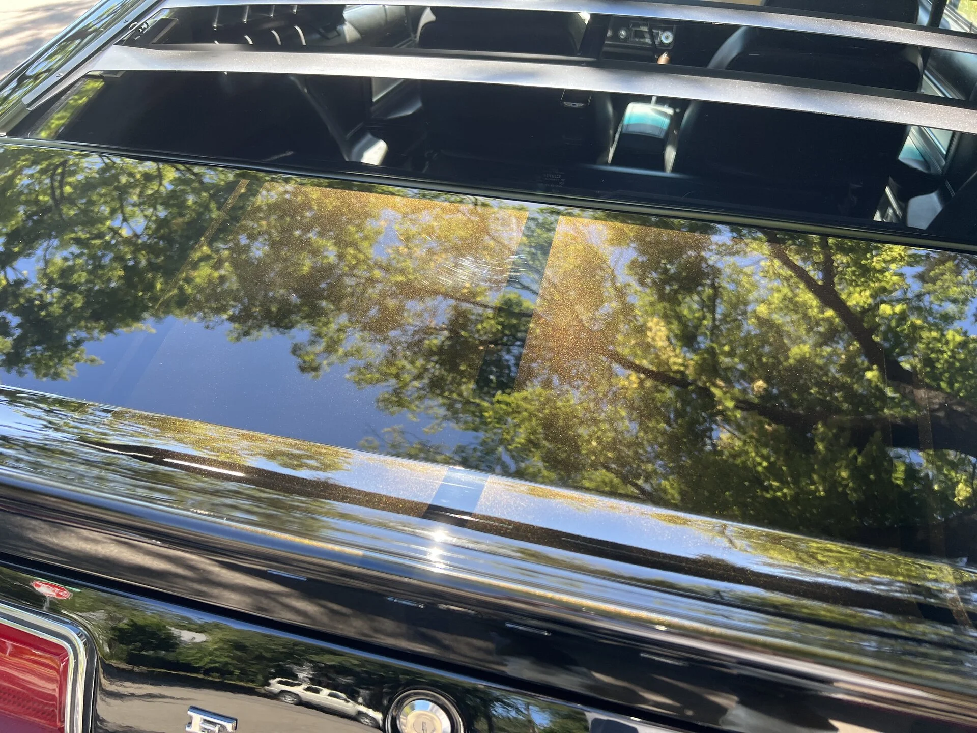

Beautiful day today so I took the Cobra II around the block and then washed and waxed it. @Potomus Pete I found some sun angles that show the graphics. IMG_3848.webp IMG_3850.webp
