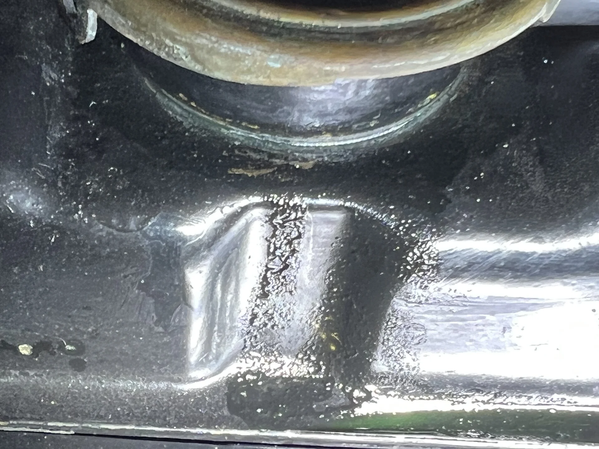

Spent the winter enjoying the 150+ inches of snow and 4' of ice on the Canadian border. Did a little visit to Florida. Went back to the border to help with the flood preparation. It didn't make much of a difference. Read all the posts on Stangnet I've missed out on lately and decided that it's time to get the Cobra II back out on the road. Even though it doesn't feel like it. 55 and a cold NW wind. But, you guys inspired me to get after it.
Pulled the cover off the car and opened the hood.
oh-oh

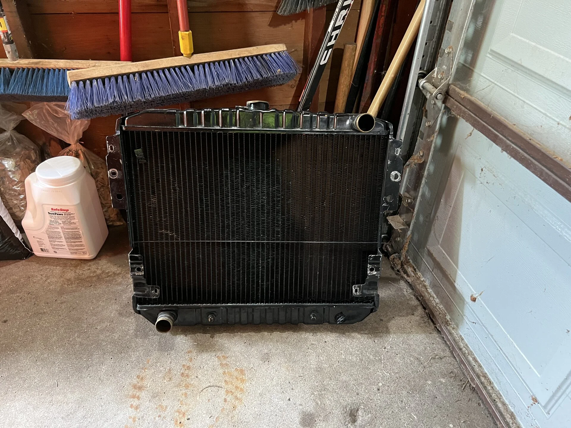

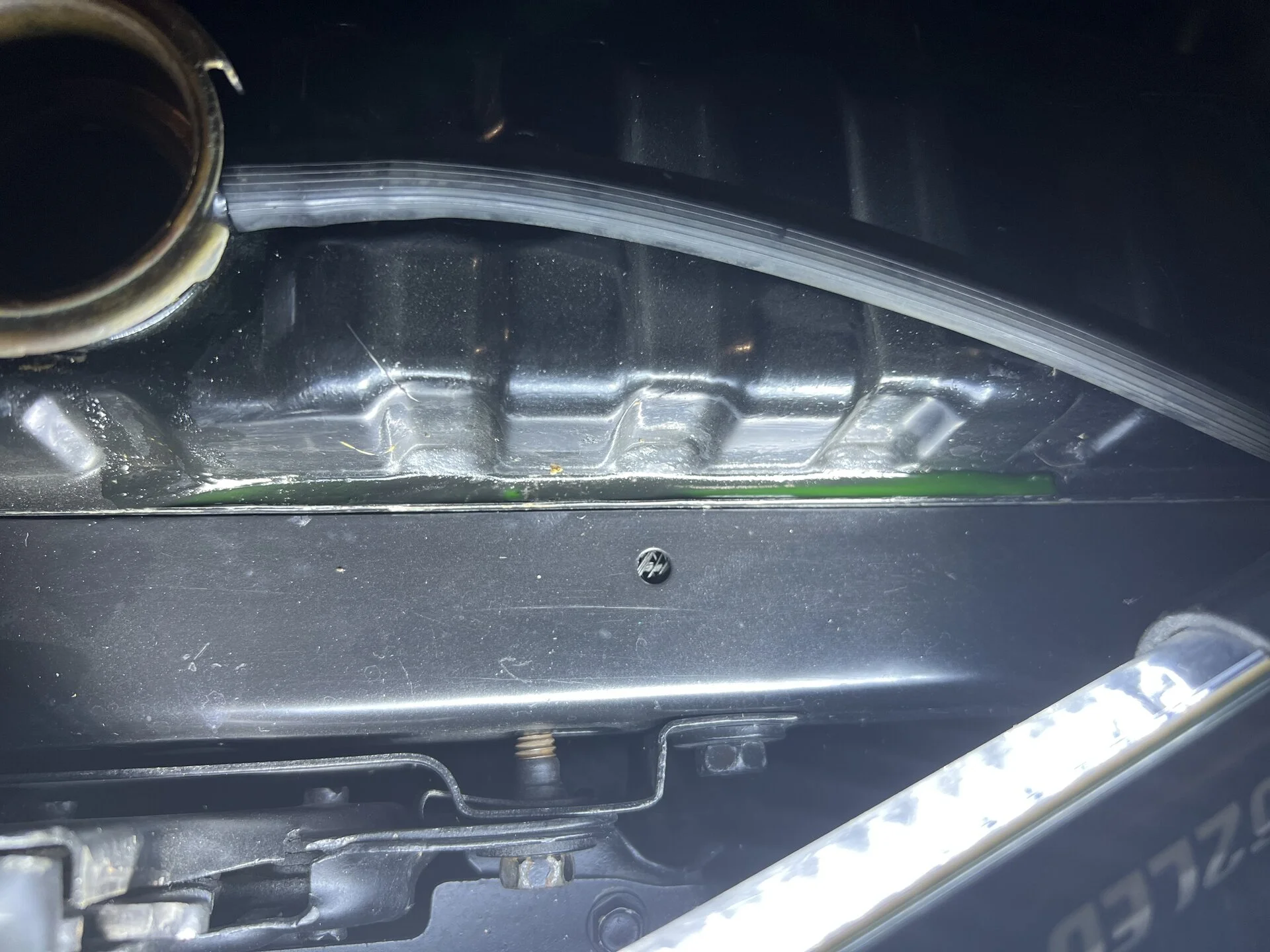

I guess I should have replaced the 30 year old radiator while the car was down last summer.
Ordered a new one. While I wait for it I can pull out the grill and go see if Phil has a replacement.
Radiator is draining..........
Ugg. That is not a welcome sight when waking them up. I am curious why it started leaking while stored though. From the pic I cannot tell if there is a crack or the paint bubbled where the antifreeze ran down. Usually high up like that indicates pressure in the system. I wonder if the antifreeze failed and allowed some expansion inside due to ice? I see green but I have worked with shop owners who used blue dye in their washer fluid water.....
If you suspect it may have frozen I would inspect the freeze out plugs. Do you have a hydrometer to test old antifreeze?
Reactions: Enzio
Good points. I think I have one of those coolant testers around. I'll check although I don't think it's a problem. I noticed last fall a small drop or so several times right near the radiator cap and thought it was the cap leaking. But it is a small crack where the neck was soldered to the tank.

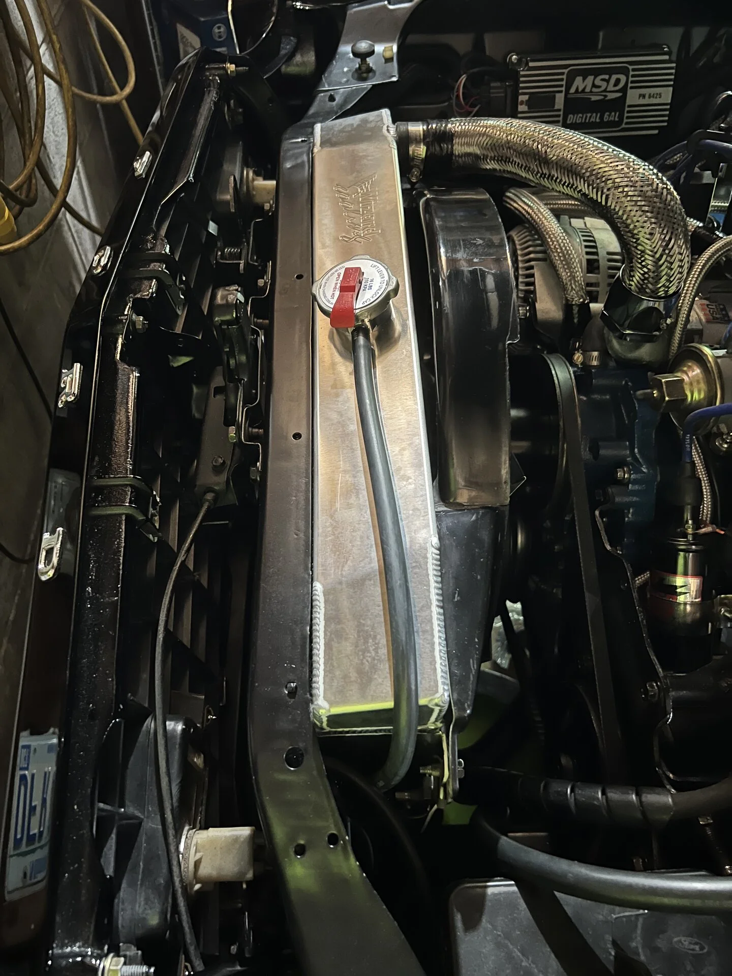

@IICrew didn't you put an aluminum radiator in last year? I think you said you used some rubber insulation where it bolted up? Can you let me know what you used? Thanks.
Reactions: IICrew and 2Blue2
T tops is running a factory radiator I had recored back in 87. The mach I has the new Champion brand aluminum radiator. It was under $300 when I bought it last year. It bolted right up using factory mounts. I have not driven it more then a couple miles at a time as my side business folded during covid and it still needs exhaust and tires. That said it fits great and held water so far.
Reactions: 2Blue2
Did you use some rubber insulators to help with vibration?

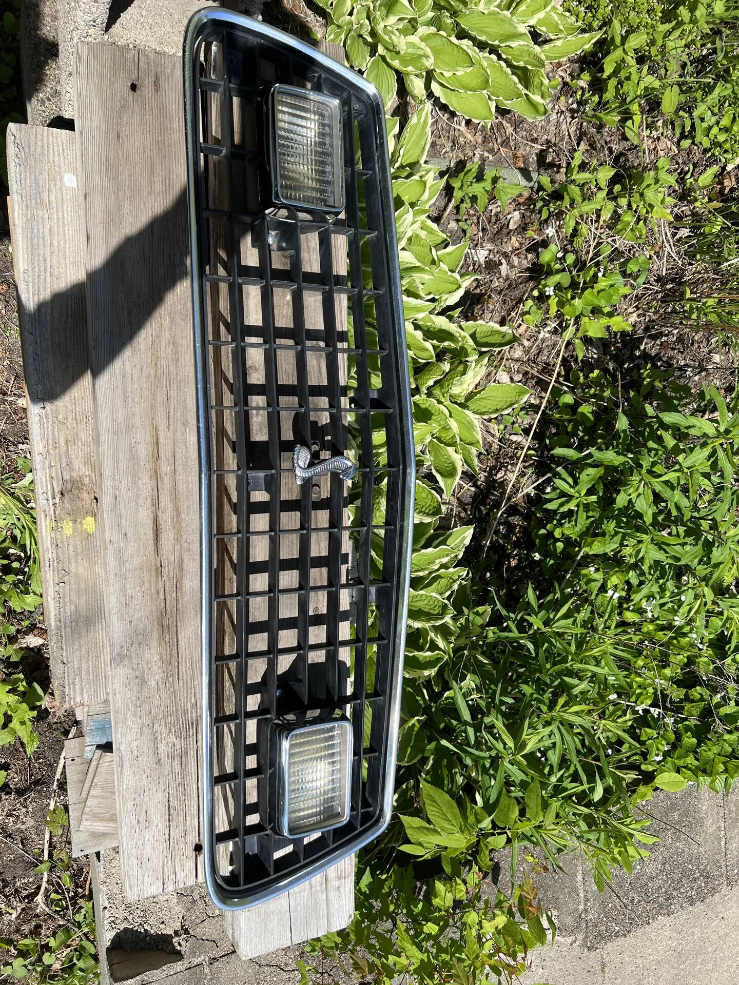

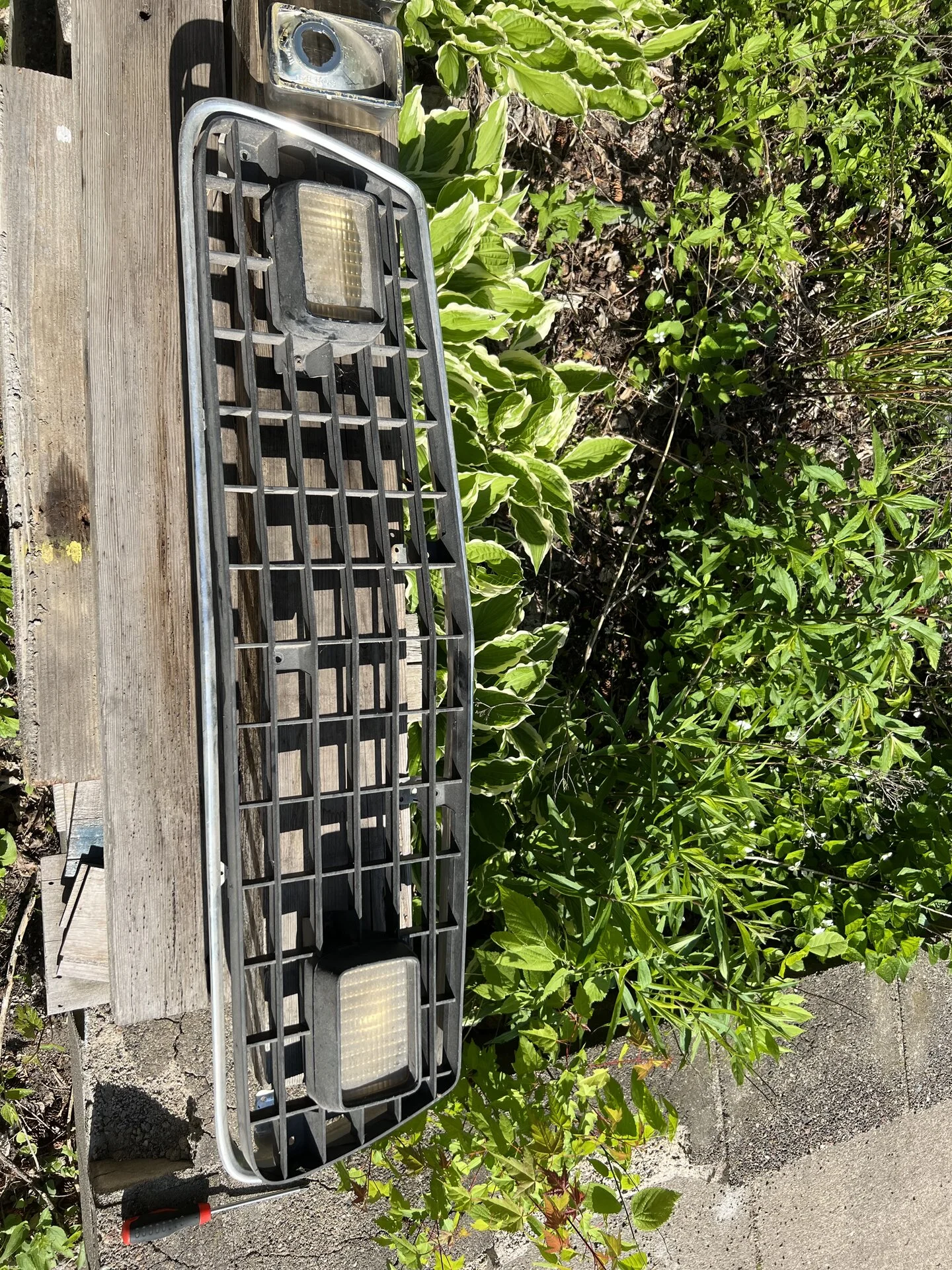

I have been thinking about grills the past week or two. And here you guys go and add fuel to the fire.
I keep going back and forth and cannot decide which I like better. I think it depends on the look your after.
The blacked out with orange t/s is menacing. But clashes with the chrome on your car. It has a cheap plastic aesthetic.
The after looks wider and gives it more of a classic car feel. Makes the front end look more in sync with the chrome. Seems less toy like.
I have the blacked out trim so the chrome is out for me but I want to get rid of the plastic looking grill. hmmmm
Reactions: Enzio
I traded in a 78 completely blacked out grill. The trim ring was originally gold. Would look good on a king. I didn't really like it because I had the original with the chrome turn signals...they are not compatible to the 78. On the blacked out one I traded the turn signal housings are molded into the grill where the chrome ones are separate.
