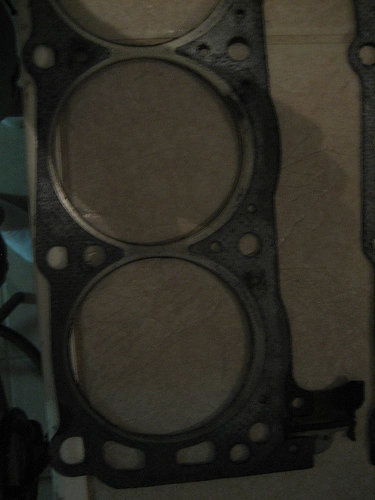

I didn't bother to check mine, I knew what it was for me. Losing a couple tenths when it was tuned more aggressively is never a good sign. You can see where the compression ring is burned right to the coolant port. :)

EDIT 1: Rest of the pictures from that day at the strip and the teardown here: http://www.flickr.com/photos/wesratcliff/sets/72157603360816671/

Got some closeups of the gaskets?
I would bet money that it detonated looking at the top of the cylinder sealing surfaces on #2, #7 and #8.
How does the top of #2 and #6 look at about 1 o'clock to the water port? Hard to see in the pic but looks like it may have a nice little path to the port.
See what Jim says, but those are VERY similar to how my stock gaskets looked. I am pretty sure his were the same. I brought mine by a buddy at the local speedshop and it took him all of about 1 second to verify where it had lifted the head (the dark, burned areas on the gasket)

Get some pictures of the gaskets. I see some possible burn marks on 2-7-8 and take a look at that exaust valve in the last picture possible rust
