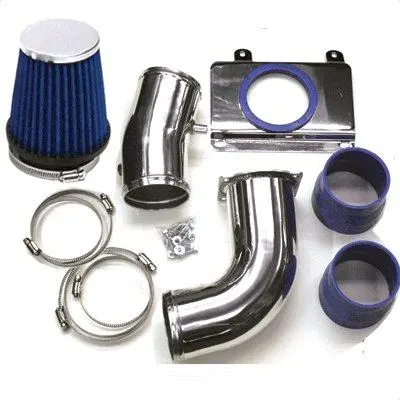

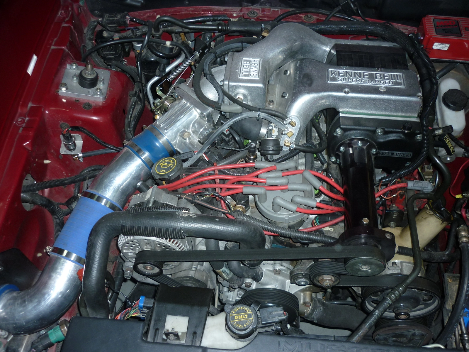

Here's what mine looks like after I modified the CAI kit which includes a plate to isolate the heat from the rad and engine. Pics of the kit pieces and what it looks like installed.

I've done it both ways k&n w silencer removed and I used American muscle's cold air. It came w that plate to block heat as well. Might be the same one that ole boy listed. I couldn't tell a difference between the two performance wise but w the cai the engine didn't look as stock.

Nice engine/bay! Please explain; how do you not loose HP/TQ with an open filter like that sucking in heated, turbulent air???
