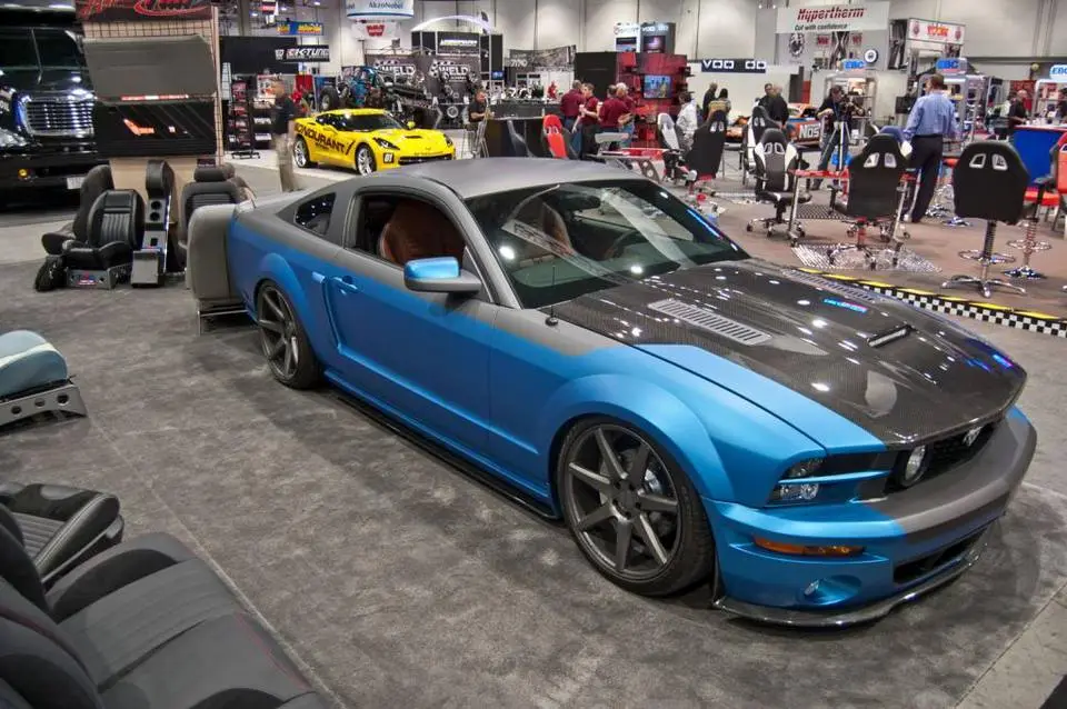

At a complete loss now and this car is set to be shot for 5.0 in a weeks time - at this rate the beast won't even make it to the shoot!!
Any ideas? Thanks guys.
Here's the car:
