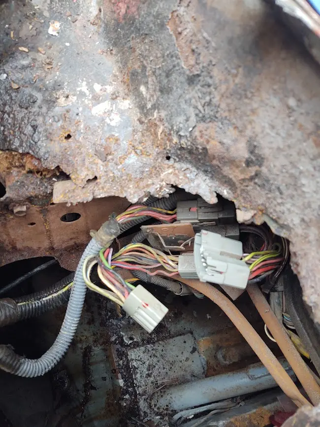

That area needs to be cleaned and sealed a good as you can get it. This is whats left of the driver side in my 82, after 35 years of outdoor
parking in coastal areas. I cut the top piece off, such that its repair weld joint would be covered by the fender, hood and trim. The round vent piece has been removed in this picture. It was also so far gone I had to make a new one. The patches got POR15 over epoxy. And it now lives under a car cover.
parking
Reactions: Dakar09
