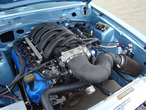

How would that compare to the 3V 4.6L? I've read it clocks in at 420 pounds fully dressed. That seems pretty light.
I'd imagine there would be a flood of 3V's available in the boneyards with all the 05-10 Mustangs and 04-10 F150's in the boneyards in the next few years.
Seems a nice chunk of weight off the nose and some good performance potential
From what I understand, the problem with running the 3V engine is making it work with the early ECU. One of the guys here dropped one into his '96 (billfisher I think) and had all kinds of trial and error going on getting it to work. Not 100% sure if he ever figured it out or not?
It would be a nice set up though. Almost all the flow and horsepower potential of the 4V, and better low end torque production than a 2V.
