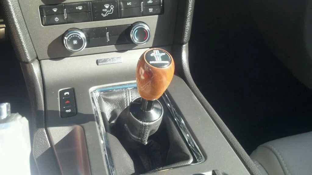

Thanx for the idea! Heres what I came up with for a custom wooden shift knob. I know the naysayers wont like it but I think it looks sharp with my light tan interior!

Nice. People should remember wooden shift knobs are just as authentically retro in a Mustang as the black resin ball shifters at least. I seem to recall some early Shelbys with Nardo wooden steering wheels and wooden shift knobs.
I'd like to see a profile shot of this.
Agreed. Wood would not look good with my black/silver interior, but is a great touch for a tan interior. Keep it up guys, nothing wrong with being the creative ones that some criticize.
