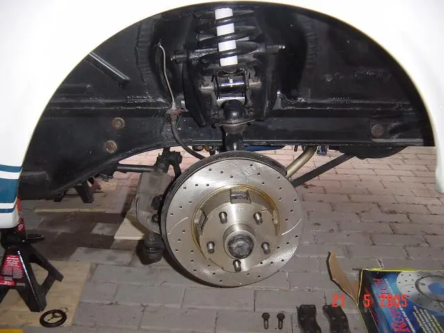

Thats cool i will be needing some rotors as soon as i source all the other parts for the conversion.You say you do early mustang rotors 65/70 are they Crossdrilled & Slotted Rotors also.Regards javed
Crossdrilled & Slotted....
Yes, they are all Crossdrilled & Slotted.
Available for 1965-2005
I have them on my 70 Mach1
Here's a pic of them on my buddies 65 (66?) Fastback
Mach1steve
