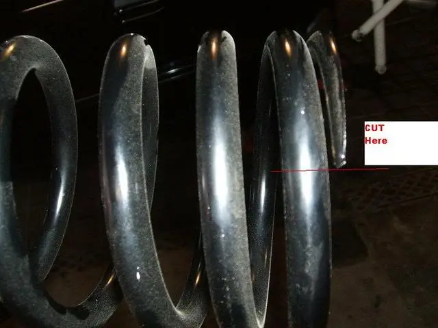

I have frpp "C" springs and the instructions say to cut them if not happy with desired ride height. My rear was way too high so I yanked them. I cut one full coil of and it gave me a 1 inch lower of a drop. Here is where I cut.

Note what Jrichker said about the ground ends. Notice how that picture shows the last coil is ground flush with the previous one so it makes a flat surface. Not only is this important in how the spring sits in the perch. But without a grounded end...you are effectively changes the number of active coils. I believe squared and ground end (stock)...the number of active coils is the number of total coils -2....one on either end.
So you just need to realize this WILL impact how the spring performs...and if they are the linear rate stock springs...it probably wont matter much...but just be aware of that fact!
