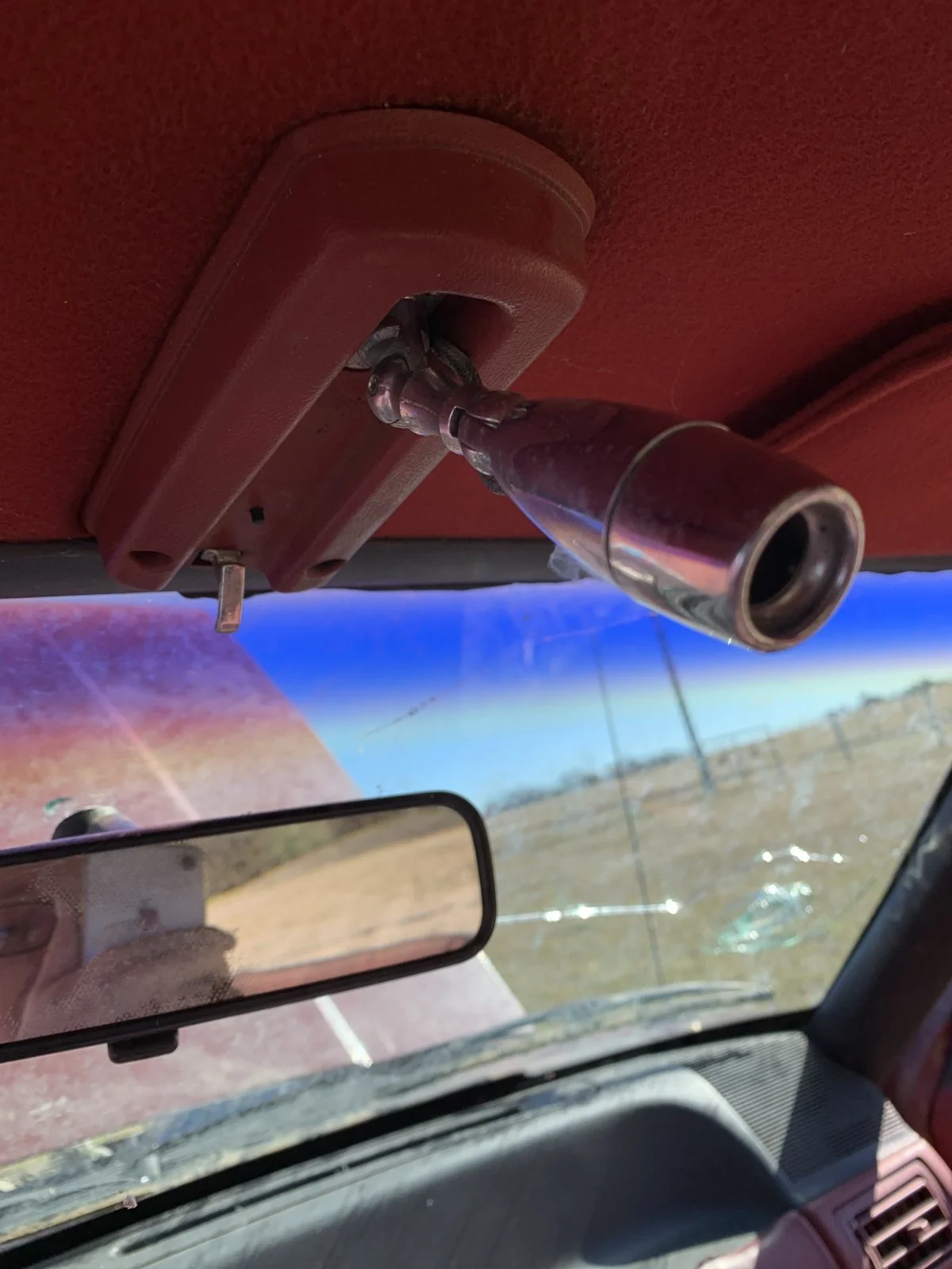

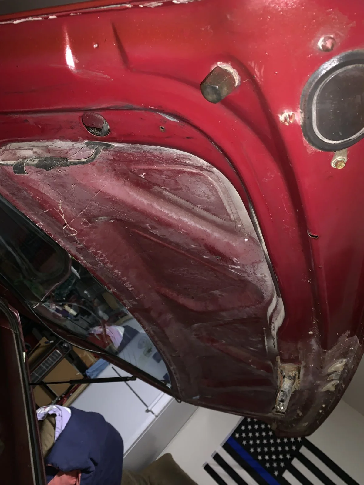

Quick question. What is this thing? Anyone know? There’s nothing installed on the other side of the roof, so I’m at a loss....
Missing the bulb. The contacts inside usually corrode as well causing them to not work.
Usually you can take them down and refurb them a bit, but probably not high on the list of tings to do right now

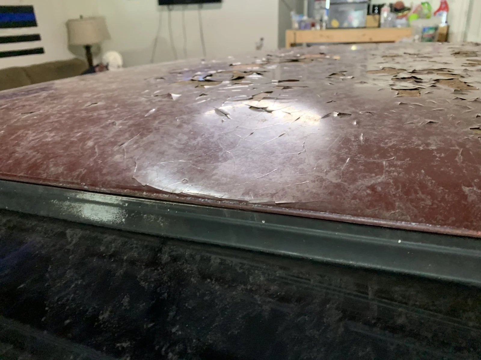

That sent doesn't look too bad. There is a reinforcment under that dent ( I believe ). Once you drop the headliner wer can give some advise on the fix. Davedacarpainter is the man...but a few of us do bodywork for a livin'. I'm a mechanic but know enough about bodywork to get myself in trouble.

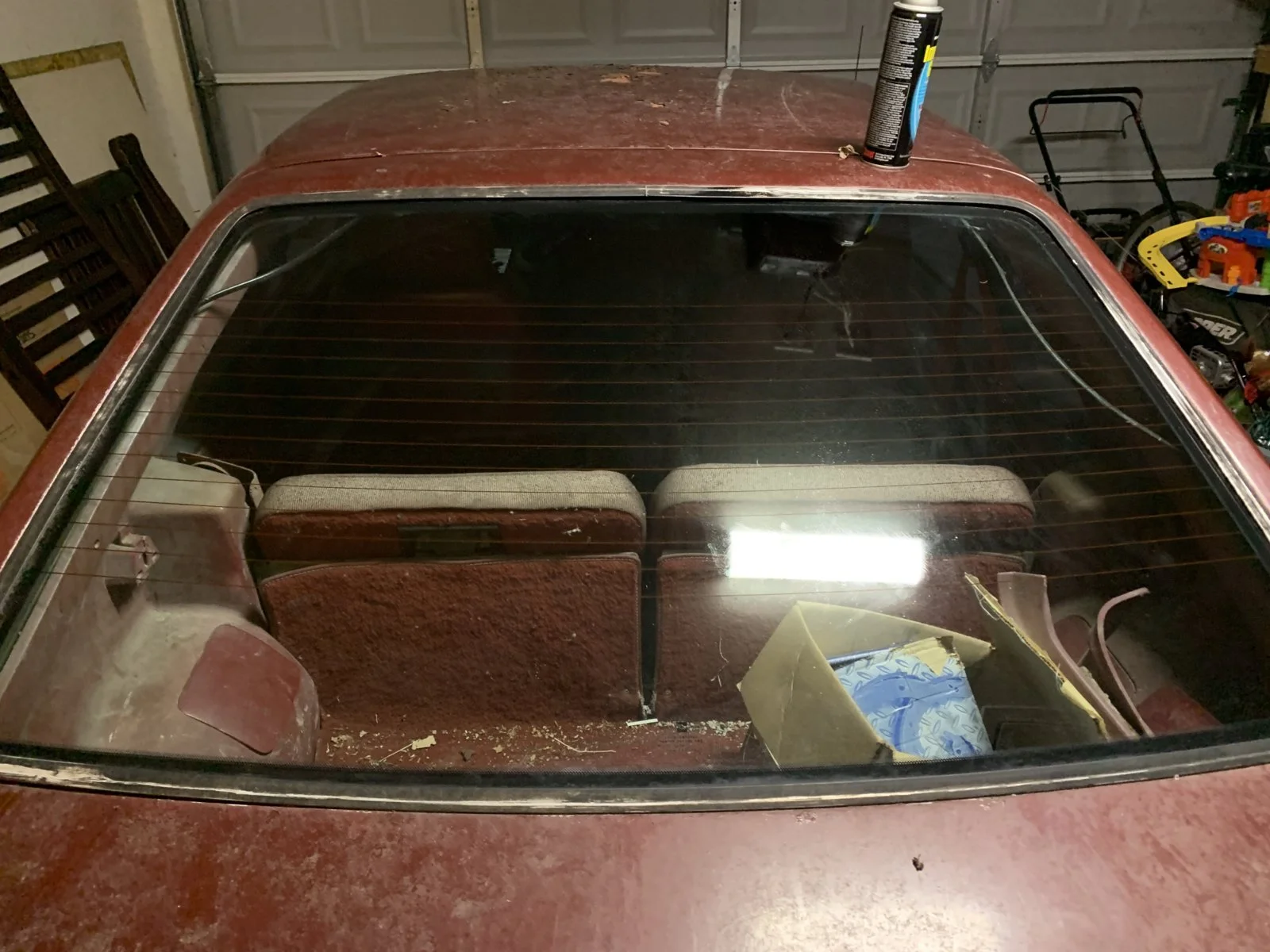

I'm noticing that the rubber around the window on the inside of the back glass is coming off. Is this hard to replace/fix? I've tried to find videos or posts about how to fix this but I"m not sure the keywords that I'm using are right.
Also, it looks like the strip along the defroster lines on the passenger side are coming off the glass.

You will probably have to have that hatch window removed and reinstalled by a professional.
Cleaning the car up really well is the perfect place to start. Then you can see what is in good physical condition, and what is coming apart.
Well, I have to have the front window replaced since someone cracked it in a nice little circle pattern. They can be done at the same time.

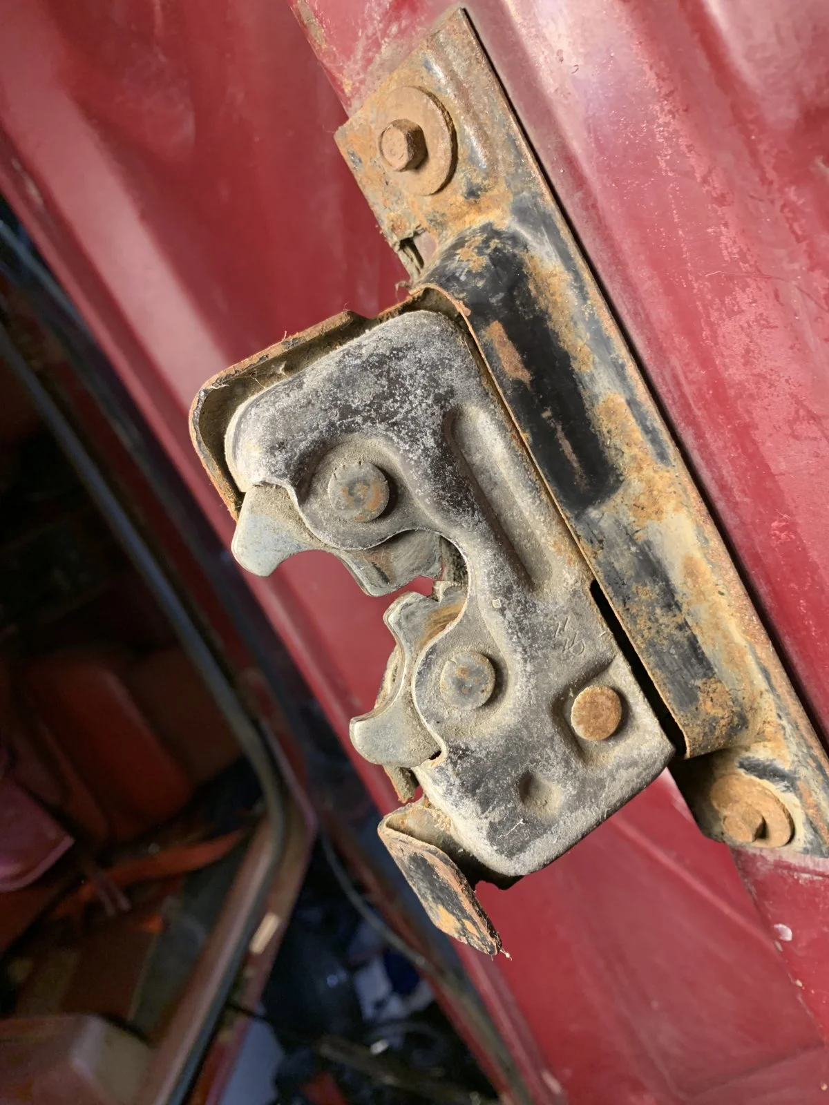

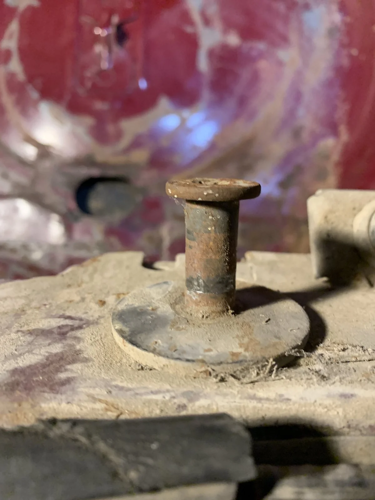

Does the latch on the hatch only work via power? The hatch will not latch, and therefore won’t close properly. I have a new battery but have not yet purchased the new battery cables. I also still need to get the injection harness, and I need to figure out what the other cables are that need to be patched. There’s at least two wires that need to be patched up in the corner by the passenger door.
The hatch will work with the door key, you may have to adjust the catch that the latch grabs on to, the catch should have a plastic bushing on the shaft, also make sure the latch works by pushing on it with a screwdriver.

I have to get a new set of door locks. If my dad had a key for the doors, we didn’t know about it. Also, the bushing is gone on the striker. The latch doesn’t move at all. I’ll post a photo or two when I get back home.
