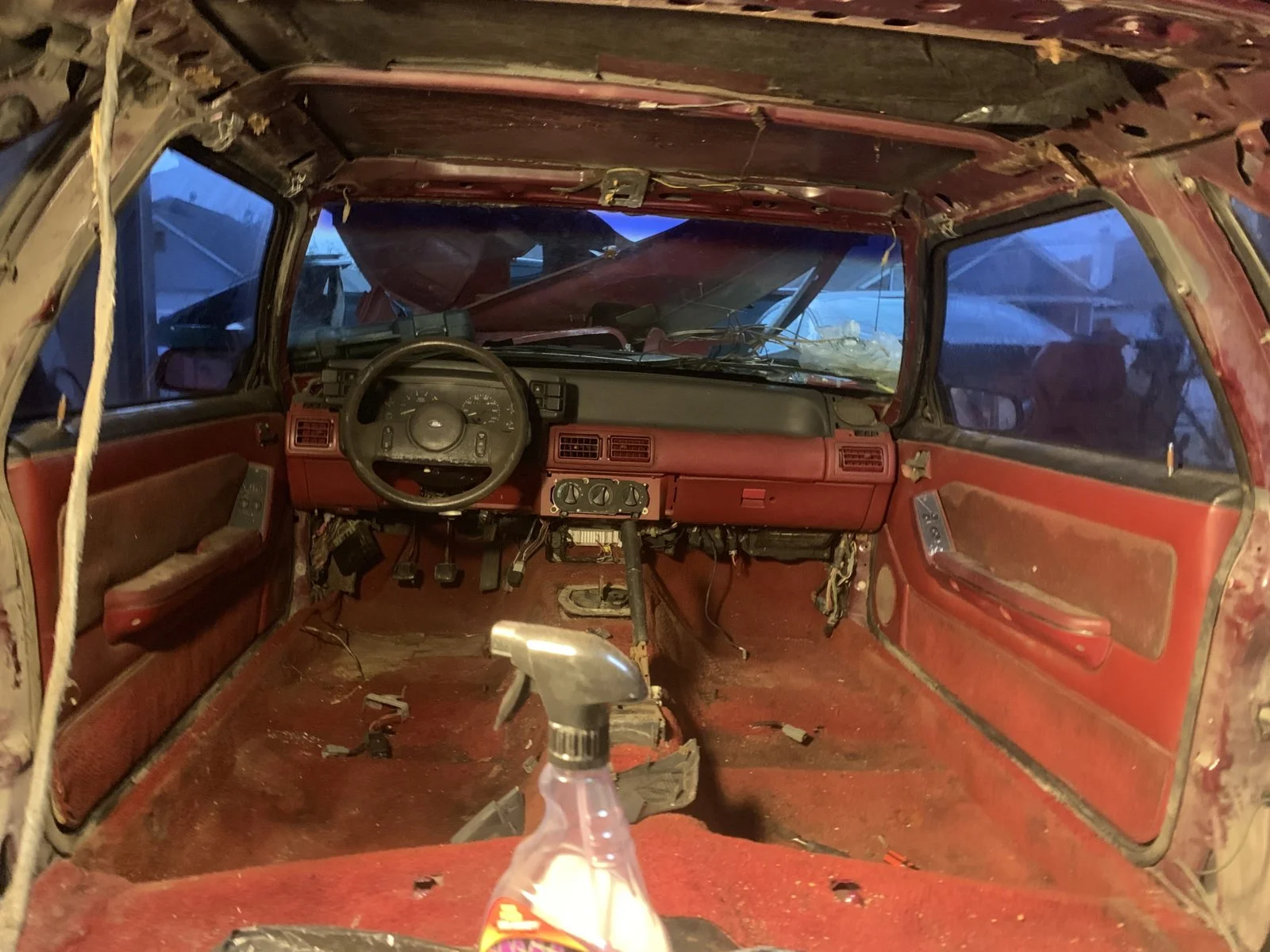

There is a bit of play in the roof. Should I be able to press down and it give some, or should it be firm?
its a crowned stressed piece of steel. It's more a matter of that than it having any support beneath it ( which only runs across the roof in the center). The fact that it's pressed or formed as a single piece gives it its strength.
And as a result it's rigidity..it really shouldnt move when you press on it unless your pushing on it really hard.

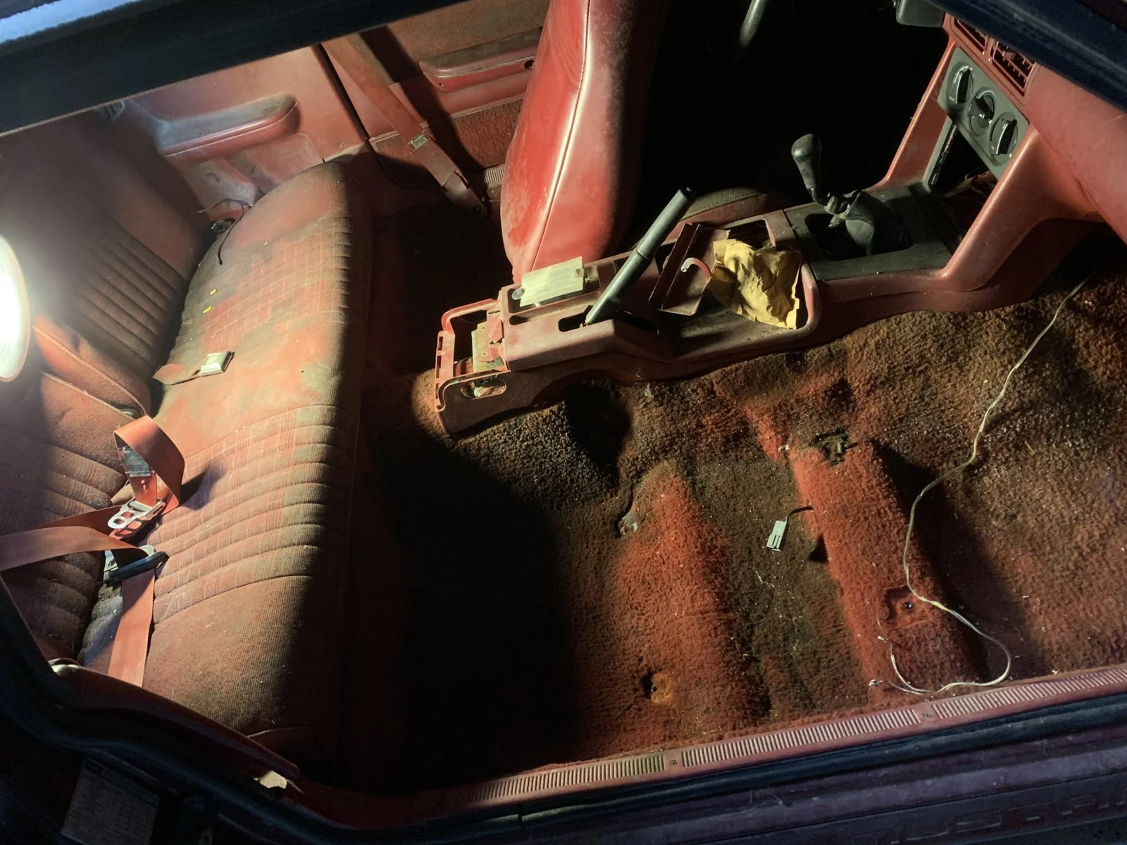

The more I remove stuff, the filthier it looks. (Photo below was after vacuuming the floor board). I have had to spray the rear bolts of the driver seat with some WD-40 As they are pretty rusted in. But I looked at the bottom of the car and I’m not seeing much rust under there, so that’s a good sign!
We are also having trouble getting that back seat out. No matter how hard we push at the bottom of the seat, it will not budge. Thinking maybe there’s a bit of rust under there keeping it from moving? Or is there a special trick we are missing?
Reactions: 90sickfox
For the 84-89 rear seats. Kneel down in front of the seat and basically punch the front edge towards the rear of the car while pulling up. There is a bar on the seat that needs to get past a hook on the floor pan. Sometimes the hooks get compressed down slightly and pinch the bar, so you just need ot muscle the seat back far enough to clear it. A good punch or even a kick rearwards can get it done.
Reactions: LizzieLou
The bottom of the seat bolts poke all the way through the floor pan. It helps to spray lubricant on the threads as well. ( if you havent already ).
The rear seat can be a bear. Like 5l5 said sometimes you've got to man handle it. Sometimes you can pull the front corner of the seat up and use a light to see the hook and wire. It's a difficult process. If the wire bends it can be straightened out but be mindful that its embedded in the foam padding. I've used long pry bars to get them loose...but I've been fighting these seats for years.
PS, that seat cover on the rear seat can easily be removed from the foam. Clip the hog rings and off it will come. Soak it in simple green and toss it in the washing machine and then let it dry. You can also hose down the foam. Let it dry well before putting it back together. Just need some hog rings and some hog ring pliers and it's a 10 min job. Very simple.
