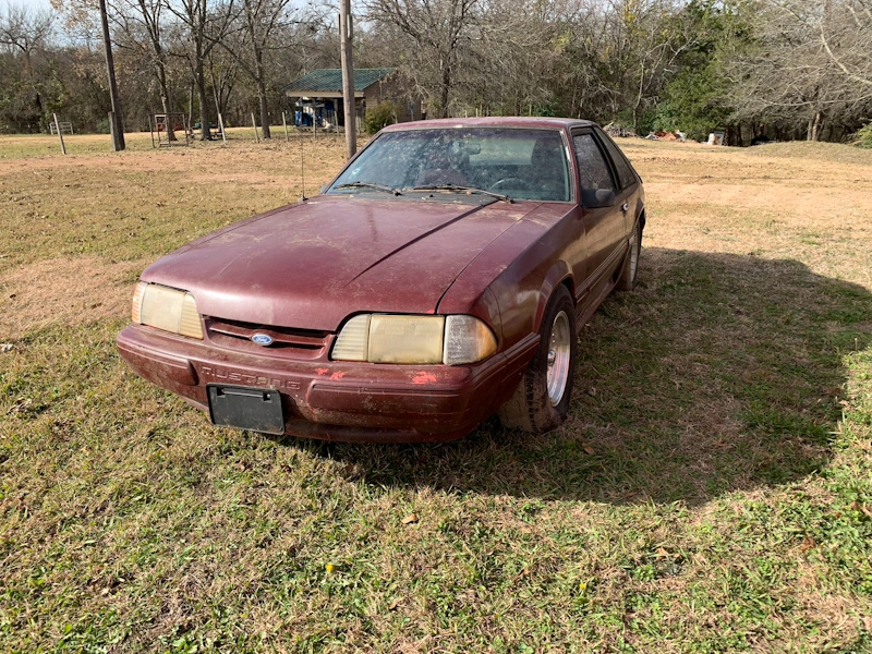

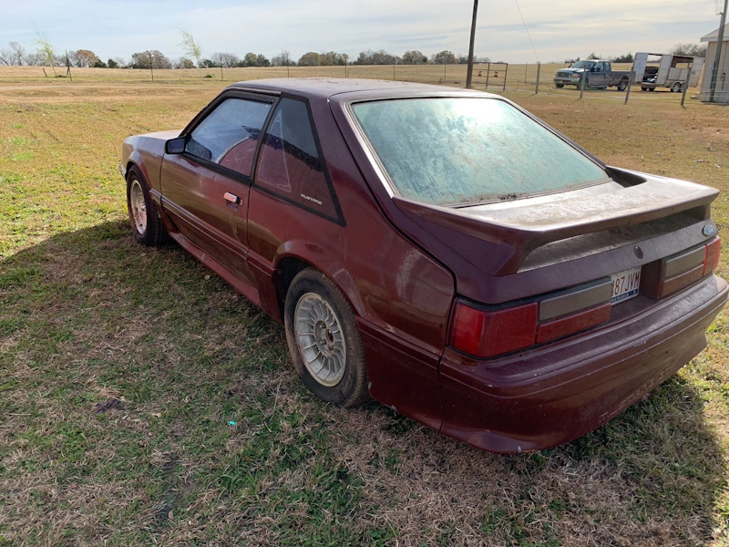

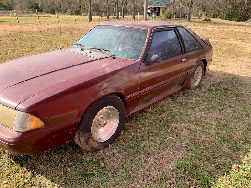

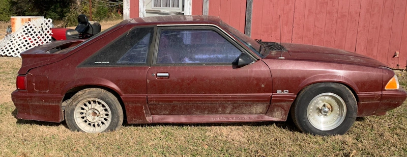

Hello! This is my first post here. I am a first time Mustang owner. This car was my dad's. He bought it as a project car. He started converting to 5-lug (completed the front end) and then found out his lung cancer had come back in his throat. He ordered most of the parts needed to finish off the back-end while bed-bound, but unfortunately passed away before he could do anything else with it. My brother didn't have time for it, so I asked him if I could have it. I know very little about working on cars, but I want to learn everything I can and do as much as I can. I'm a very fast learner, so I don't think i'll have many problems (Please forgive me if at any point my noob-ness comes out). This is a way I feel I can still be close to my dad, even though he's not around anymore. My husband and I will be diving into this project together.
This car has been sitting at my dad's old property for over 4 years (maybe over 5). My dad lived in BFE, so I'm sure at some points over that time some parts have come up missing (for instance, the battery is missing and 1 of the two battery cables [who in the heck steals one of two battery cables?!?], as well as the console arm rest assembly). I can guess that at some point this vehicle was in an accident, as the car is a GT but the front end is an LX. Either that, or a previous owner preferred the LX look to the GT look. The hood and front bumper are chipping away paint to a red color, while the rest of the car is not, so those are not original parts.
We had the car towed to my mom's property the Friday after Thanksgiving (we live about an hour and a half away, and the car was sunk in a few inches of dirt from sitting so long, rain, etc). We'll move it home within the next month. Our first planned project is to strip all of the fabric items out of the car, as some water has leaked into the failing weather stripping in the drivers side door. I also hate the red interior, so I'm hoping to change everything to black. After that and a good wash, I'm not sure where we'll go with it, except to finish the first project my dad started (5-lugs), painting, and some form of engine work. Any suggestions on what you would do if you were in my shoes is greatly appreciated!

I would suggest getting a good assembly/repair manual first. Then take inventory of what needs to be done body wise, rust, damaged areas and poor repair from previous owners.
looks like you may have a good project, keep us posted on this thread.
You have quite the project there. My very best suggestion after learning from my own car is to stick to one big project at a time. Dont jump around and lose focus, you will get over whelmed and discouraged. It is going to take a lot of time, and a lot of money, but can be done if your heart is in it and you have the dedication to give it. Keep us updated!
Reactions: Mstng93SSP
This is great advise, pick a project see it through and move on to the next.
Maybe start with the 5 lug swap and related suspension issues then on to the next.
A lot of smart people on this site (not me.. lol) so ask questions along the way.

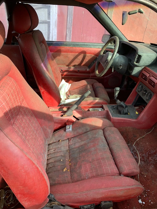

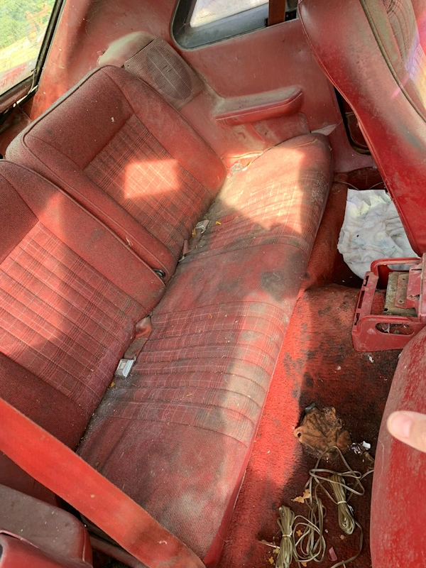

I also have exhaust pipes, mufflers (2), shifter boot set, fuel pump, and lug nuts for the wheels. The first thing we'd planned on doing is clean out the interior and trash the fabric.
Reactions: Mustang5L5

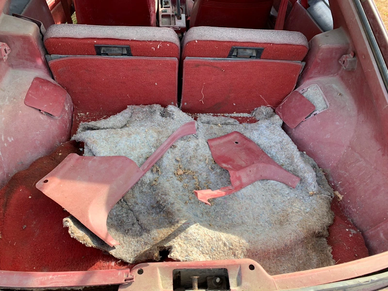

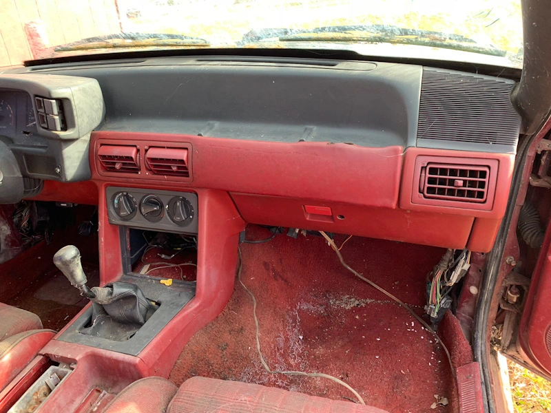

The interior looks awful dirty and moldy but you'd be surprised what a washing machine can do. I'd strip the seats ( pull the fabric off them ) and throw them in the washing machine. The foam would need to be washed by hand.
Either way, I'd strip them and keep the seat frames. You can buy new foam...and even new covers...but I have yet to see a new seat frame.

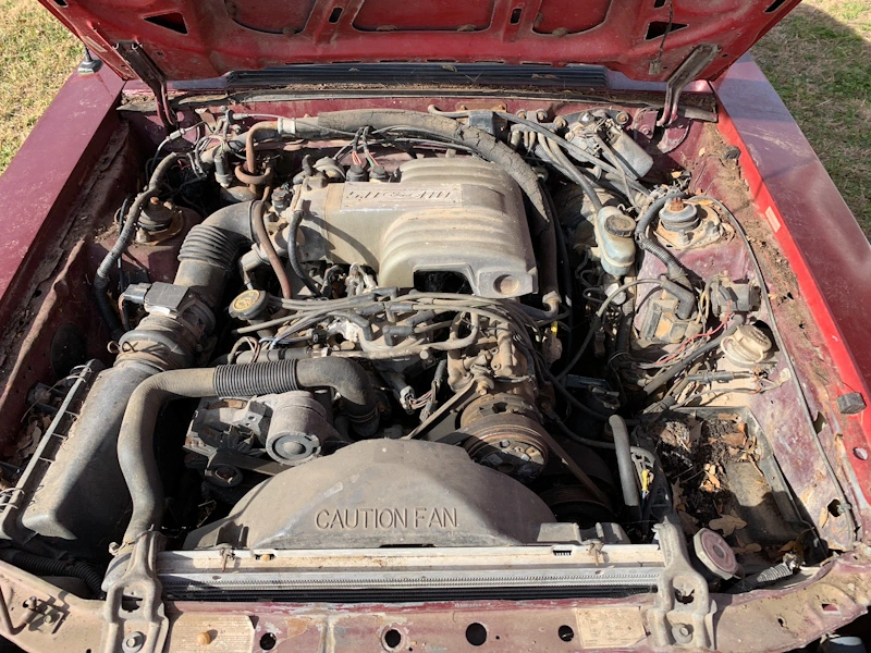

The first thing I'd do is list everything you have and what you need to buy. The very next thing I'd do is get the car running.... or atleast see if it will run.
Its alot easier to work on something that runs and drives on its own power. If the car runs now then if you strip it down and put it back together it should run again. I've seen alot of people tear a car down without ever starting it first. After the car is put together they chase their tails trying to figure out why it won't start. If you get it running you'll know what you have or what you need to do to get it starting and running better.

The interior my be a mess, but is fairly easy to clean up by just pulling everything out especially the carpet...pressure wash that thing and if you dont have one take it to a self-serve car wash to pressure wash it. I used a carpet cleaner attachment on my seats and used it on the carpet when it was cleaned. This made short work of the mess.

I'm feeling a bit positive about getting it started. I'll definitely try washing the seat covers and power washing the carpet, though I'm not holding out any hope for them being savable (I want a black interior anyway). The drivers seat is torn, though.

basically you drop and clean the fuel tank, new pump and filter, I would blow out the fuel lines just to be sure, change the oil, filter and fresh water in the radiator, check hoses for cracks including vacuum lines, no need for antifreeze until you are sure you have no leaks. Prime the engine by removing the distributor and turning the oil pump with a big drill until the gauge shows pressure for a minute or two.
