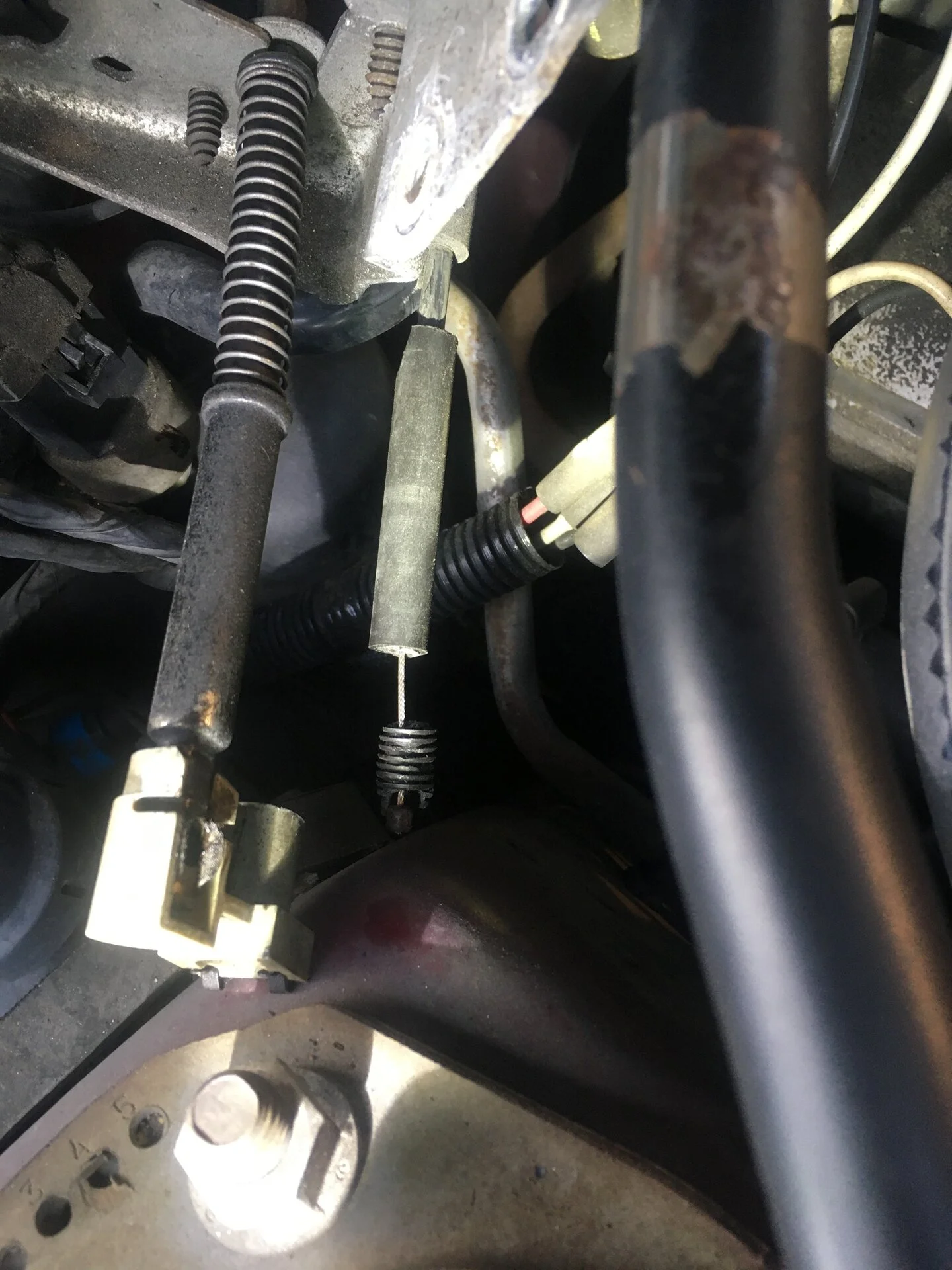

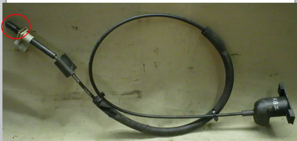

Thanks again. I’ll check the buttons. The ones I put on the Momo are not the ones that came with the car. They came with the bracket. I also am going to adjust the cable. I know that is messed up because it was causing the throttle to stick when I first got the car. It stopped on its own. Didn’t think anything of it till I read your other thread.
I shouldn't have said anything. The throttle stuck twice on my way to work today. Looks like I am going to have to address the cable sooner than later. One thing I did notices is that I do not have the black plastic end shown in your picture. I have not looked at it closely. but it is not poiking out of the clip. Might be under the throttle body since the clip was loose. I will have to look tonight when I get home.

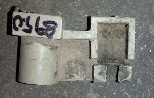

When I got home I took a look at the servo cable and my suspicions were correct. The plastic end is all broken up so it is not tied to the throttle clip. This is why the throttle cable was sticking. I am going to assume that you cannot just replace the end. You have to replace the whole cable?
this guy is selling just the clip. Unsure how easy it is to remove and replace but I imagine it’s possible. Looks like there is a few on eBay. I didn’t look through to see which is in the best condition.
Thanks, I think my clip is ok. Not sure how hard it will be to find a cable without buying the servo.

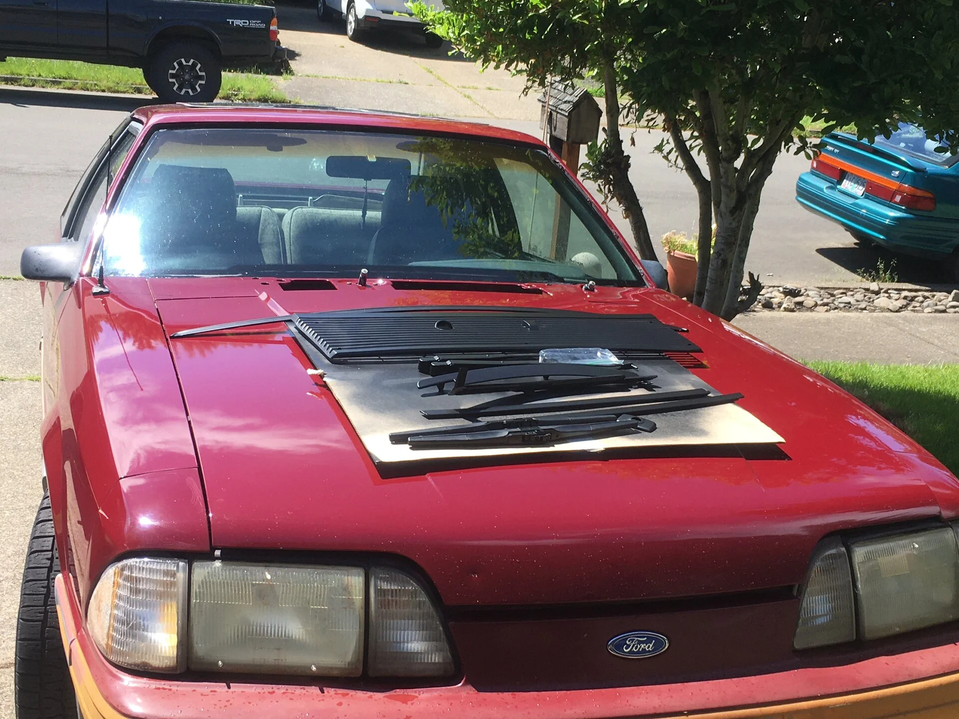

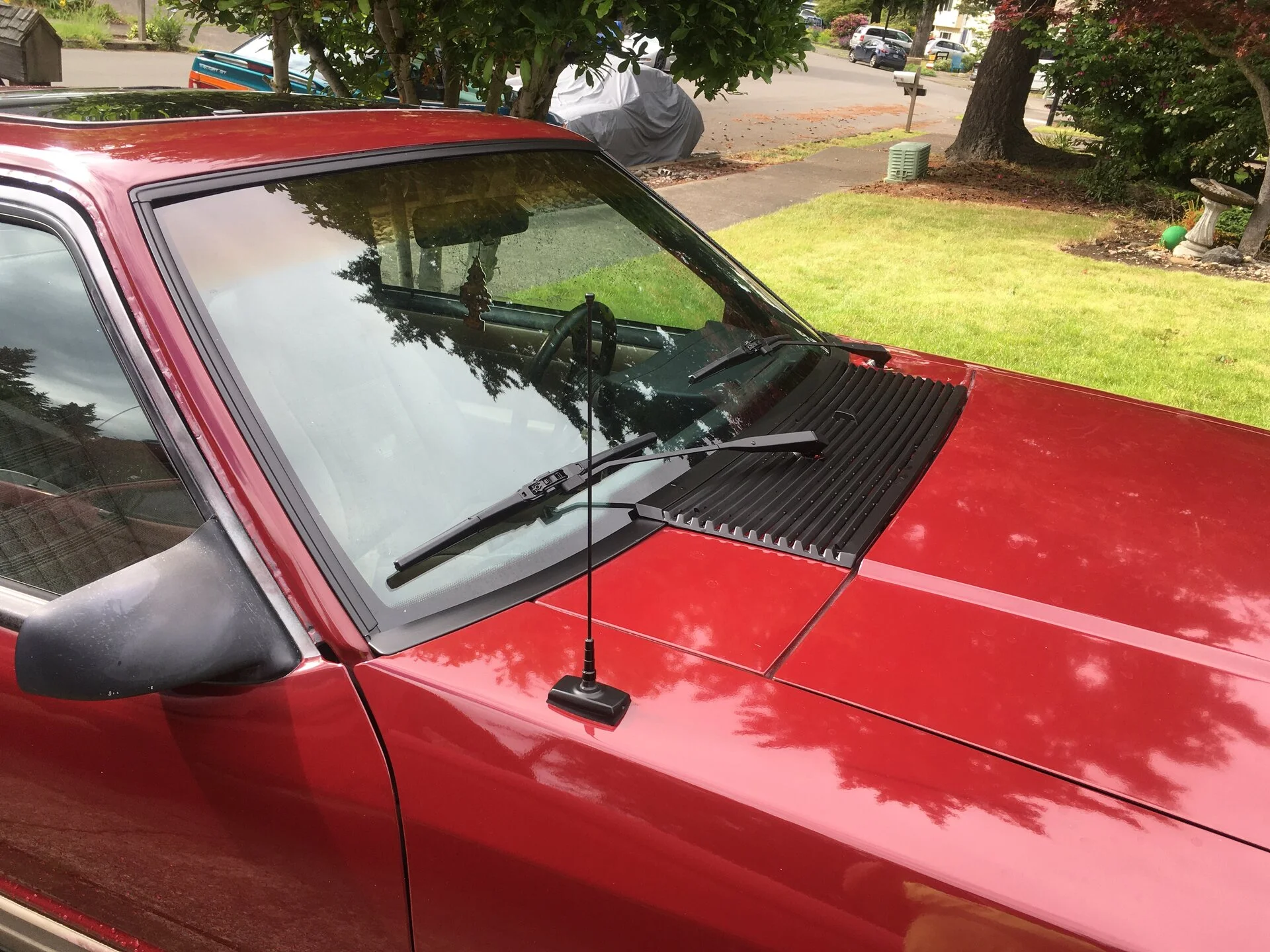

Restored the windshield trim, cowl cover, and wiper arms this weekend. Next I plan to do the hatch window moldings.

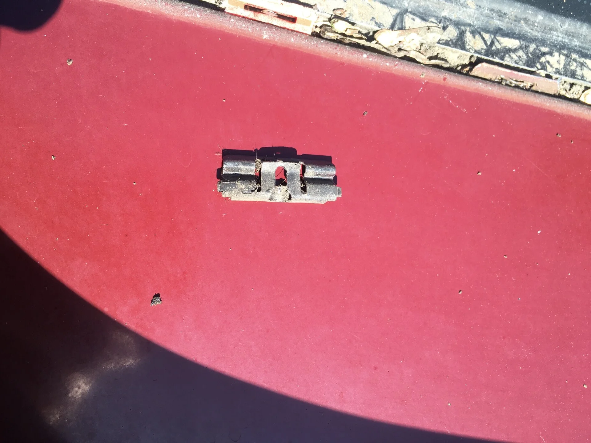

Tonight after I got home from work I took the window moldings off the hatch. What a pain. I don’t like those big clips. The front moldings are a piece of cake compared to the rears. Anyway… the moldings came off without damage but I am going to have to replace a few of the clips.
I was surprised too. The front clips are exactly like the ones from the 60’s and 70’s, same as on my 67 coupe. The hatch ones are about twice as long as the front ones and they are hard to release because the spot for the tool seems lower and smaller to me. I really had to angle the tool in there vs keeping it flat like one would normally do on the 60’s clip. And the and the extra urethane that squished out when the glass was put in didn’t help. Front moldings took me about 5 min to remove once the cowl cover was off. Rear moldings over an hour. I’ll post a picture of one of the clips before I head to work.

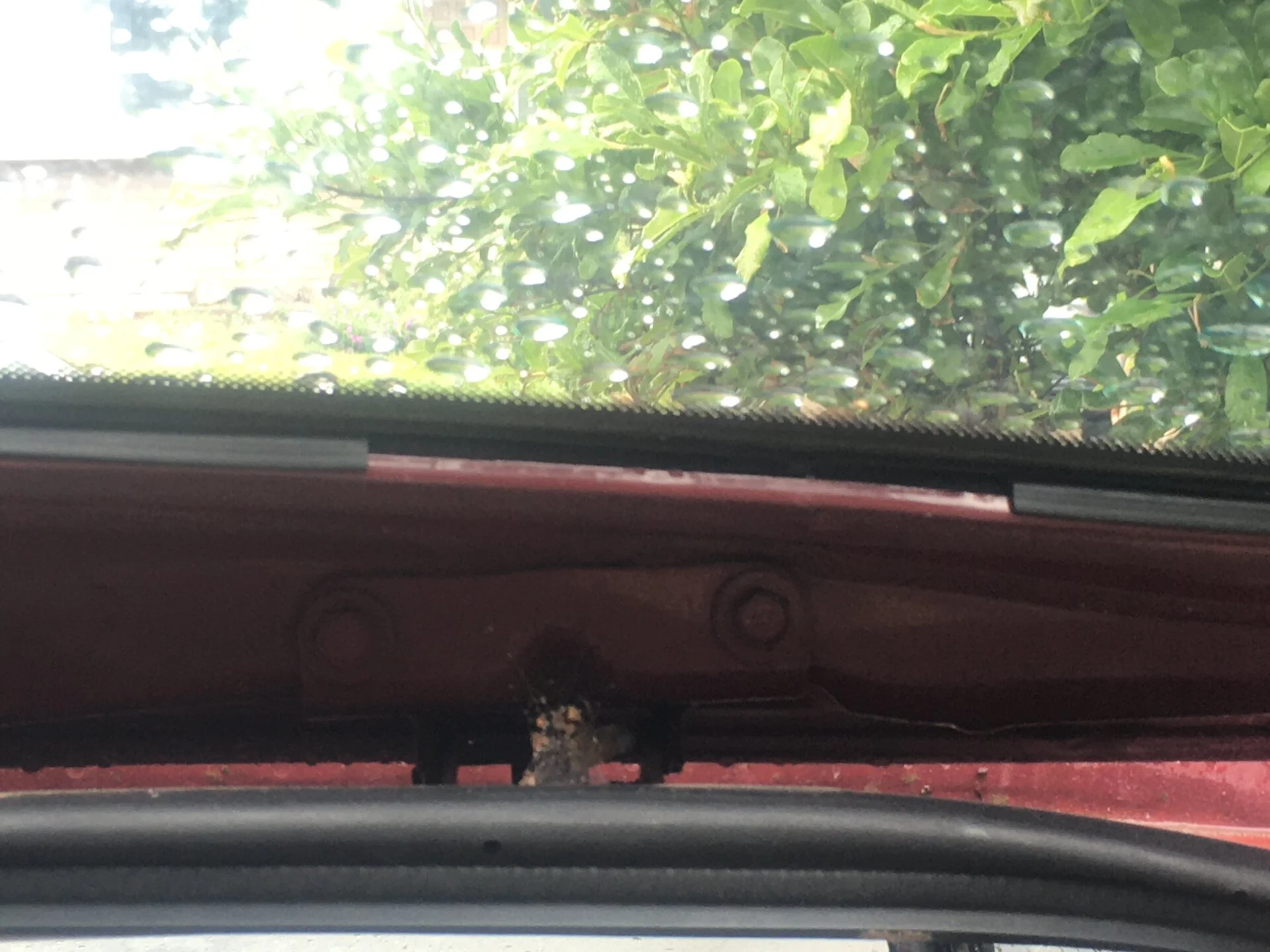

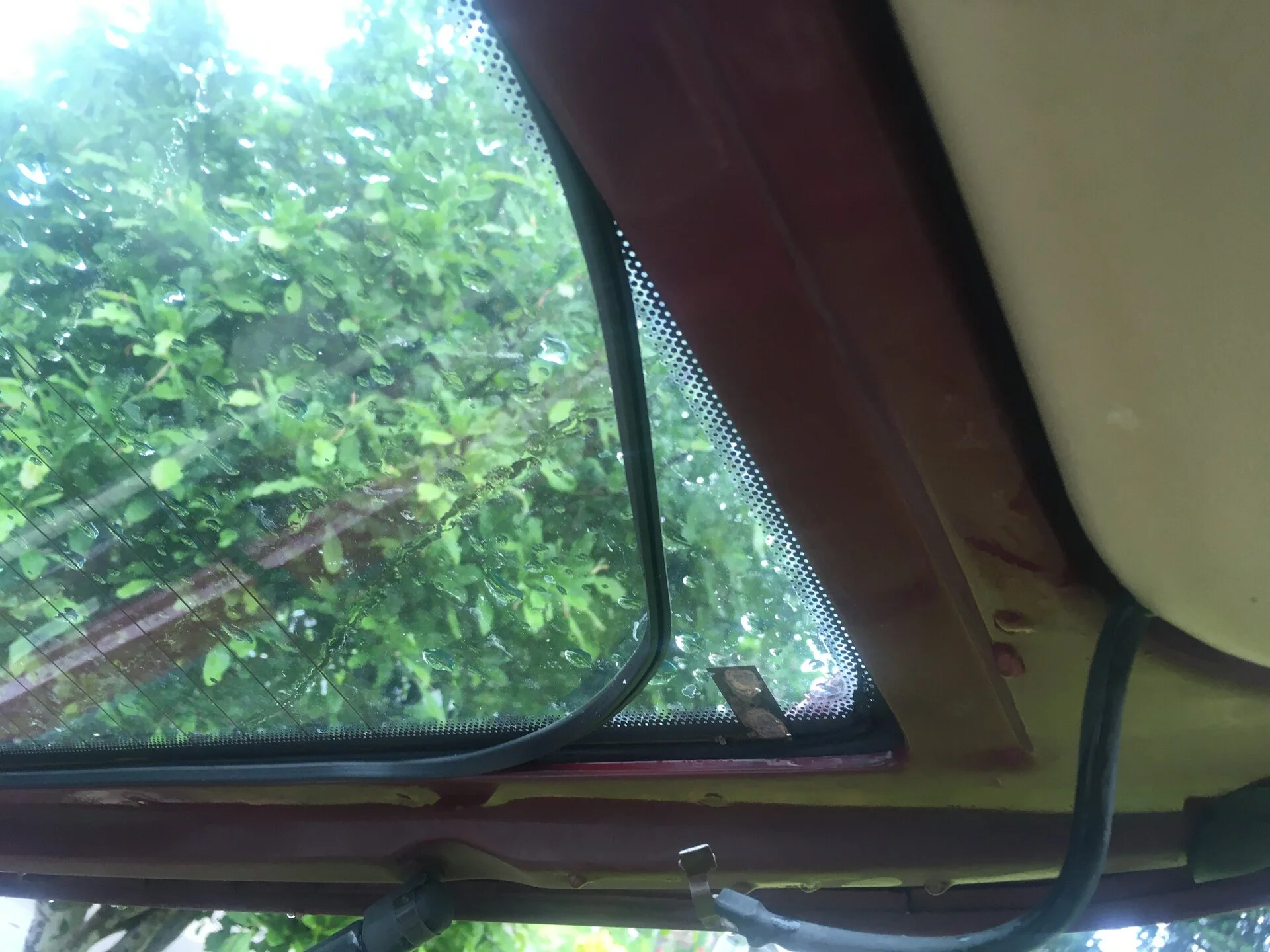

It’s been raining cats and dog the last couple days here in Oregon. I typically back the 89 in the driveway to match the convertible. The top on ragtop drains much better when it is facing down. Anyway….My drive way is at an angle so it was facing nose down. This morning I popped the hatch to put a window screen in and a whole bunch of water poured out from under the plastic hatch cover on the passenger side. This is the first time I have ever seen this. Unfortunately I was running late so I did not have the time to investigate. It was pouring all the way home so I didn’t do anything with it when I got home.
The only thing that has really changed has been the removal of the window moldings from the hatch. I still need to buff under the rear spoiler so I was thinking of taking it off and give the hatch and wing a good cleaning. I was going to do that later rather than sooner but being that there is a leak somewhere it might be a good idea to do it now. Is just the black Butyl tape stuff that seals everything up under the hatch?
I haven't got to the bottom of the water leak however it has seems to have stopped for the moment. I did refinished the rear window moldings last week. I also replaced all the clips. I have not put the moldings back on yet.

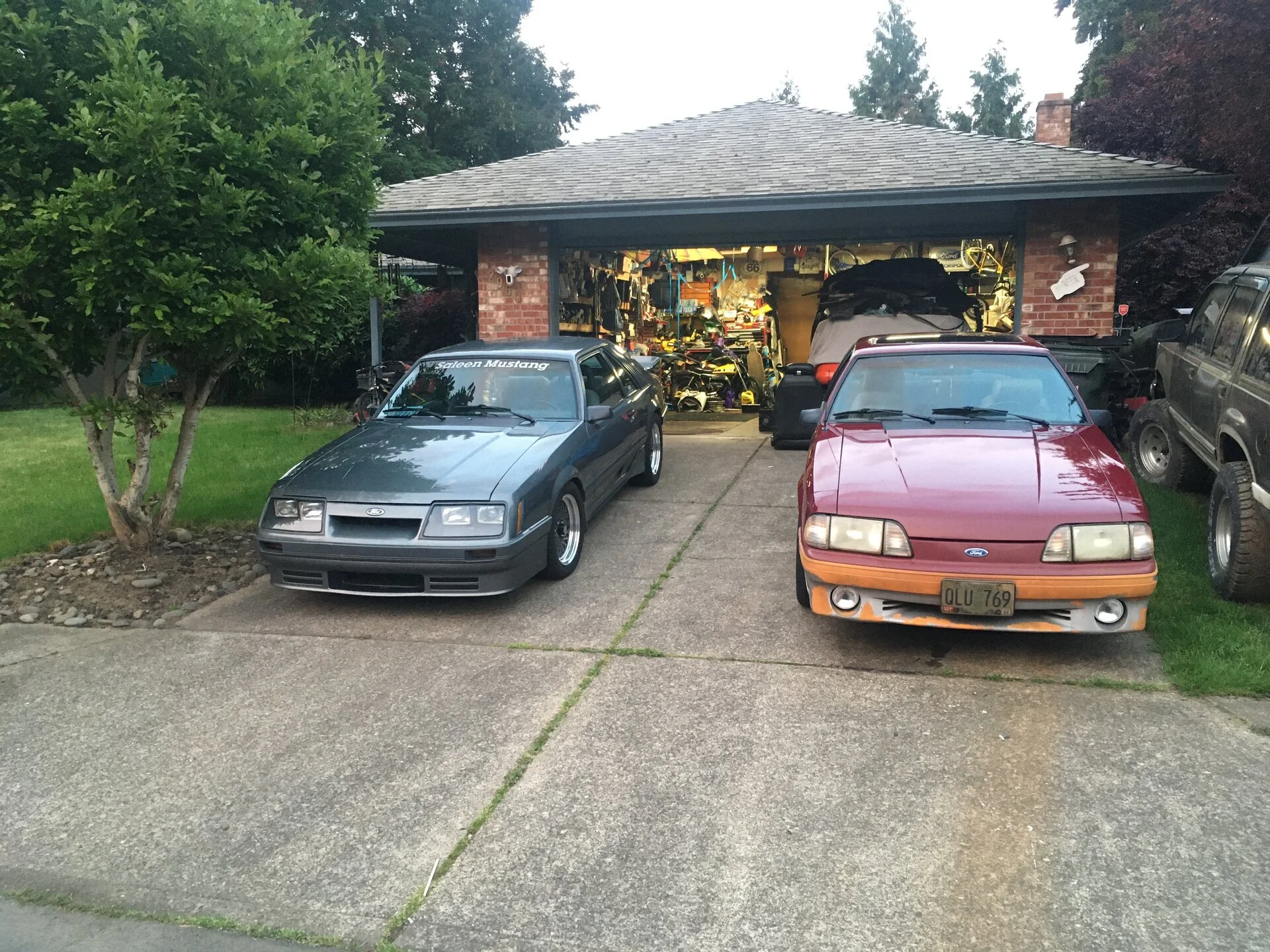

Friday night I had to go rescue my wife. I bought an 98 F150 from a tow yard on Wednesday. Wife was driving the F150 home from work and the fuel pump died. I went out there to see if it was something I could fix easy but it wasn’t so we had it towed. One the way back home from where the truck died, the headlights went out on the 89. I had to pull the high beams on to get the headlights to work the rest of the way home. Saturday we took the Saleen and went a car show. Weather was nice till about 1:00 and then it started to rain and did not let up till about 6:00 or so. Today I tackled the headlights. First I took the headlight switch out and swapped in one I had from a 90 GT parts car. Still no headlights. Surprisingly the headlight switch plug looked to be in real good shape. No melting. After that, I went after the multifunction switch. One of the 3 plugs off that had some very slight melting on one of the leads but it is really not bad. I got an NOS switch years ago with a parts car I bought. I forgot I had it till recently when I ran across it looking for something else. The multifunction switch solved my headlight issue.
Here is a pic of both my foxfodies in the driveway after my wife waxed the Saleen for me :nice:

I have not had time to work on the car much lately. Just have been driving it mainly. I did try and find the hatch leak last weekend before I put the rear moldings back on. I removed the trim panel under the hatch and ran a water hose for a LONG time, all over the place and found no leaks. So I reinstalled the moldings.

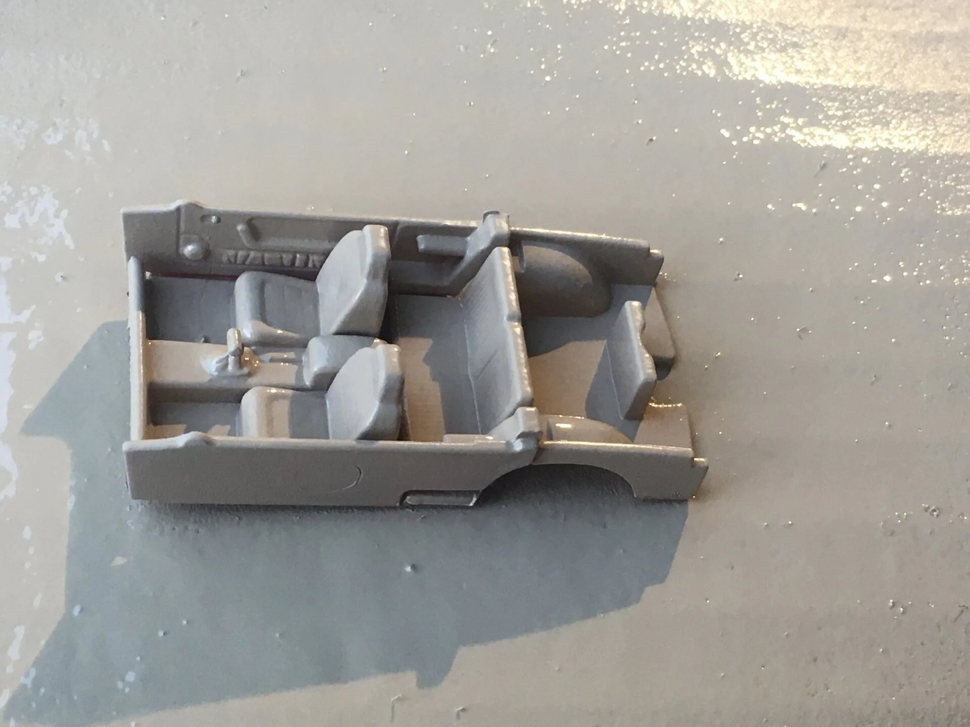

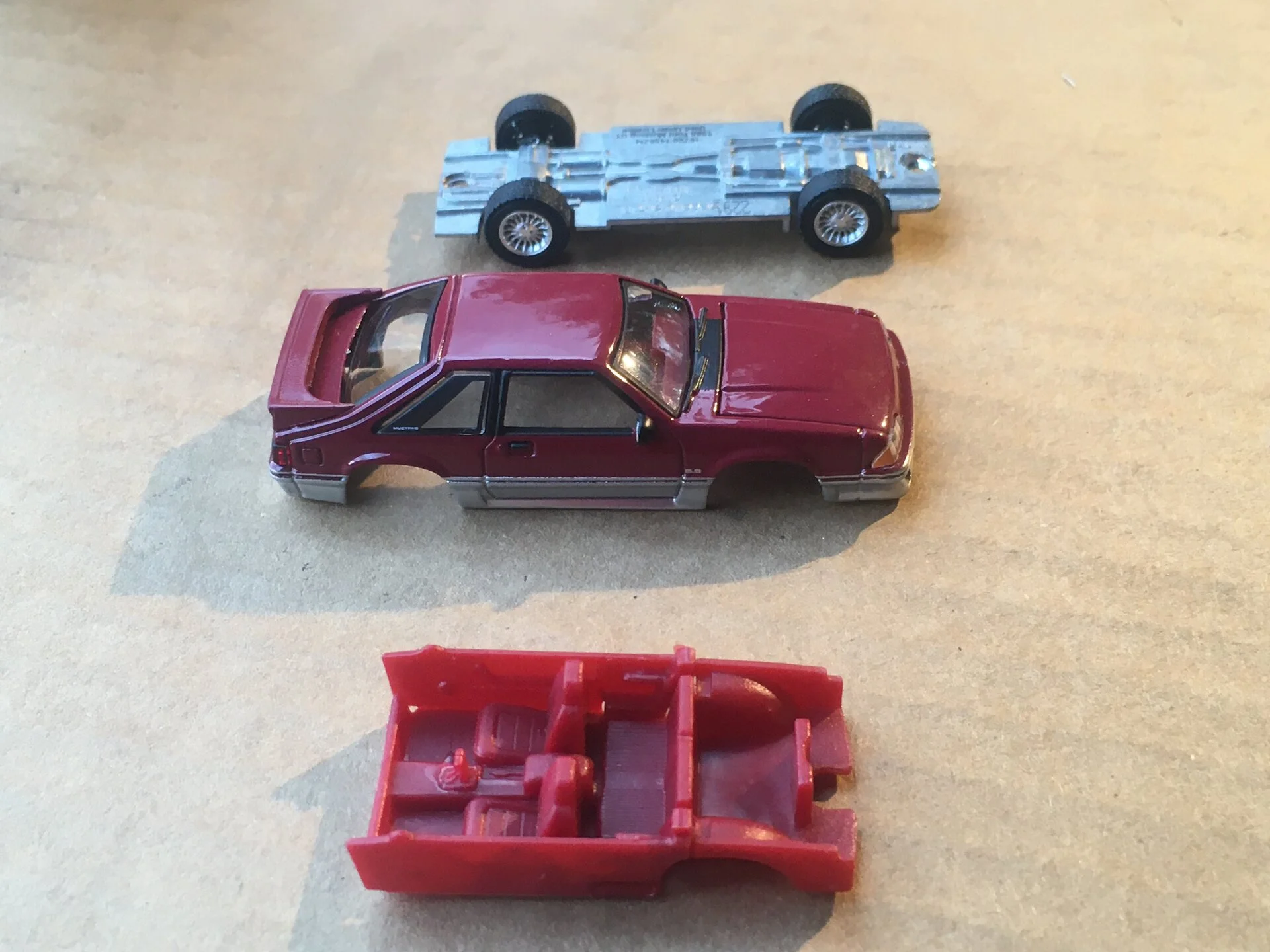

I have been eyeing this die-cast car for while. I finally got one for under $10 shipped. I took it apart last night and painted the interior sand beige to match my car. Unfortunately the dash and steering wheel was rivited to the body and it looked like it was part of the hood hinge mechanism so I decided not to fool with it and left it red. I am pretty happy with how it turned out. Now it is with my collection at work that sit on top of my monitors.

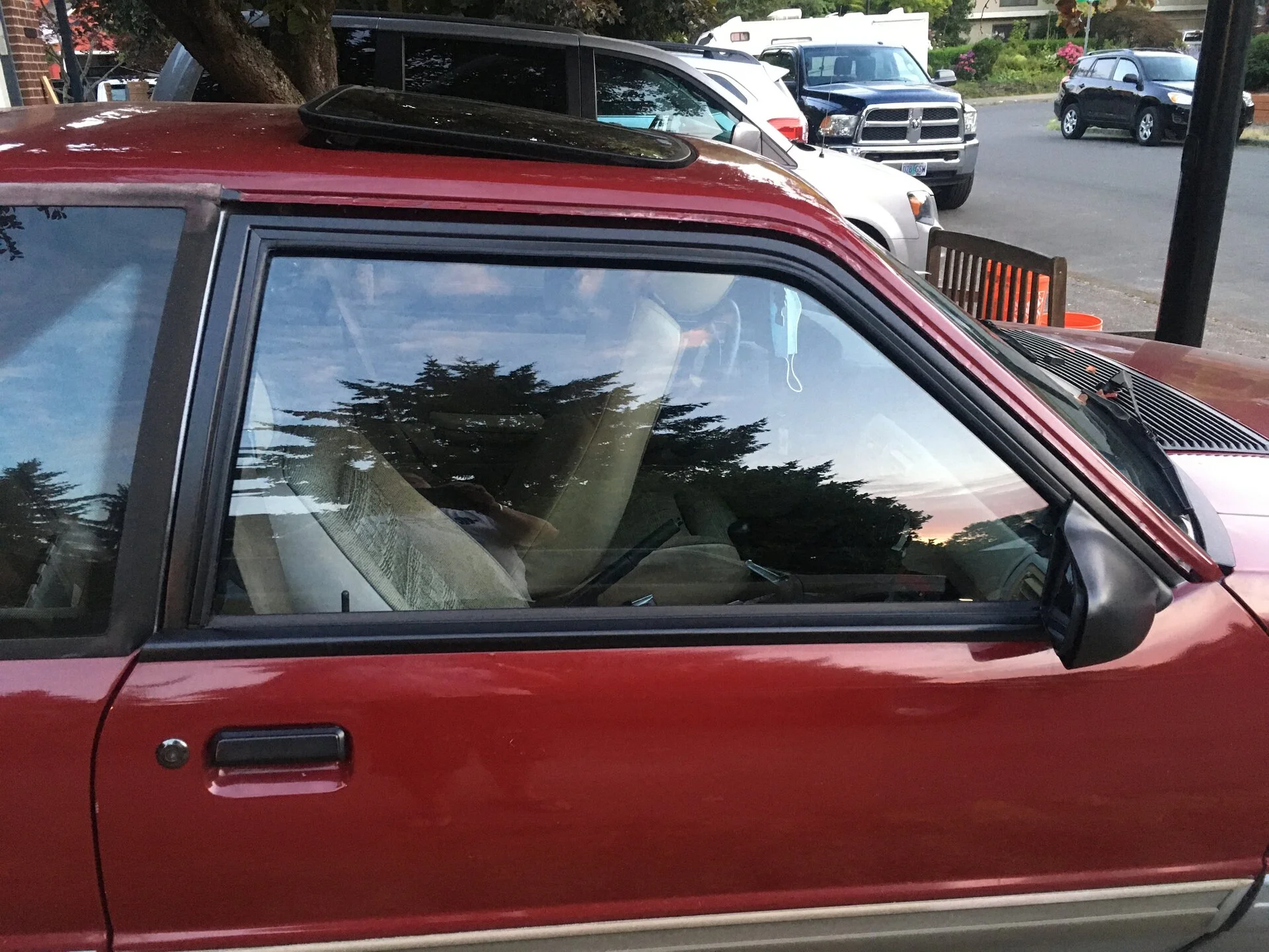

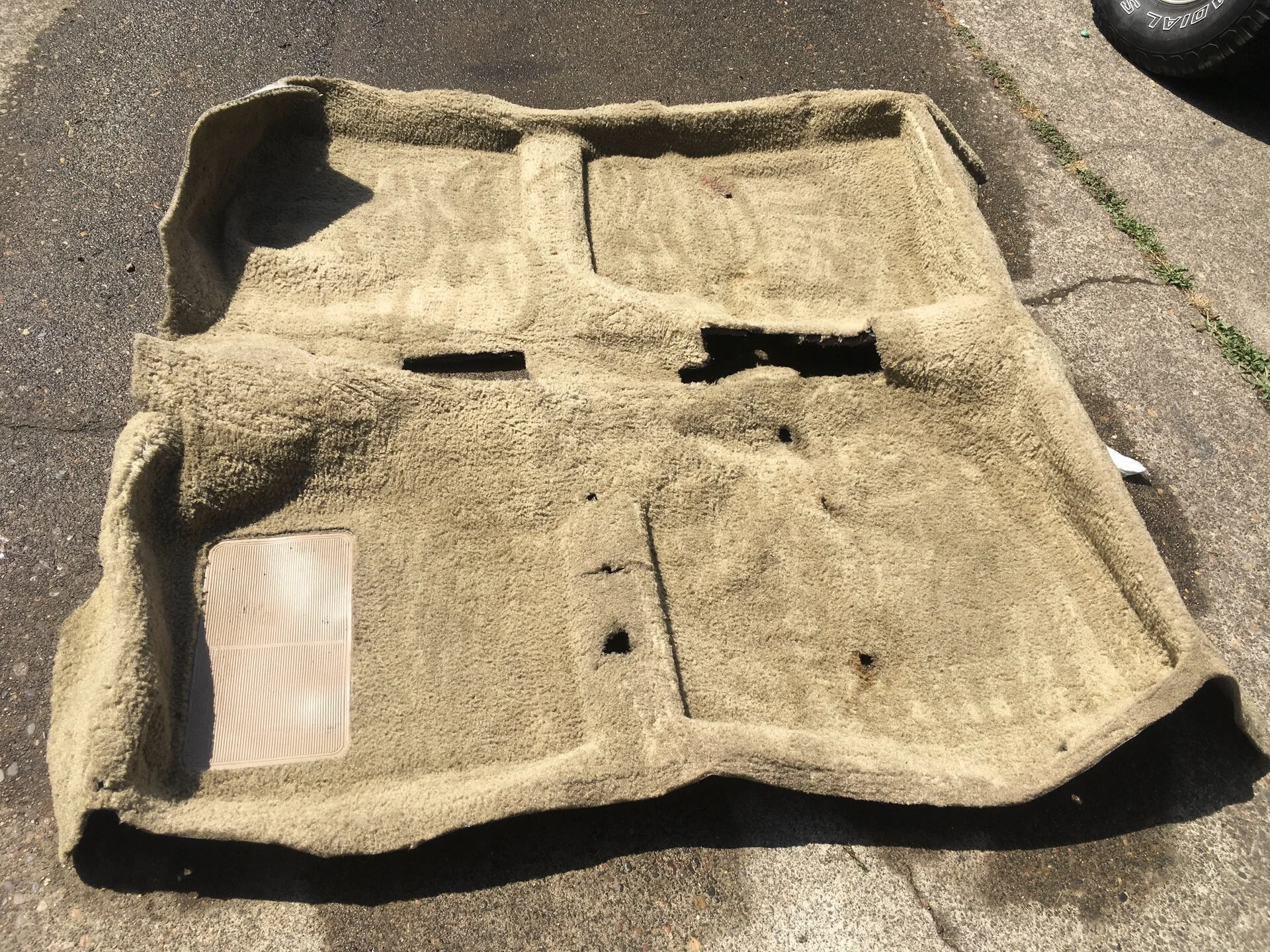

Got a lot of work done on the 89 this past week. Got they sunroof trim repainted and put a new seal on. I also pressure washed the carpet. I think it came out fairly well. Hope to put it in this coming week. I also repainted the door trim on the passenger side and replaced the channel weatherstripping and guide bushings. Window motor is weak so that project is not quite done.

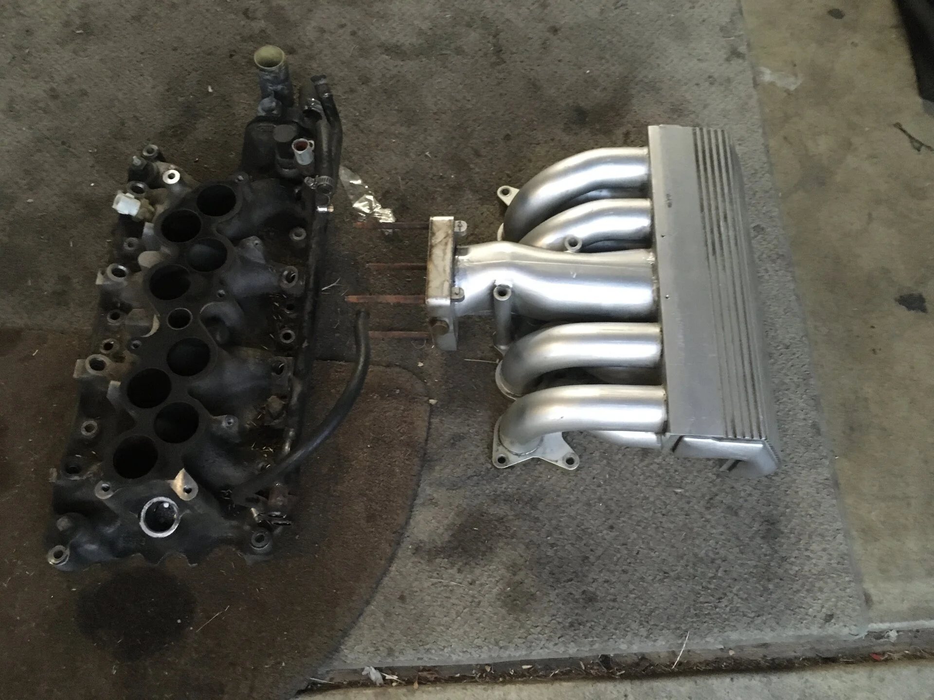

Yesterday I picked this intake from a local guy. After that I stopped at pick n pull as there was an 89 GT vert that came in earlier this week. I found the cruise servo cable I needed for $14 so I was happy.
