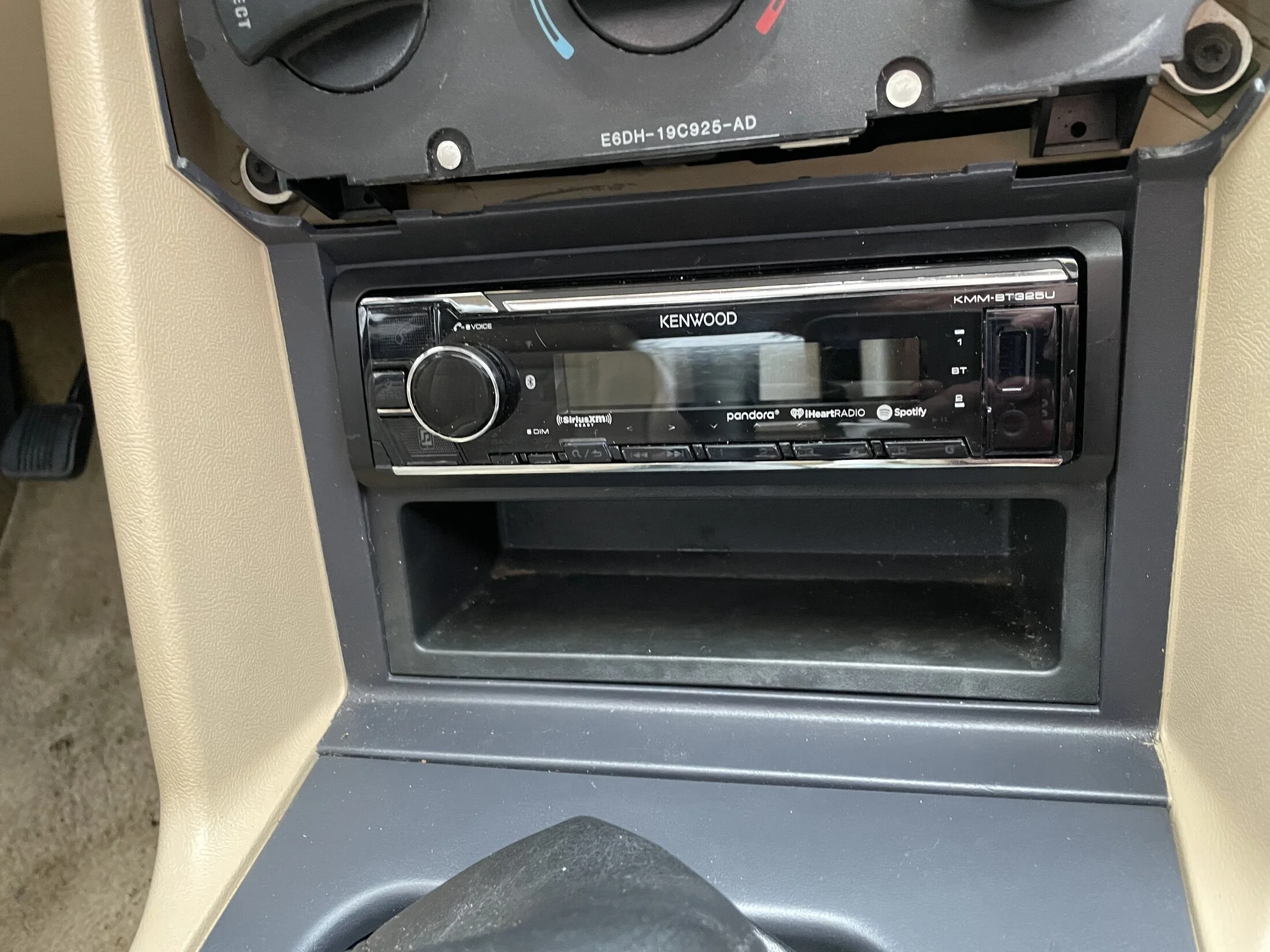

I didn’t have a lot of time to dink with the car this weekend as it rained most of the time. However I did manage to get the deck and cubby mocked up between a rain storm like I want it. I filed the sides of the cubby till it fit inside the console opening. I think it will work just fine for what I want without altering anything original to the car.

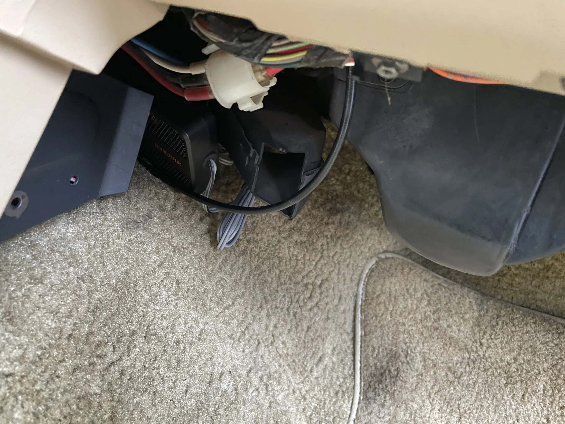

On a side note. One thing I noticed since I did the heater core is that the hot/cold dial is hard to turn towards the hot side. I did not disconnect the cable but I think I got it going the wrong way as I don’t remember seeing the cable from under the dash. Can someone confirm please?

I am no help from memory
I do not remember seeing it on the bottom either
I think it may run up and over the plenum?
Or maybe along the bottom by the glovebox and then back up?
I can find a picture on all data at the library maybe
Either way, you should be able to fix it without pulling the plenum back out
I am pretty sure they route the same in the 86 and down cars but I could be wrong. In any case this is a pretty decent write up:
That radio install looks clean. I really like seeing this done without that ugly radio adapter that screws in the dash. I just remembered that years ago folks used to put a strap of metal from the back of the radio to the center rear of the cubby to keep it from tipping out. There used to be a screw hole ( for extra radio ground ) in the center of the back of the aftermarket radios. No idea if new radios have that anymore.
There's an angled bend in that cable that can get flipped around. It's in the wire end that connects to the flapper dilly.
