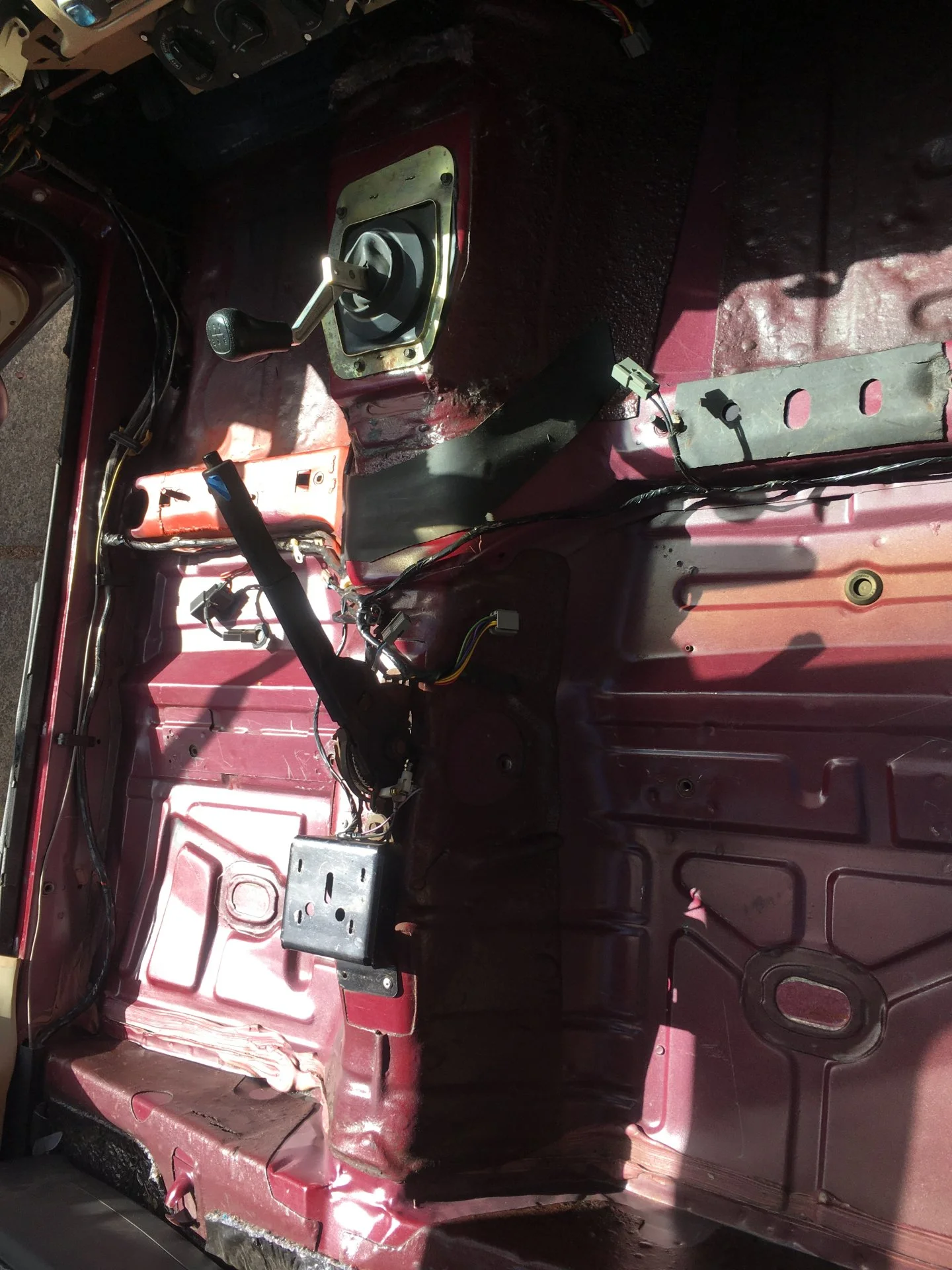

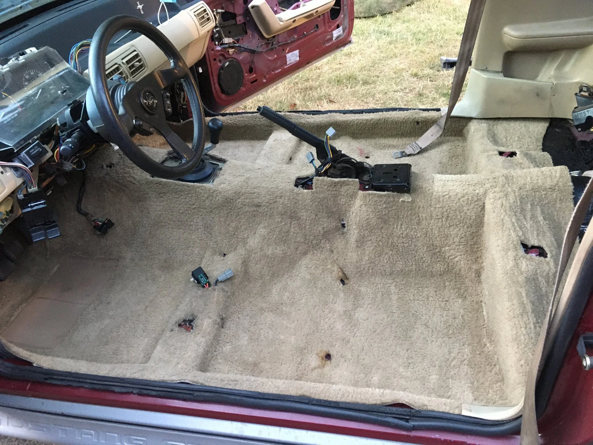

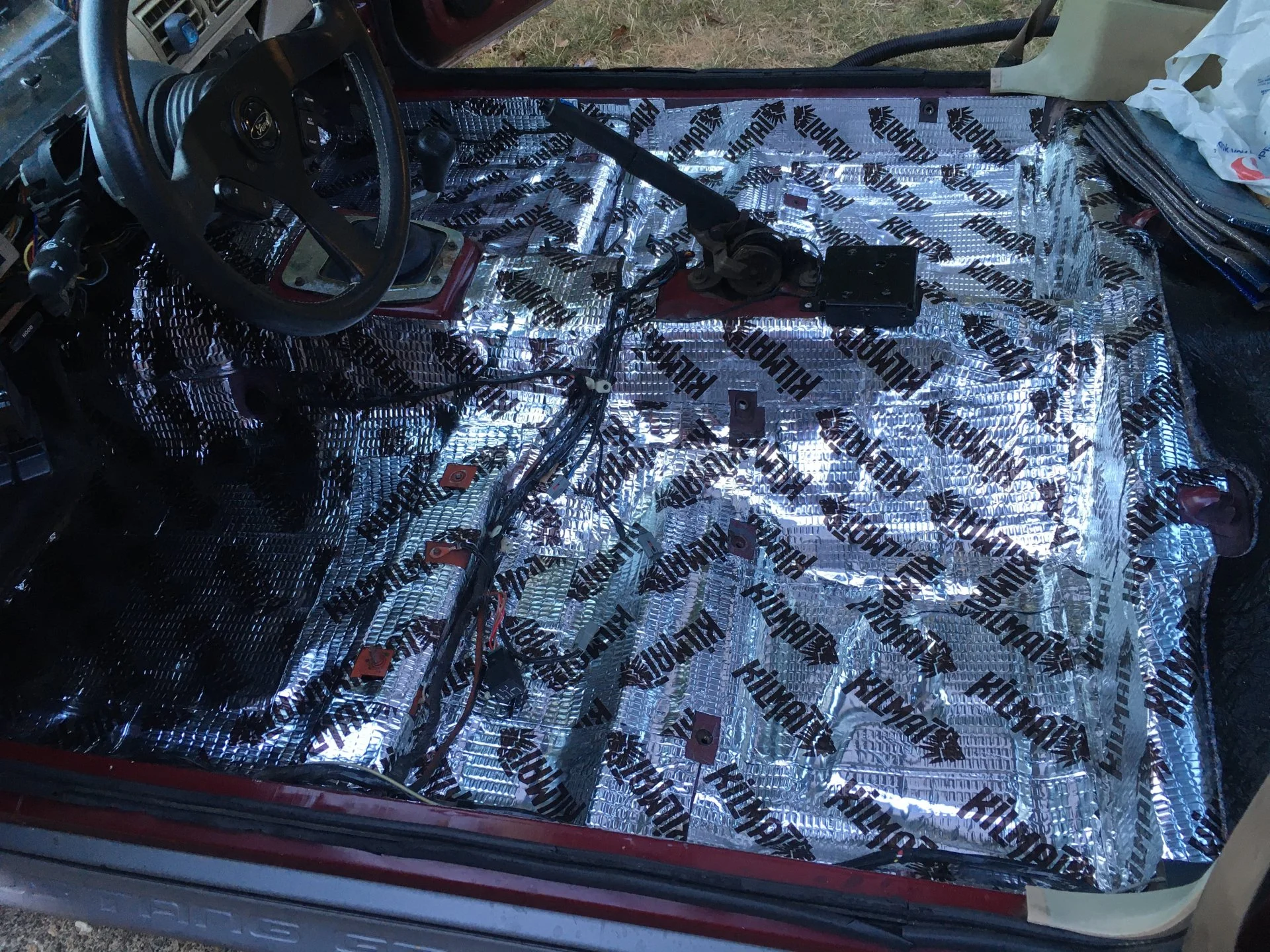

I took the week of labor day off. In that time, I re-dyed the dash and console to get rid of the multi shades of beige. I put some Killmat down on the floor pans before I re-installed the carpet. Installing the killmat took way longer that I expected it to.

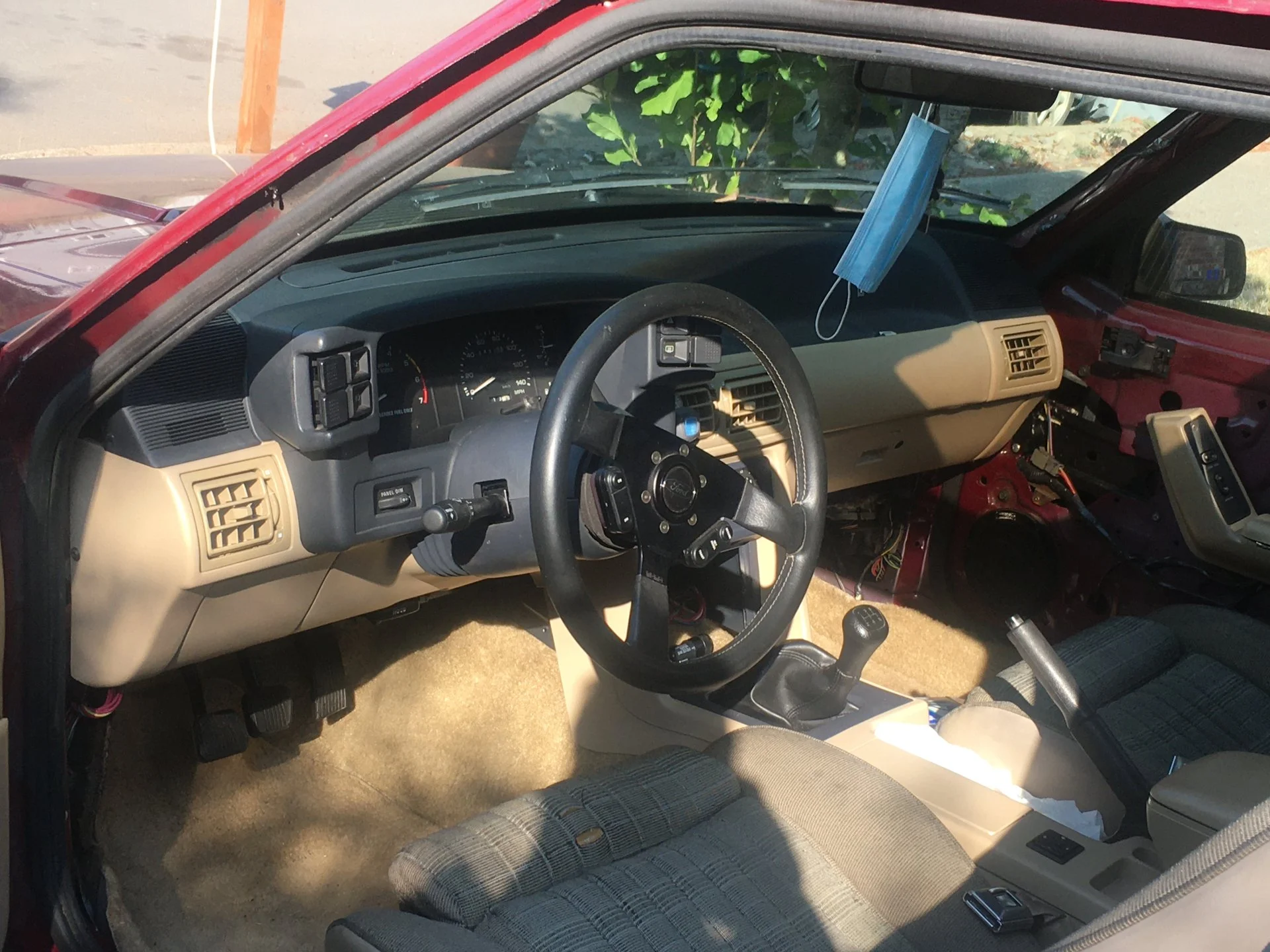

So that week ended with me getting the console and dash back together. Not the best pic. Added the carpet back in made the car hard to shift at times as I lost some pedal travel when the carpet went back it. Clutch releases close to the floor now. Seems to work better when cold and gets worse as the car gets hot. Clutch was replaced about 120 ago or there abouts. The fork cover is missing for some reason. I need to ask my friend if he has it. Lots of grime has got in there with the cover being off. Next step on this is putting in a MM firewall adjuster. I have the one I bought for my wife's SN95 before it got totalled so it will get repurposed to the 89.

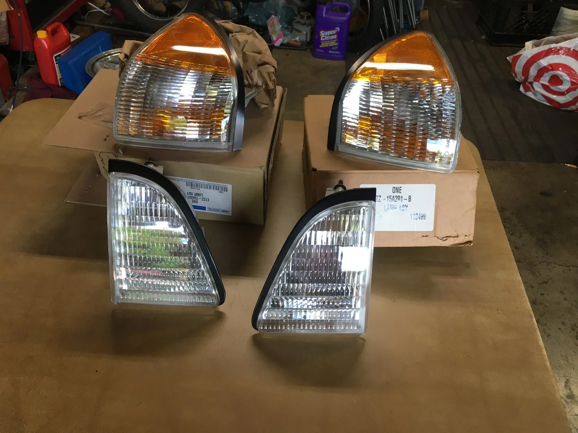

Around the same time I picked up the last corner light I needed for the car. When I bought the car I started my search for NOS turn signals as marker lights. I finally got all 4. Deals are still out there folks. I have $250 into these and I started my search in April.
