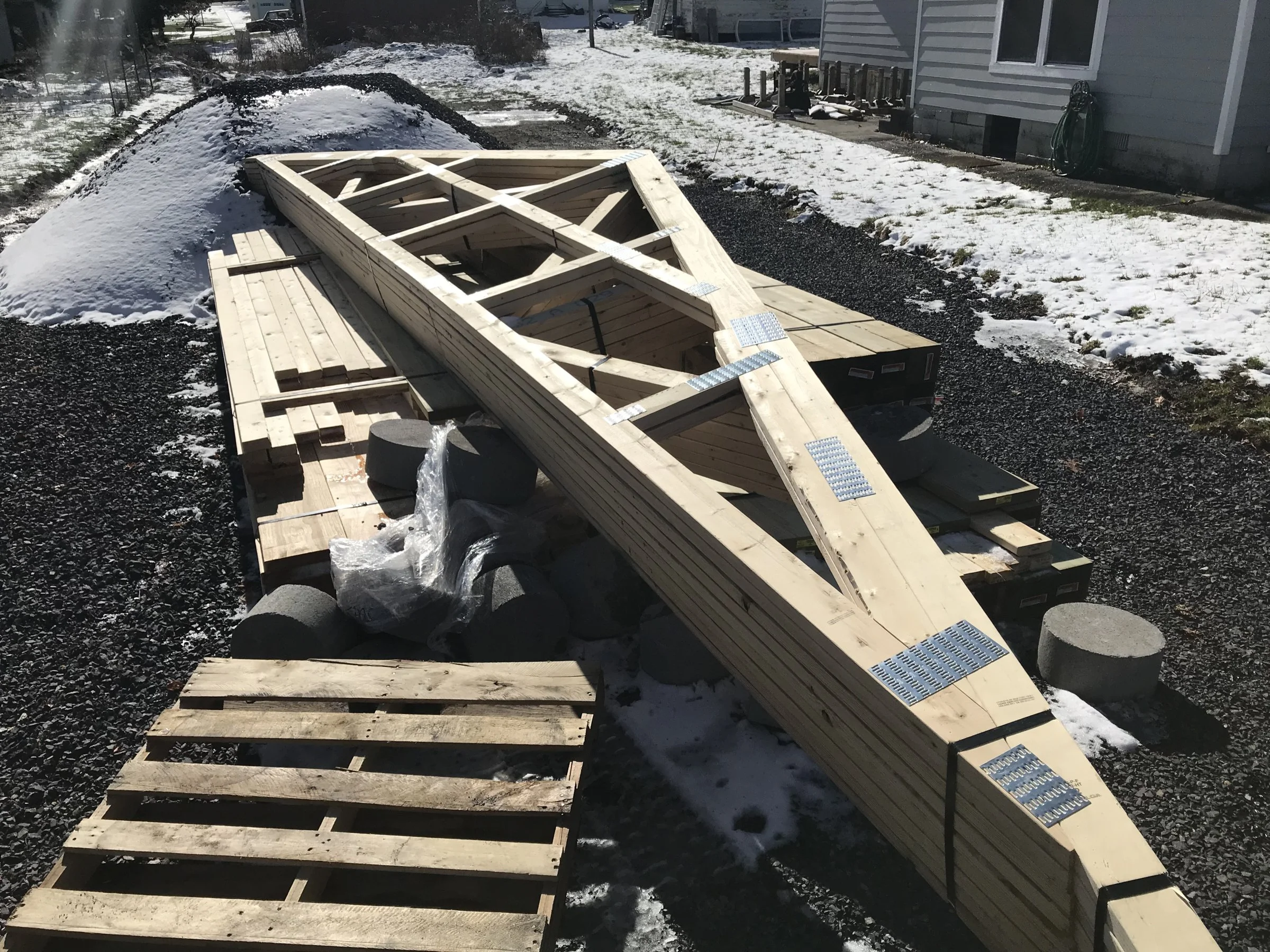

Materials for the garage have arrived. Finally. The crew is supposed to begin this week. I’m heading out of town so hopefully there will be some more progress pics by the end of the week.

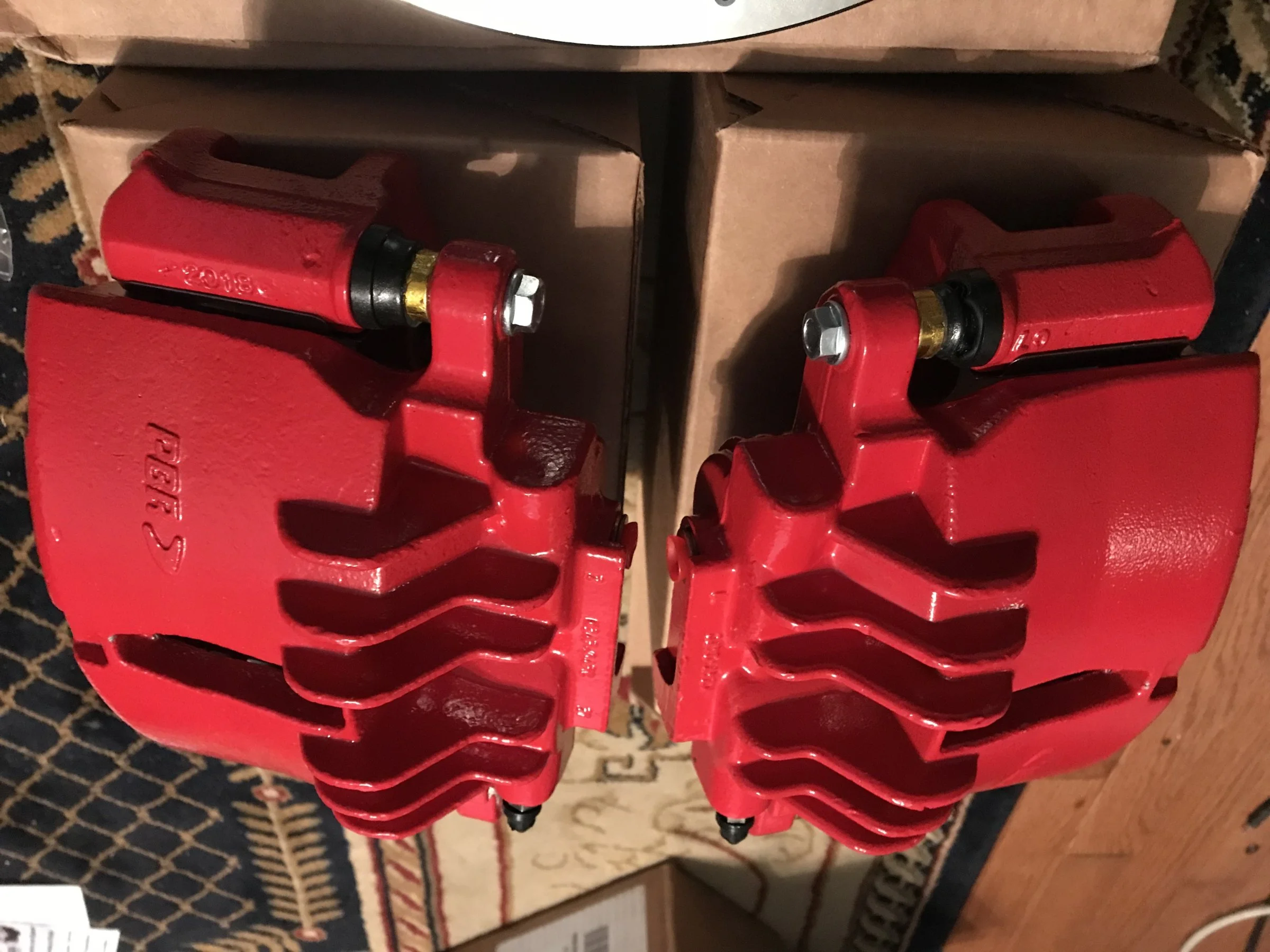

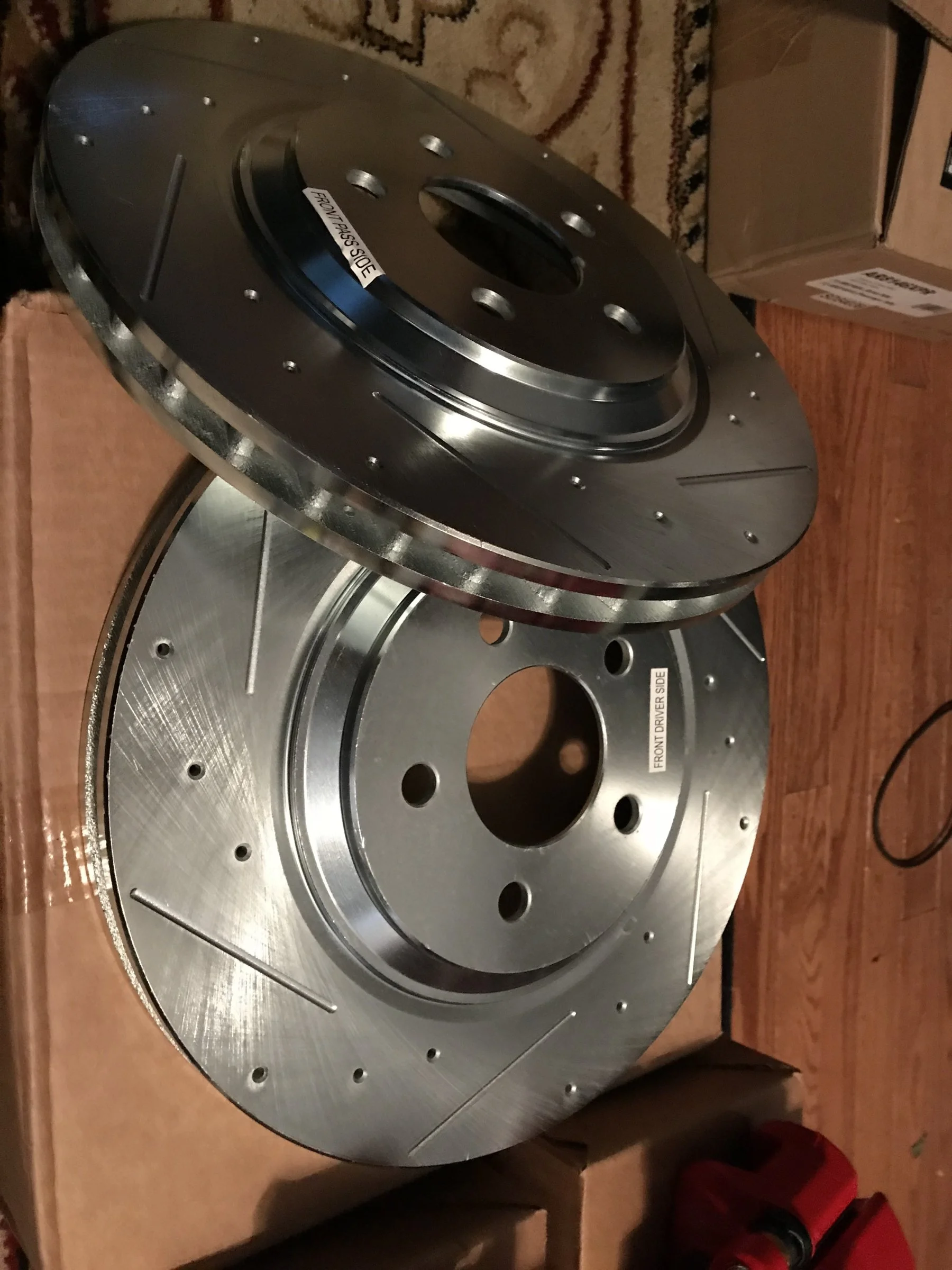

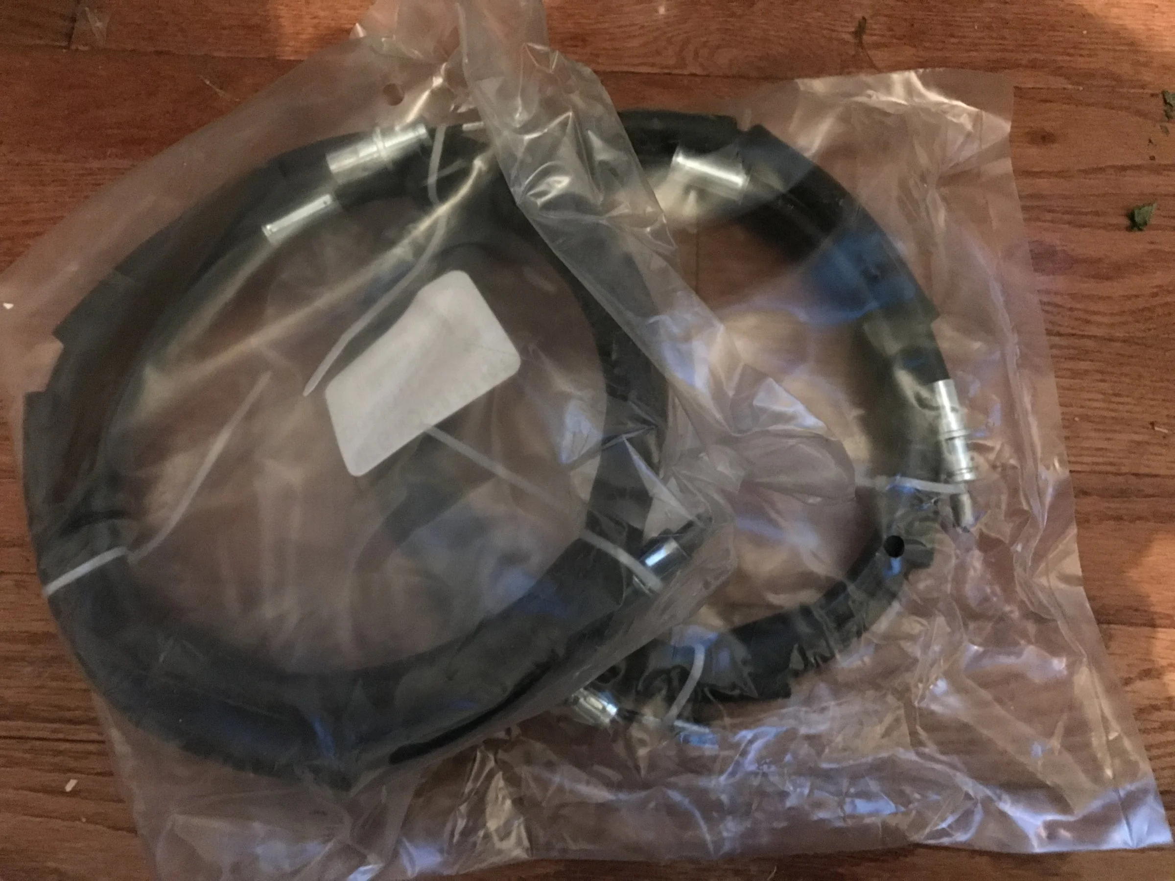

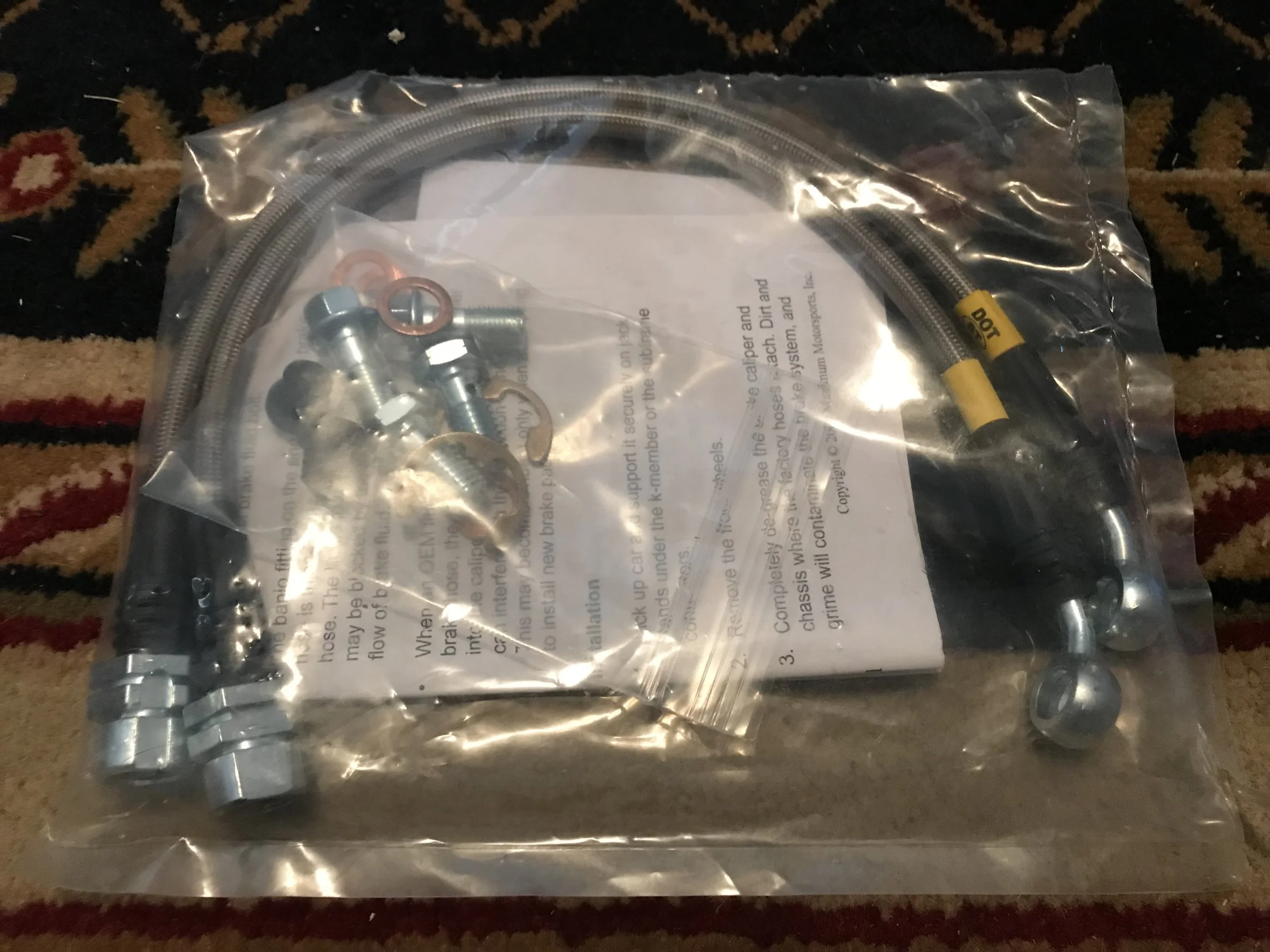

Well damn, I ordered the wrong calipers. Those are for a GT and I need the Cobras. Luckily summit racing is hassle free, already sorted, just need to return these.
I do have a question though, MM sells a stock prop valve eliminator kit which looks like just a couple unions. Do I still need the brake line adapter kit which is the curvy lines and T fitting? It seems like eliminating the stock valve completely would make for a cleaner install rather than gutting it. Thanks
Yes, you still need the 3-2 conversion kit. That prop valve delete just connects the line from MC to the outgoing lines.

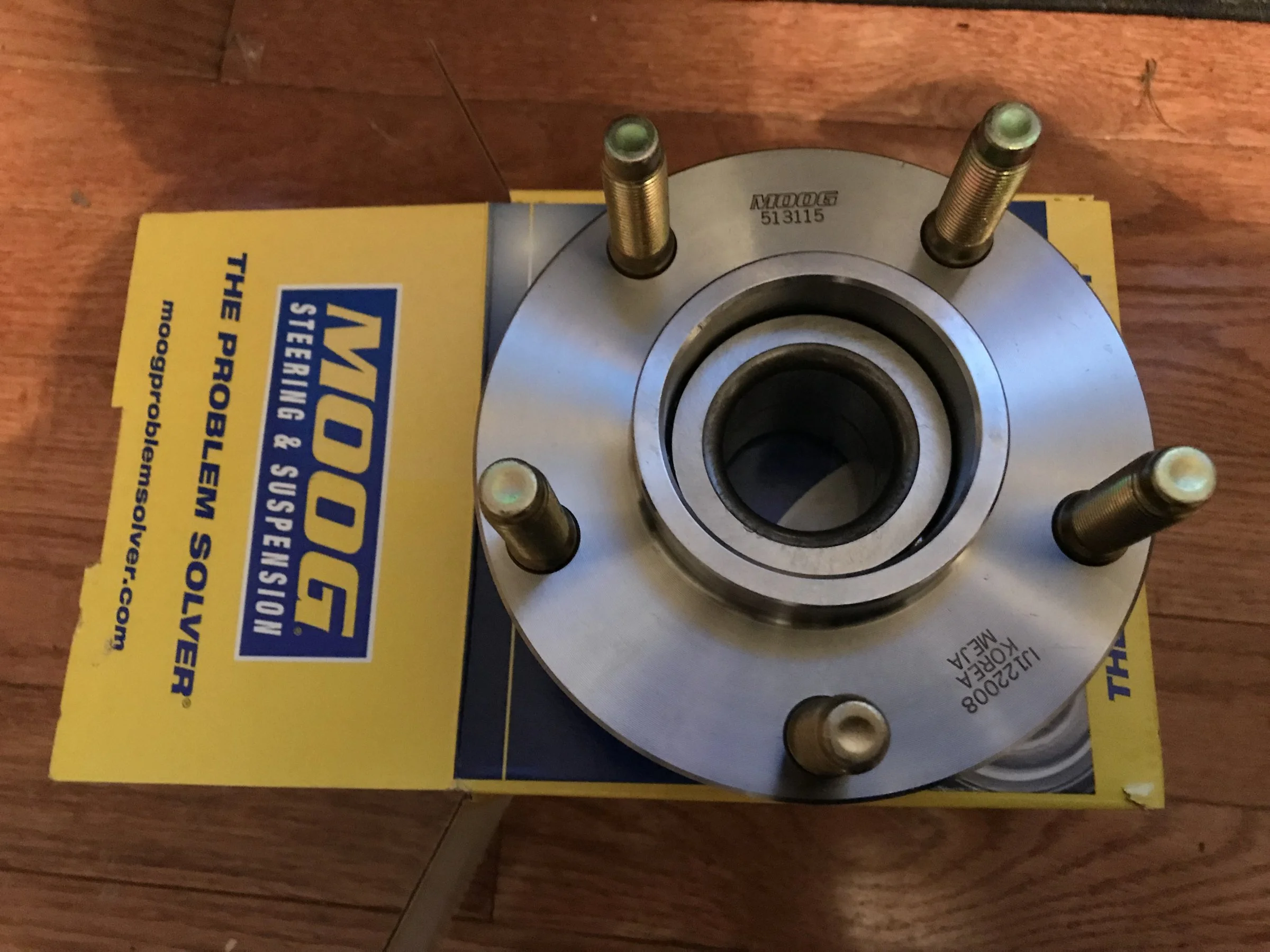

Ok thanks man. The 93 master, booster, and E-brake cables plus 95 front hubs, nuts, and dust caps will be here this week. There’s also some stuff coming from LMR tomorrow, miscellaneous hardware, etc. I should be pretty well ready to do the swap after that. I think. I hope. Lol. I really appreciate all your help.

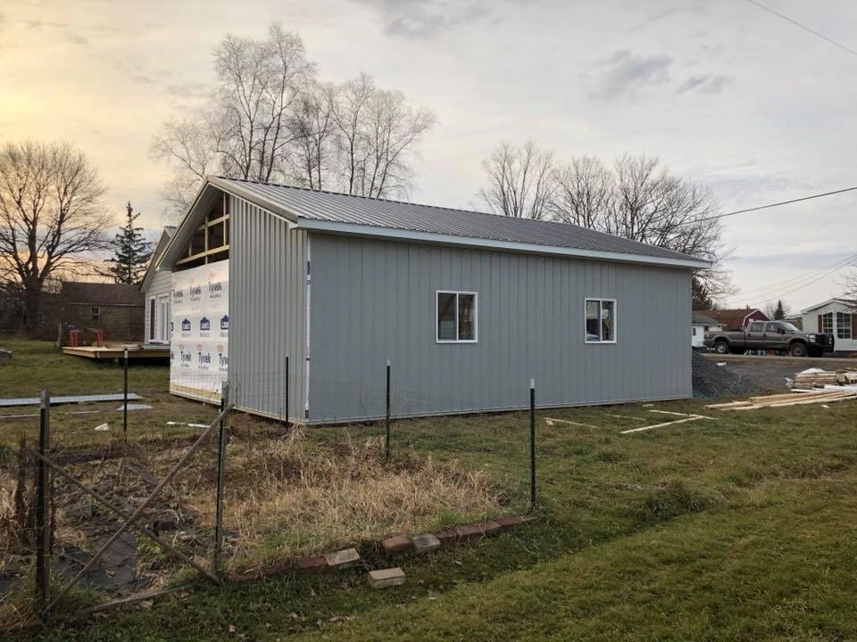

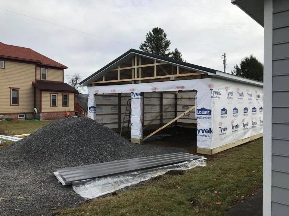

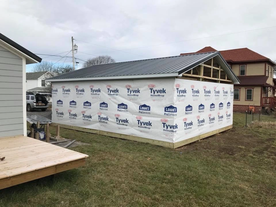

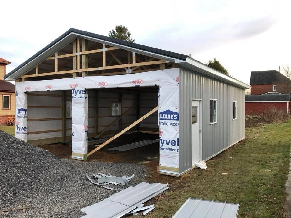

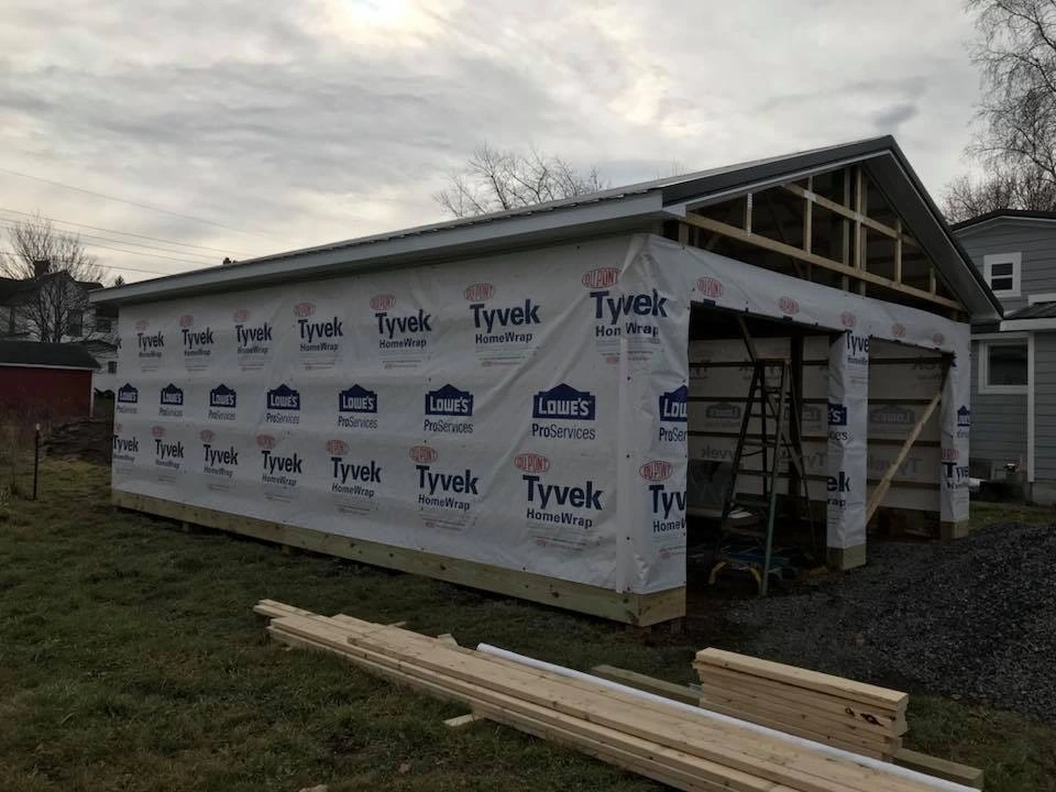

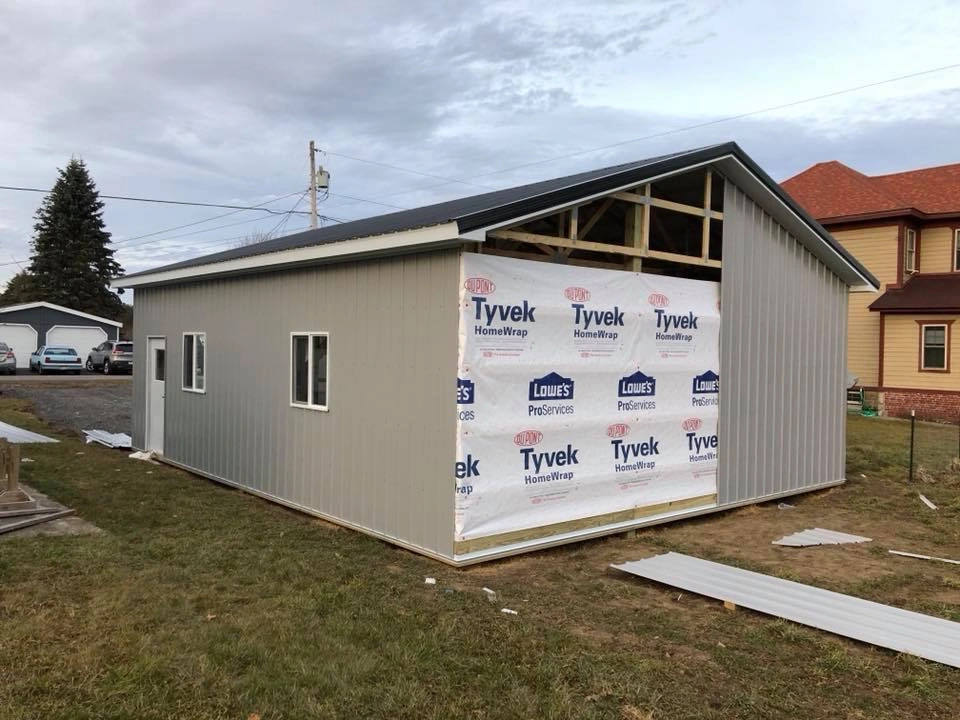

In other news, the garage is coming right along. Here’s how it looks this evening. Roof and soffits were done Friday, I wrapped it Saturday, and doors and windows were framed and installed plus most of the siding went on today. Getting excited.
Construction n00b here, but any reason the gables aren't wrapped too?
I didn’t wrap the gables just because I’ll be finishing the ceiling and insulating, and the ridge is vented so I wanted plenty of air movement through the attic space to prevent any moisture buildup. There’s lots of ways to do it. This was just a cheap and easy way. I have vapor barrier between the metal roofing and purlins so I should be dry as a bone in the attic no matter the outside temps/inside temp variance.
The bottom chords of the trusses will get covered with 6mil plastic, then lightweight metal, then 16” of insulation blown in on top of that. I want to be able to work out there any time of year.
