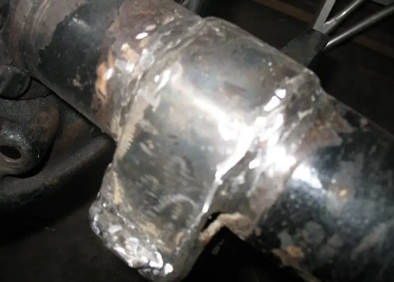

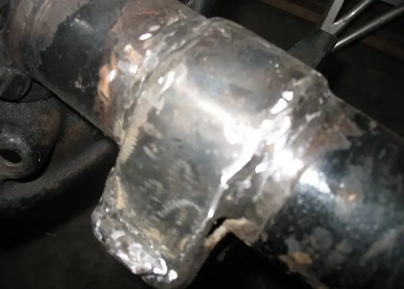

Welp, found out that stock spring perches dont like repeated 1.5 60's. lol instead of flat they look like rocking horses now, not good. Didnt hurt anything, but glad I noticed it, was starting to get a vibration in the car going into second, which Im sure was the pinion rotating too high. Winter project. :)

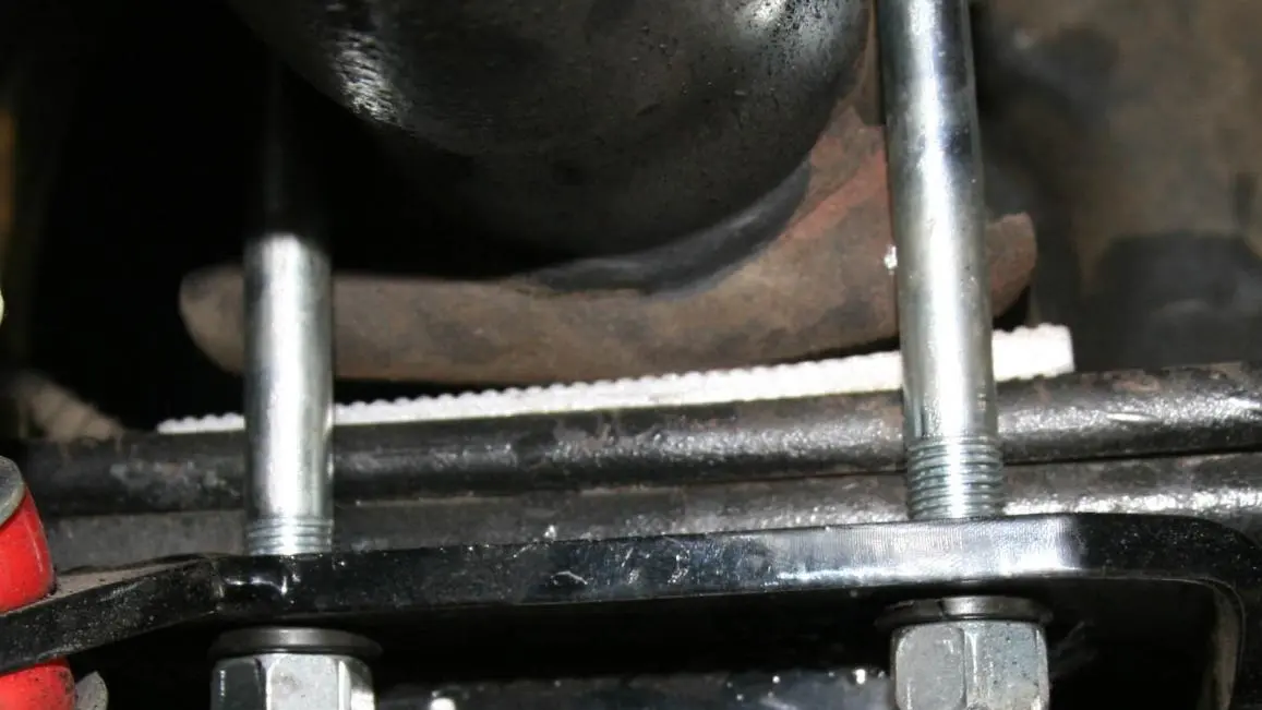

Something you might wanna keep an eye on. The guy here welds perches that uses bolts to clamp down, instead of ubolts over the axle.
roller perches FTW, and Caltracs. Pinion can't raotate with caltracs. :nice:
Sure it can, I have caltracs.

Not good!
I have roller perches in the front, this is like a roller perch in the back. LOL

nah, I added those shims before I went last night, it was already messed up before. Just ended up a little worse. Ya, the pin makes it thru. It was the first time the shims had ever been on my car, I was checking it after every run, last run it started to move again and had a vibration in second gear, so I called it a night at that point.
Actually the pinion angle changes a ton, its rolling back and shoving the pinion into the floor and the leafs stay put.
The Caltracs and leafs will hold position while the axle rotates on the leaf springs.
No, no, I realize that. I mean they hold the pinion angle when everything is as it should be. No broken leaf pads. Haha, pinion in the floor is pretty damn bad.
ahh ok. quit confusing me. LOL
Well, luckily it wasnt that bad, but it was far enough to cause a pretty good vibration. Last race for me anyways till next yr so got all winter to mess with it.
