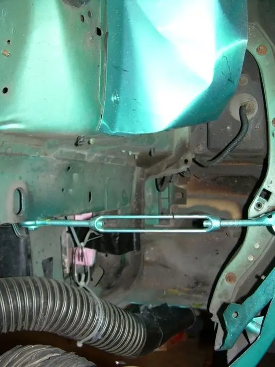

I've heard this, more from the SN95 crowd, but I've been running without fender liners for 5 years and 30,000 miles now, over 3000 of which were on race tracks, half with sticky R-comp tires, and I can assure you I have no such dents. I did make a shield out of aluminum to keep debris out of the air filter opening, as you can see below, and that's it. No other problems.
