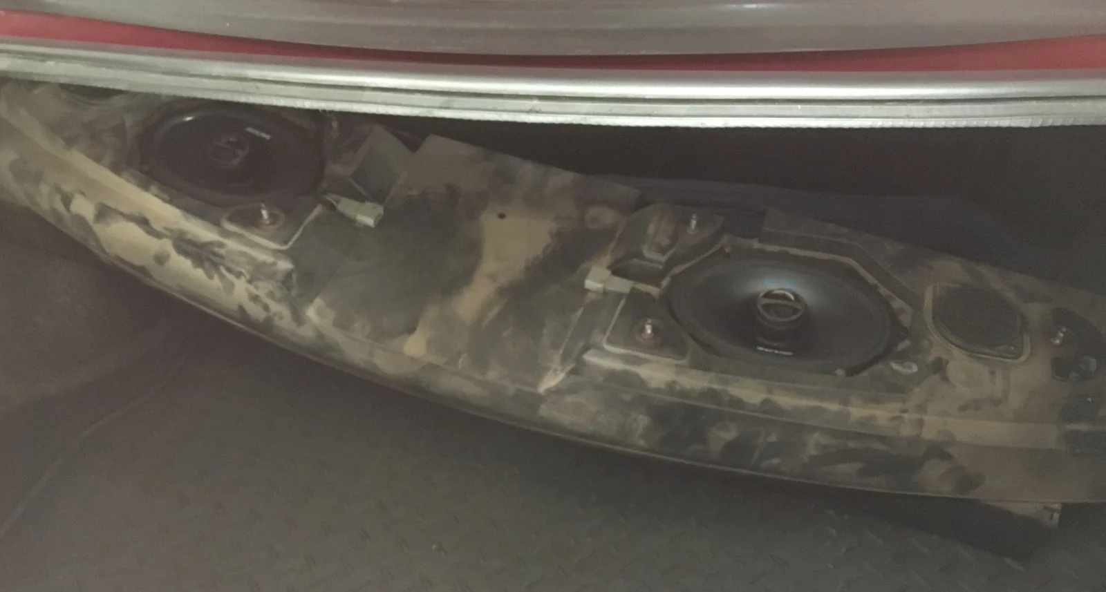

7.Fixed rear speaker AMP wiring. (Had a small buzz that was on/off - took forever to figure out where the issue was) (now I am thinking about replacing the speakers.)

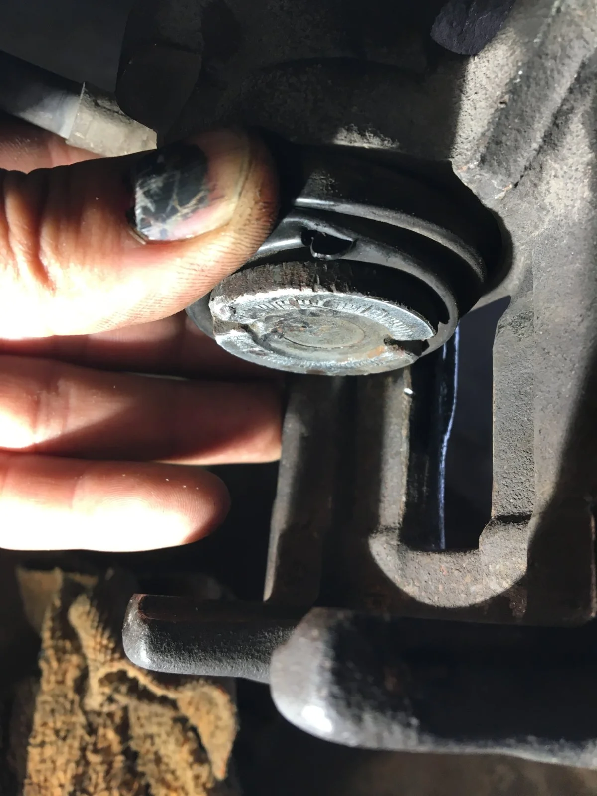

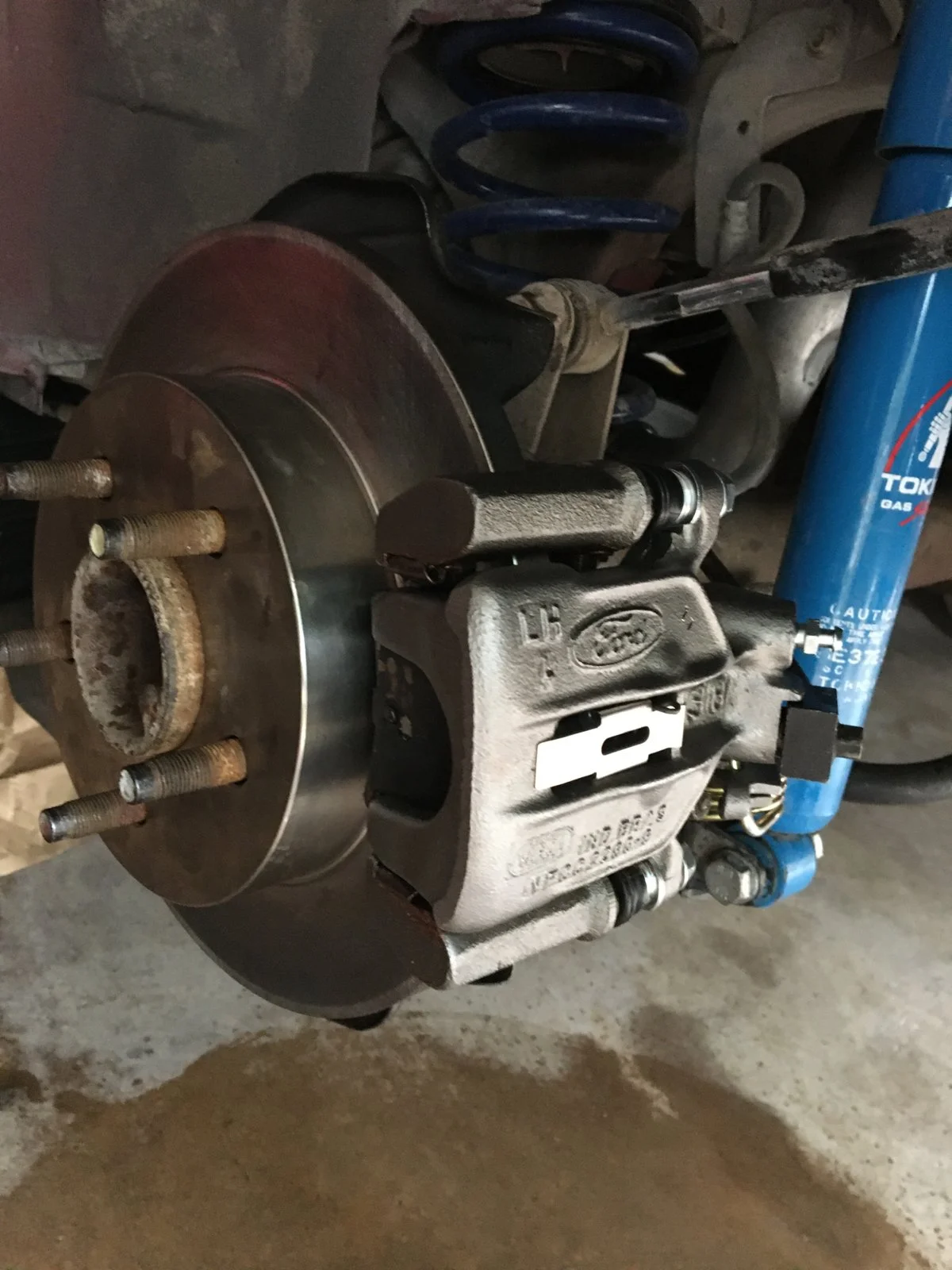

8.Replaced all rotors and brake pads re-bled the system. (completely serviced everything)
I also found a seized rear rotor that wasn't working at ALL. REPLACED IT TOO.

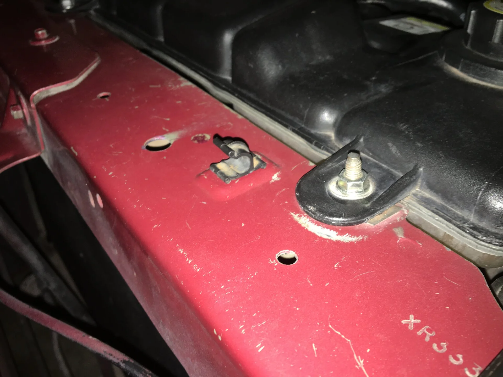

Pro tip (not) - If you accidentally remove your parking brake cable and spring, to REINSTALL it you need vice grips and pliers PLUS zip ties (8" 75p strength) to hold them together as you compress them with the pliers. You will reinstall them and then cut the zip ties. You'll then have to pull the zip ties out partially since they will be wedge in but its not hard to do OR you will have to buy new calipers. Luckily I figured out how to reinstall them quickly.

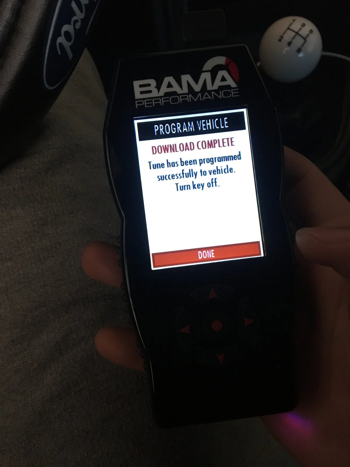

Bama Tuner (tunes for life)
Injectors were rebuilt (DIY)
Replaced Exhaust bushings
I paid to get ball joints, inner/outer tie rods and a alignment done. :/ (yes I tried to do the ball joints and it was a waste of my time lol)
NO CEL's at the moment. If the bama tuner works, I shouldn't get any codes for the long tube headers. Also I rebuilt my injectors because I felt like some were either leaking or stuck or something.
First impressions after changes regarding the tuner and injector rebuild - So the car feels "tame" or smoother. Like it feels as if it is running better. I don't know if I got a performance gain yet I will update after the end of the week. I did ask for a couple of tunes so I'll change between them to see if the 87 is any better then the 93 or vise versa. The main goal is to have the car run smooth and no codes coming from the long tube headers. (o2 delay should have been changed for my car)

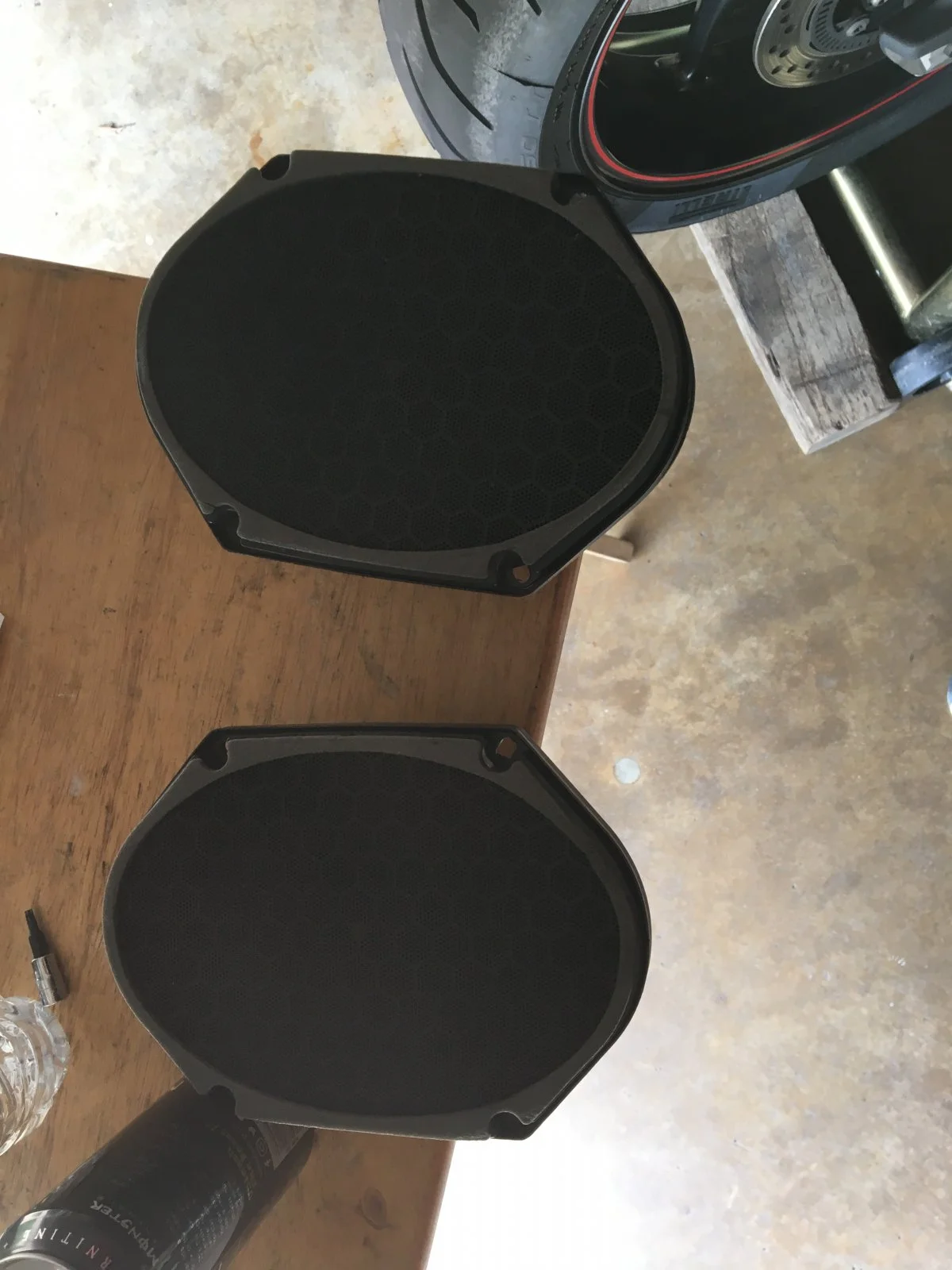

1.Rear deck speakers replaced BACK to OEM mach 460 speakers // REASON - rear deck speakers would cut off at high volume or heavy bass.

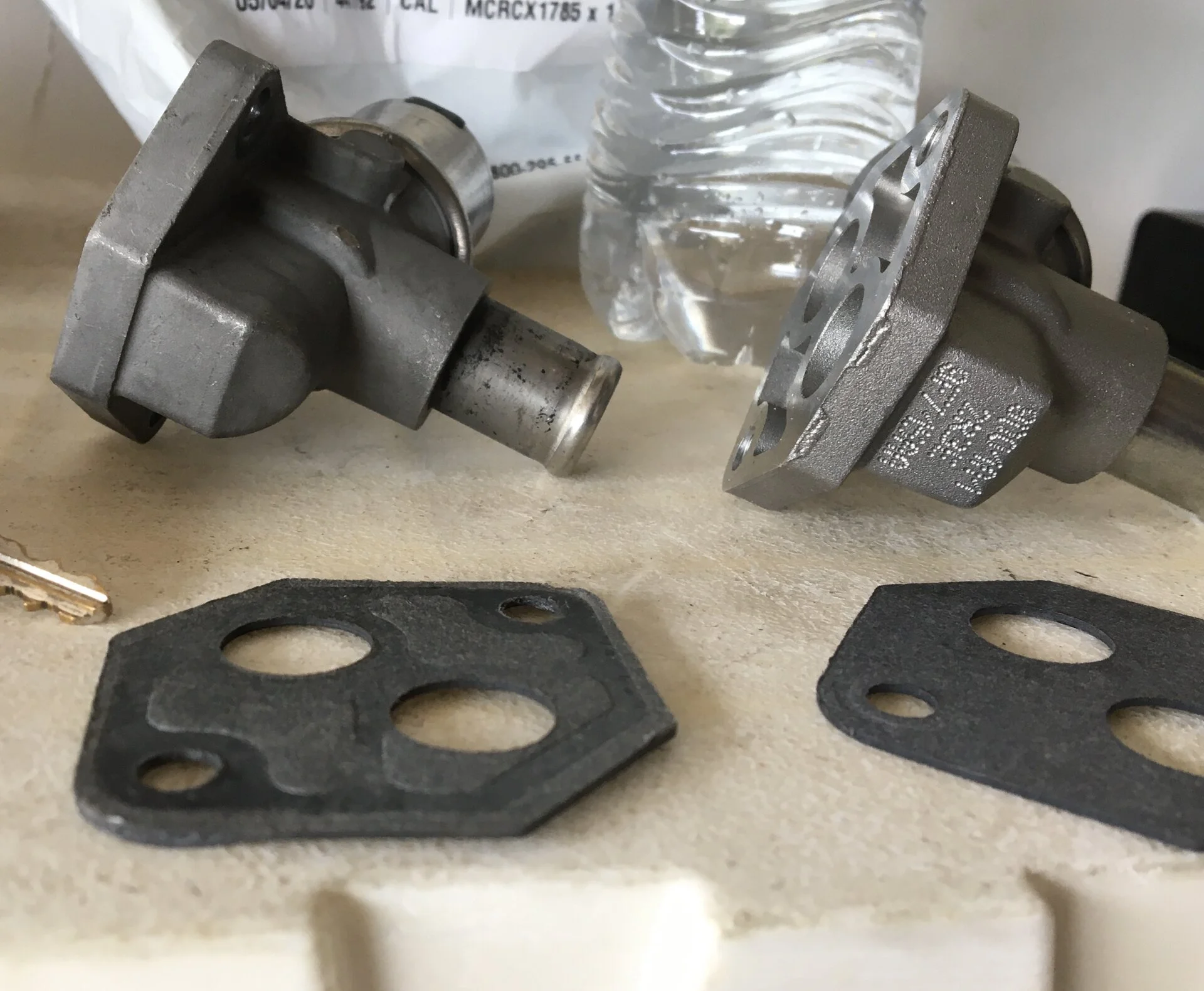

2.Cleaned IAC due to a weird random stall, I also ordered a new motor craft unit since the one I have currently isn't branded or marked with anything. Could be a aftermarket cheap one.

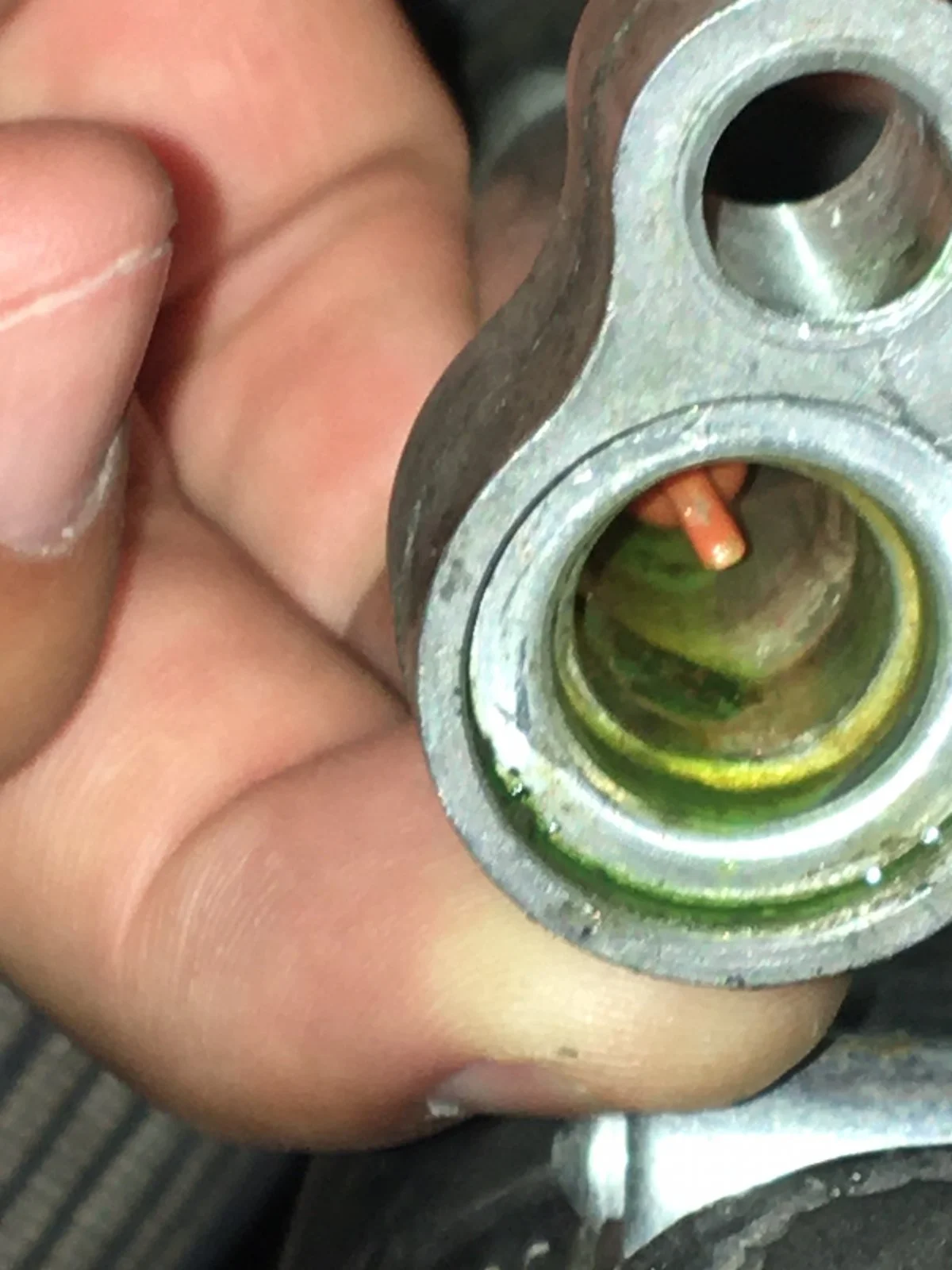

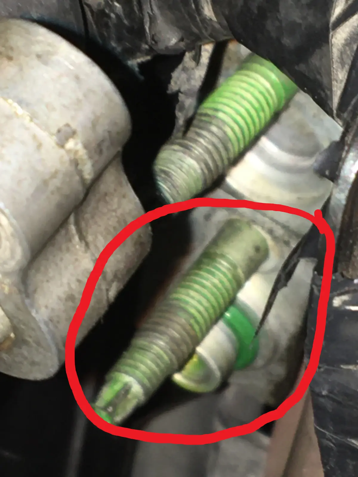

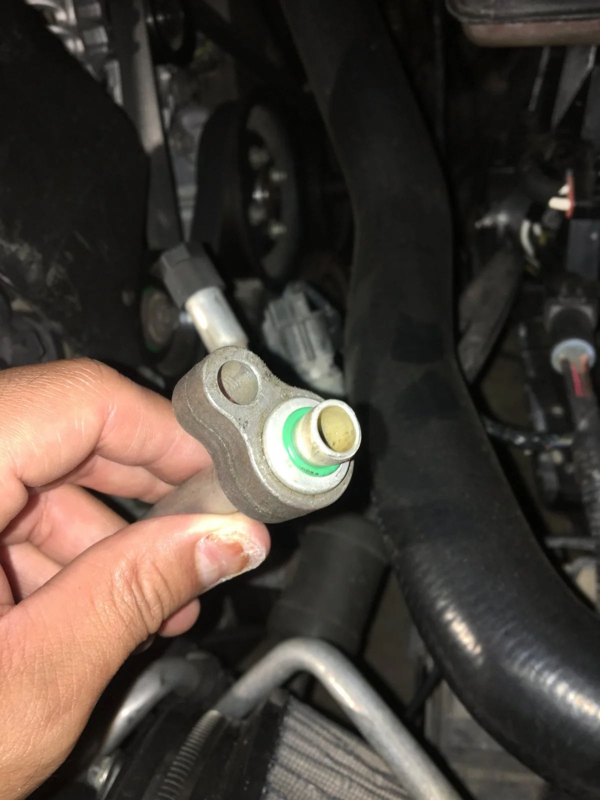

Back on the A/C system now (I already replaced the blower motor/resistor and condenser.
Fast forward to now and the Texas heat is way too hot to be without it. HOWEVER the ac system had a leak at the connections to the condenser. I replaced the o rings and lubed them with PAG 46 oil and still got a leak when adding new refrigerant.
I need help finding oem replacement o rings if anyone can help out with that.

no CELs // on 87 tune (cheaper) // new oem iac
NEW motorcraft IAC (RIGHT)
* I did not reset the car or disconnected the battery for this replacement. I think it drove better (placebo effect?)
* reason for this change: - idle goes down when braking hard to a stop. Also kind of bucks (sometimes) as if it wants to just go when slowly releasing clutch on first gear.
new TPS sensor / computer reset / clutch cable or better driver maybe needed..
- - Currently haven't got the AC leak fixed either for the 2 o -rings at the condenser. - -

AC system - AC condenser o-rings were replaced by getting them off a wrecked mustang and using those. Refrigerant holds however there may be a small leak or may need more refrigerant since its been about a month and its still cold but not as cold as when first filled.

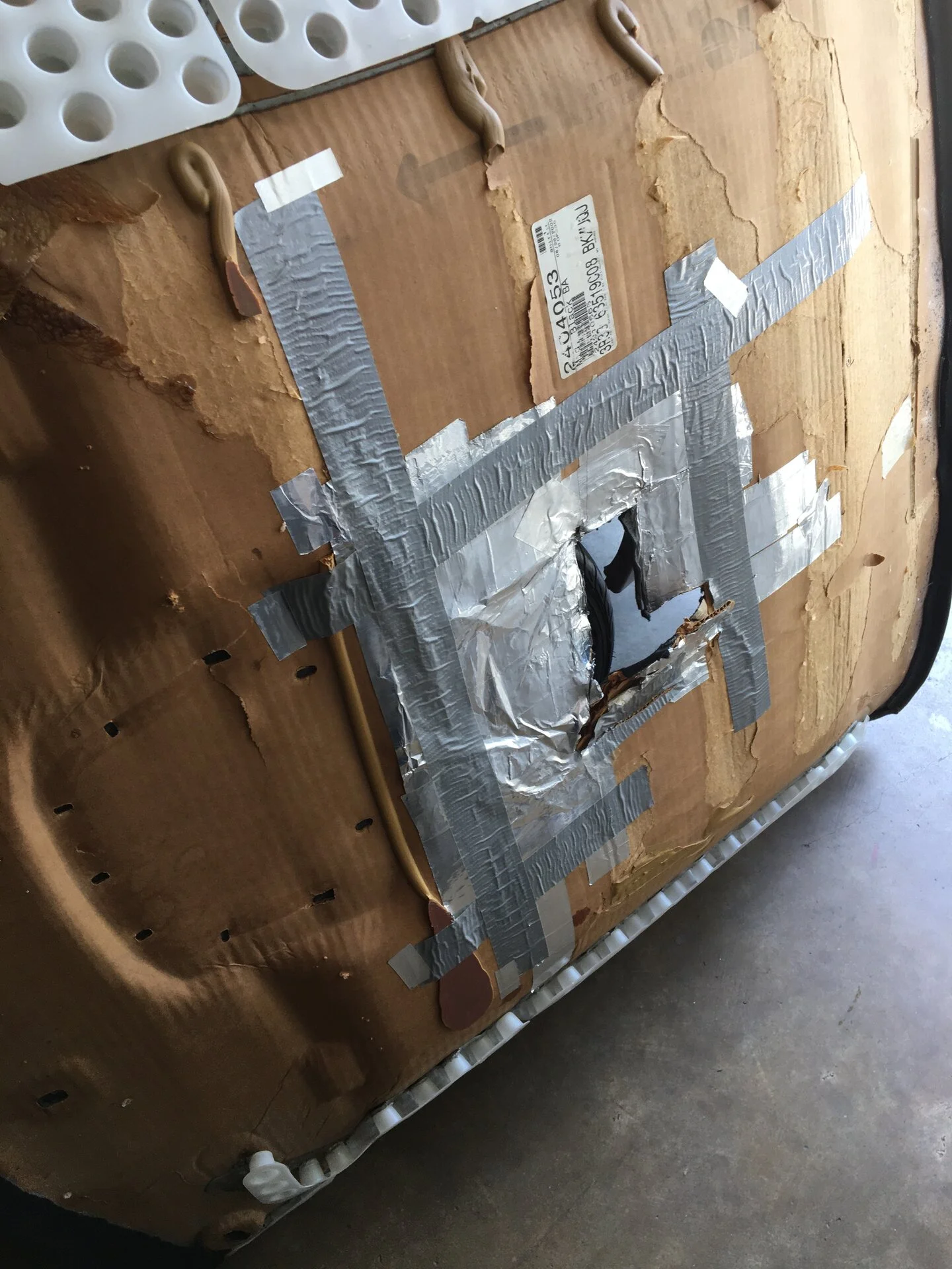

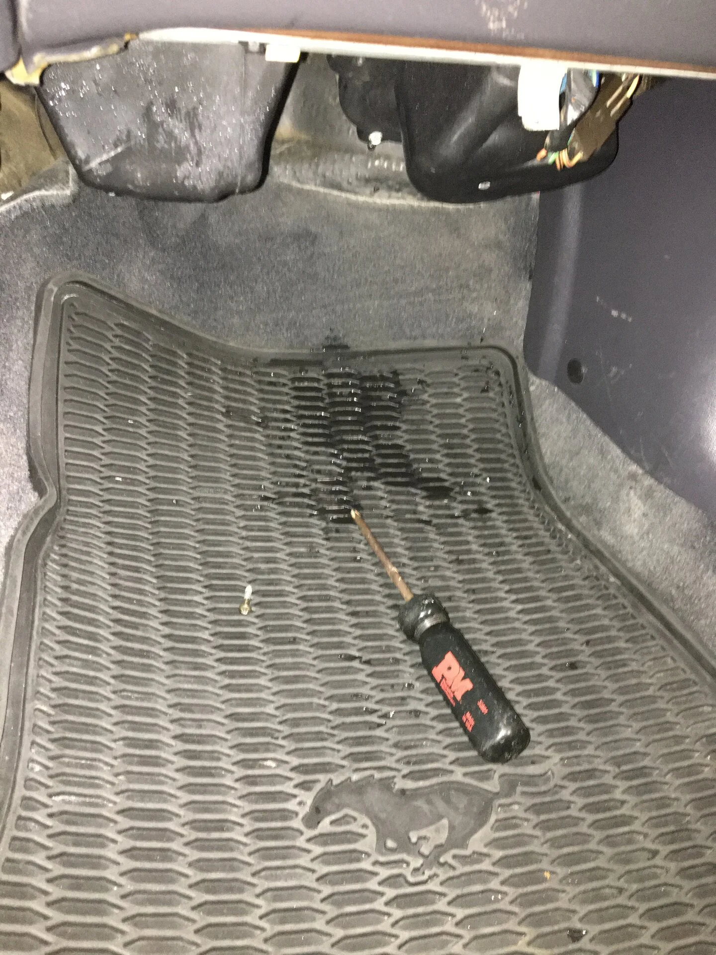

Problem: AC drain melted from the beginning of the build there was a header exhaust leak and I assume it melted the crap out of the ac drain outlet. I poked a hole into it and ran a wire to see if I could get crumb out but nothing was found. Water gets poured into foot well when ac is running for a couple of hours. I haven't driven the car in about a week since doing this so I don't know if its fixed or not yet.

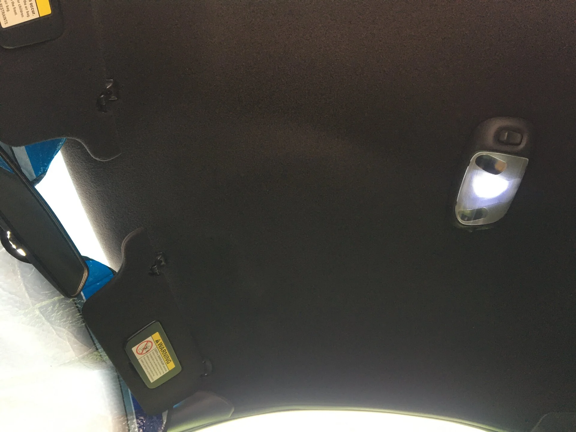

1. I got a new headliner off a older year mustang that had a pristine headliner in it. Along with that I took the mirror visors to match.

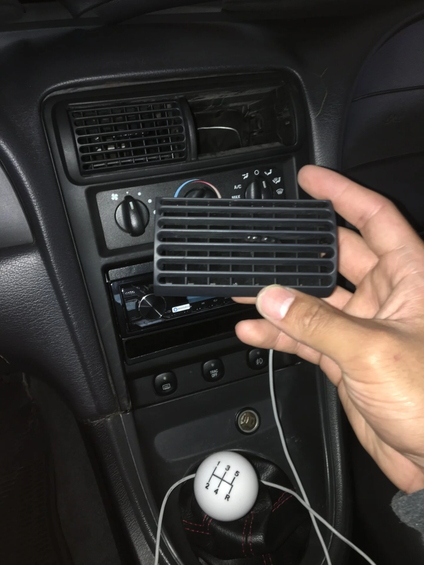

3. AC vents were cracked or broken so I took a couple of them off some wrecked mustangs in perfect condition

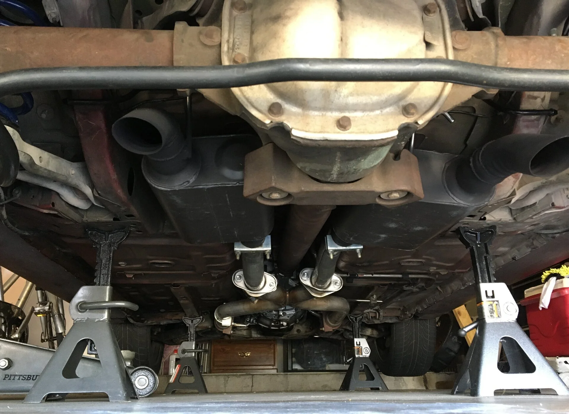

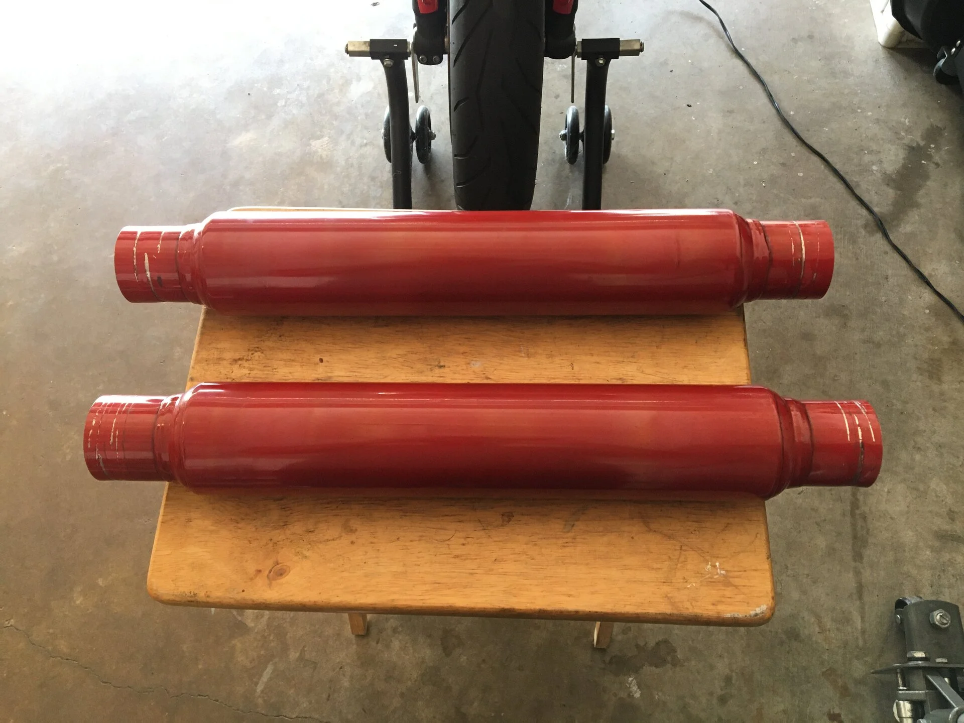

Exhaust Note:
I have been trying to find a muffler or exhaust that sounds anything but raspy. The SR performance mufflers sound good when revving/High RPM(3K+) but are quiet at idle and under 3K RPM when driving it isn't that loud in the cabin.
So far I tried the famous SLP resonators and sound good at idle and under 3K rpm but are too raspy at higher RPM.
Then I tried these cherry bomb mufflers which are the same as the SLP ones but have a V plate inside and that sounded good up until 3K RPM with full throttle
I am currently back on the SRP mufflers and waiting for a new 2 Chamber mufflers to come in on Friday to test out.

Ohh I like new to me used stock parts.
Maybe chamber mufflers with resonators? IDK lots of extra work.
I got no idea, I want just a deep rumble at low RPM which most of these exhausts do except my current one lol ...but after 3K its just too raspy or "trumpety" and I just want best of both worlds.. I even got a welder just for this and some more projects coming up later this summer!
my exhaust sounds terrible, what a waste of time haha..
new rubber insolators
made a xpipe mount
2 ebay 2 chamber mufflers
muffler hanger mounts
added down turn cut outs

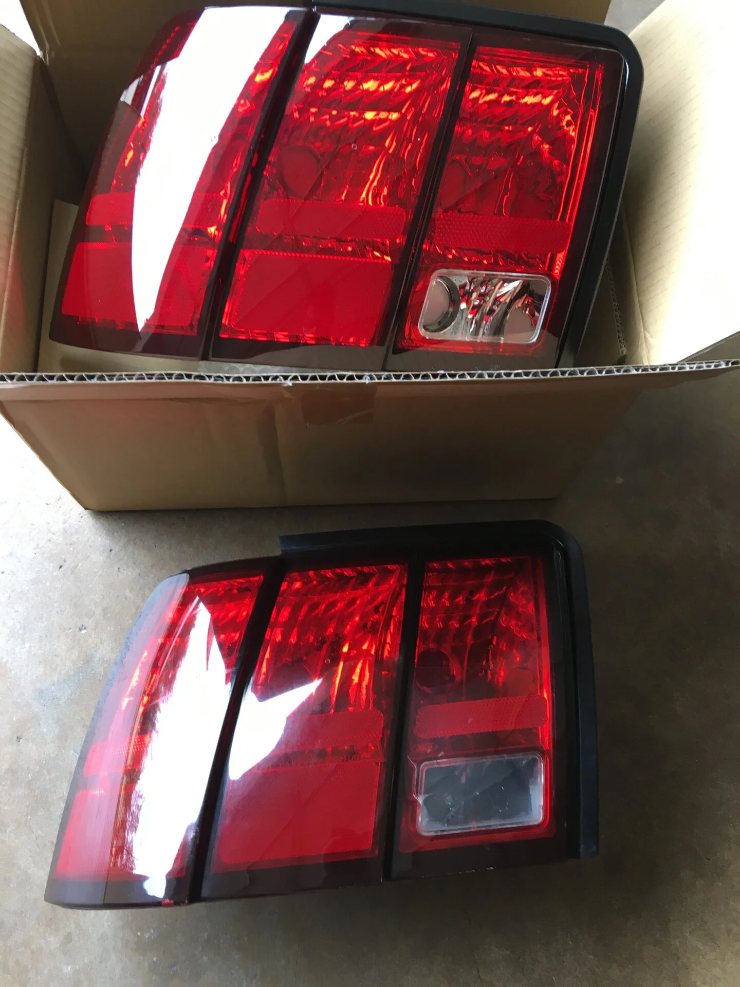

// replaced left tail light and all light bulbs
