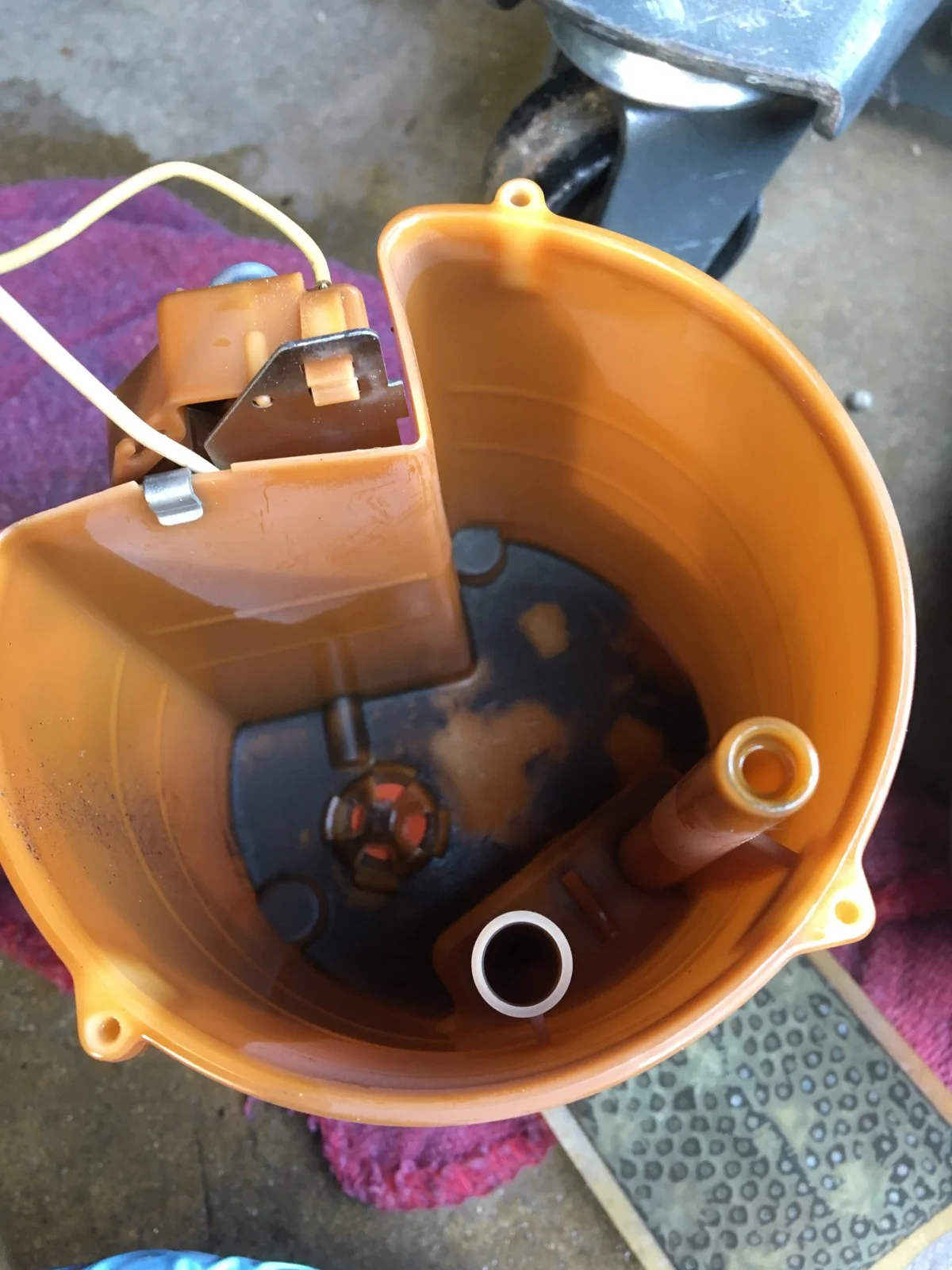

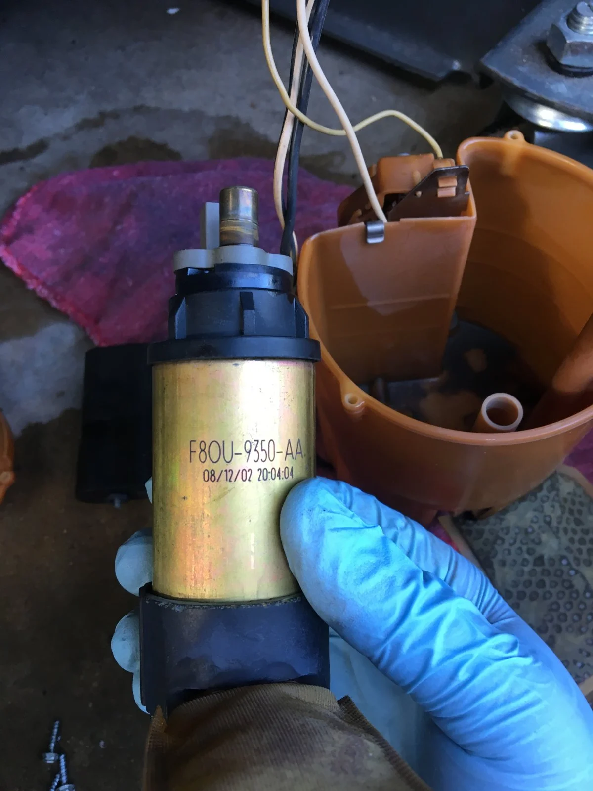

rust free gas tank

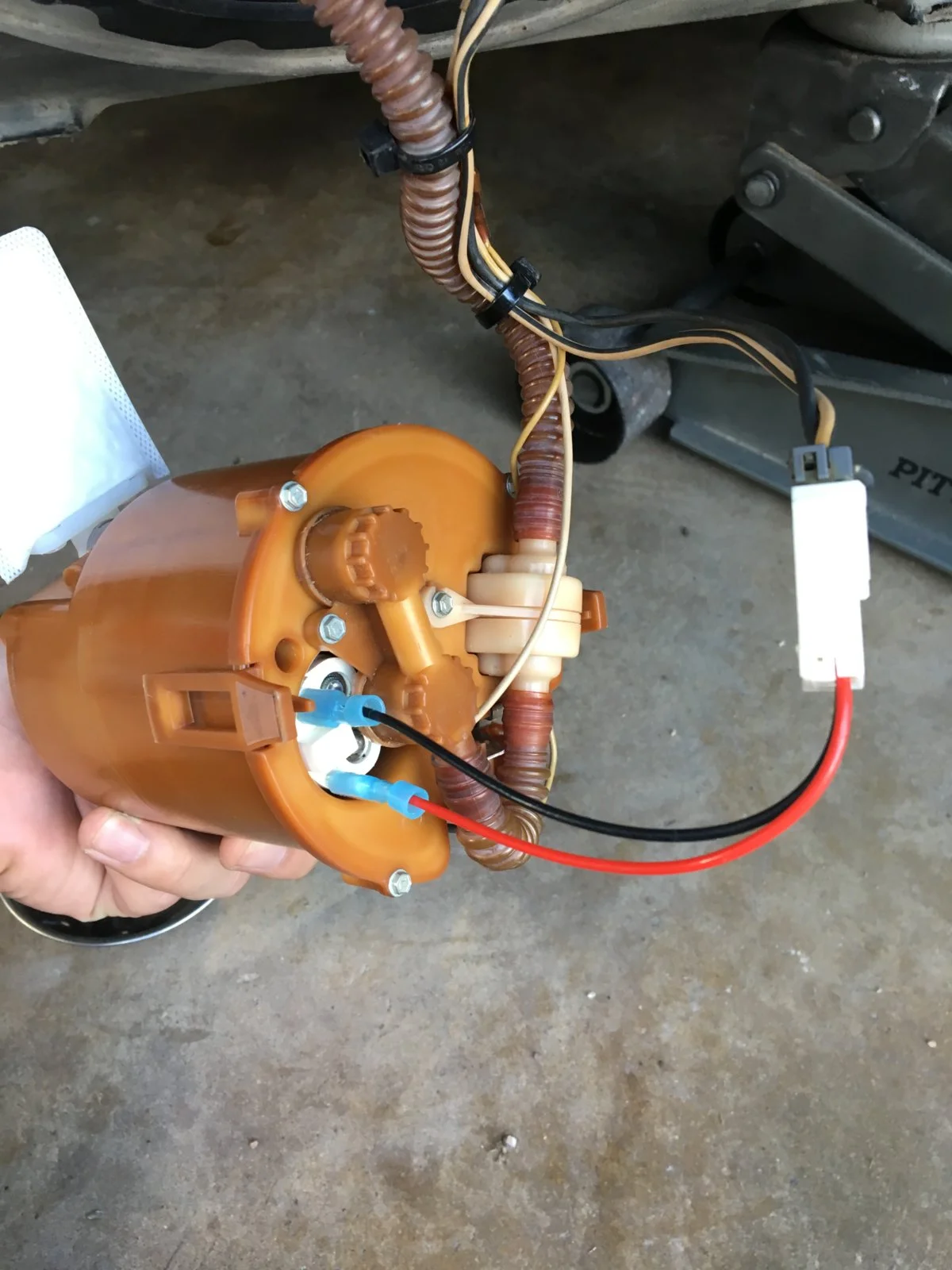

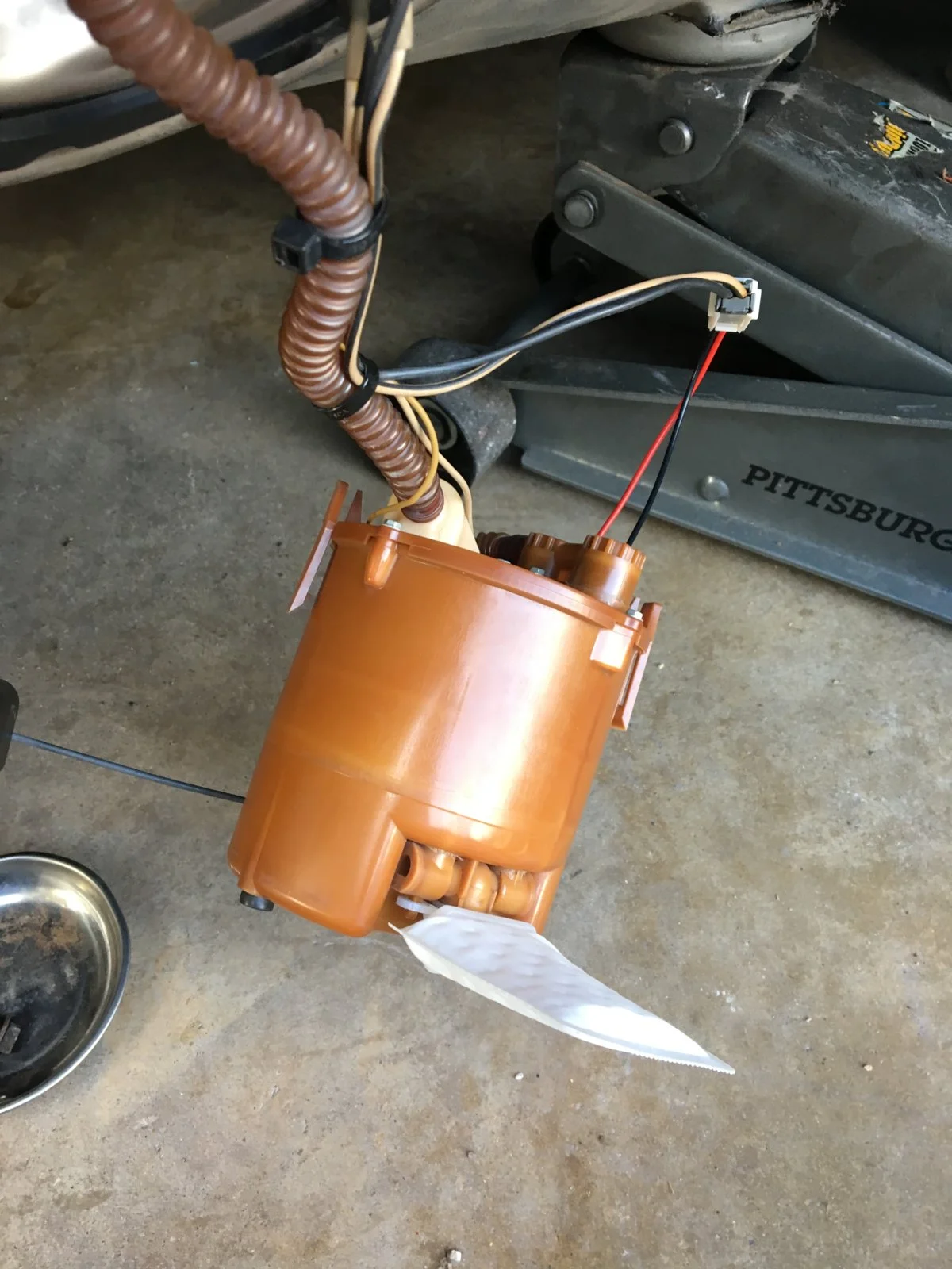

original fuel pump?
I tried my best to clean the outside before removing the top lid. I wiped the inside of the assembly down with a shop towel and cleaned everything I can reach.
I am currently waiting for the new pump to arrive... its taking the driver a bit longer then expected. I ordered a OEM replacement so I am hoping its plug and play.
rust free gas tank
original fuel pump?

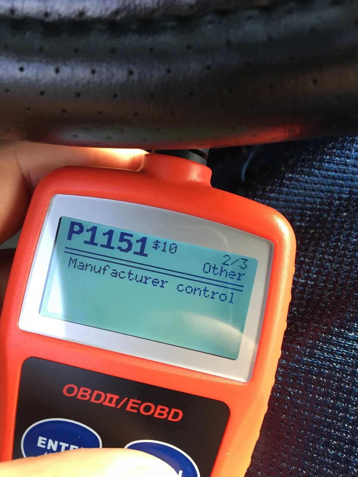

P1237 code and car doesn't want to idle. I am going to install the original pump to see if that fixes it. Don't know what the hell is wrong with this car jesus.
Had time today to reinstall the original fuel pump and the codes went away (P1151 active) so car is back to its original running state..
So that means the replacement fuel pump - Delphi FE0443 Electric Fuel Pump was not good. - returning asap

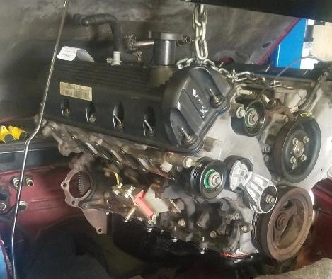

new clutch assembly
pulleys
tension-er
thermostat
belt
water pump
main/rear seals/gaskets
oil filter/oil
coolant
transmission fluid
probably missed something but engine is getting even more of a refresh again.

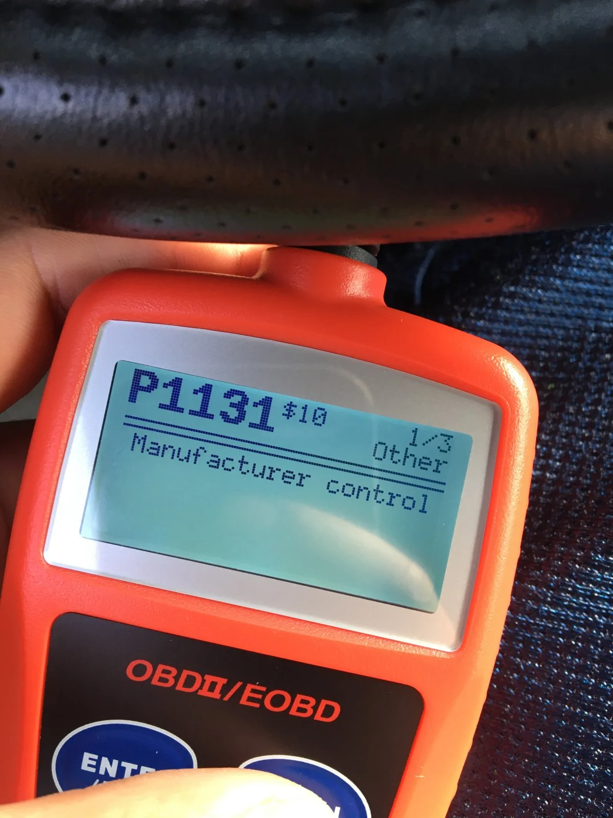

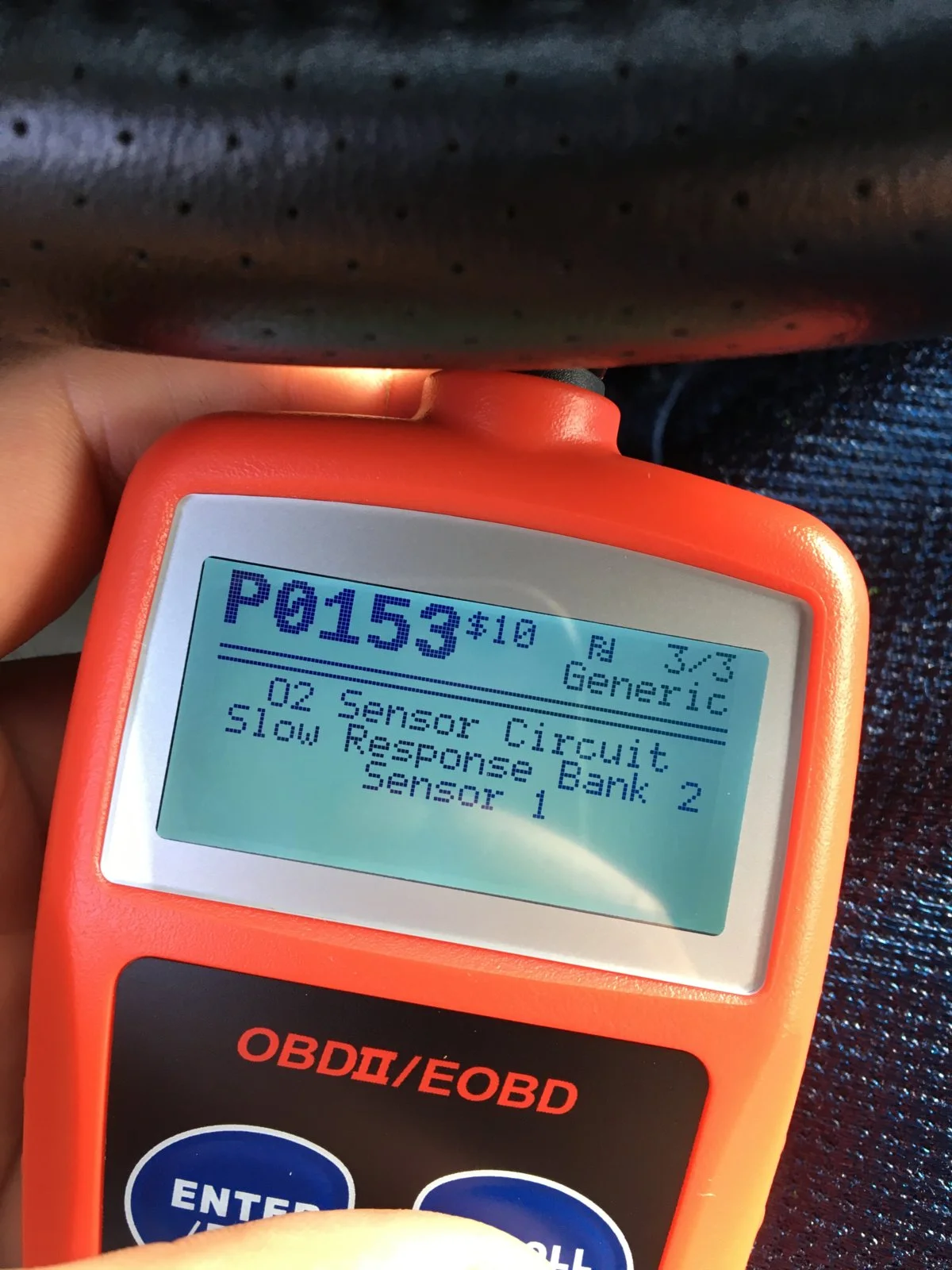

active codes after inspection are : p1151 p1131 p0153 all probably related to the long tube headers and or vacuum leak/LT headers
Iv'e been reading on this and it seems like its a common issue that I will need tuning for the long tube headers/o2 sensors to play nice and pop no codes?
Any recommendations let me know!

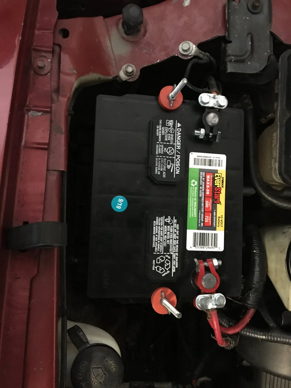

SO looking into the battery I noticed the battery wasn't the right one - at least that is from what is recommended. (not oem/oe spec replacement)
The battery was recharged and holds the charge at 12.6 so I know it is a good battery but maybe not enough juice for the mustang.
I need to test the alternator but before that I wanted to know why the battery was weak and or losing its charge so I did a parasitic draw test.

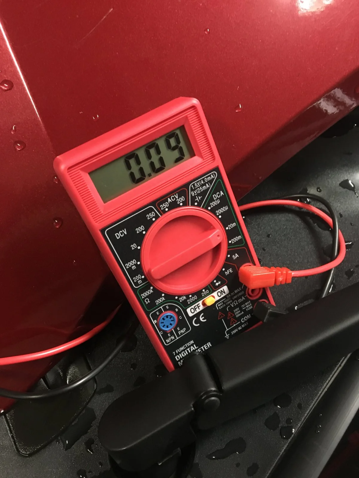

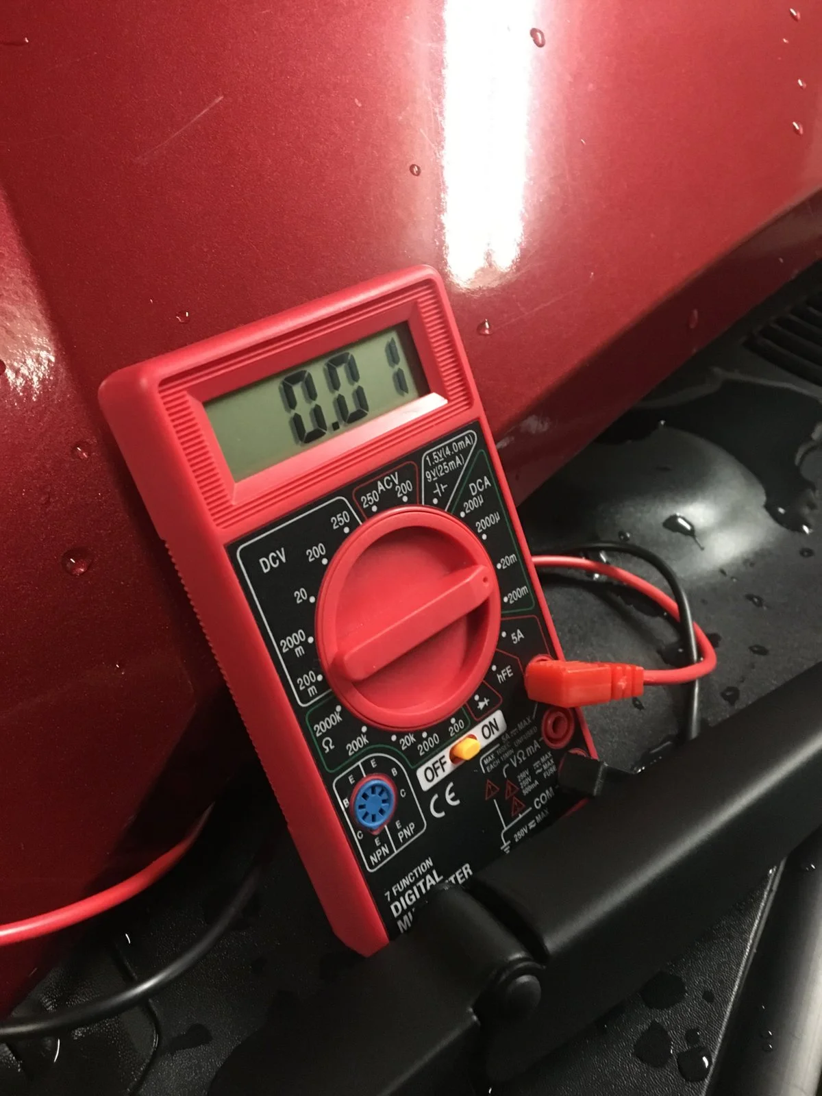

Parasitic Draw - .37a draw
F1.6 fuse was removed and that dropped it to 0.00.. which led me to test everything under that said fuse and I found out that the radio and GEM F2.39 FUSE were the issues.
They both are drawing power when car is off. So I removed the radio and it dropped the draw to .16
I let the car sit for well over a hour to see if the car would go to "sleep" but it didn't and is still pulling .16 ( doors locked / hood latch in lock position)
So now I am trying to figure out if the GEM is damaged or something it may control is. ( F1.6 FUSE I think is everything the GEM controls so It may just be the GEM itself)
Not too sure where to go from here.
GEM update - pulled the first harness connector (black one) off and it dropped to .10 and after some time dropped to 0.00 range.
So at the moment I have the car with the connector back in and waiting another hour to see if the power drops down from .15-.16 to 0.00. ( maybe I did my first test incorrectly ) probably not.
Hopefully it does if not I will have to trace what is on the black harness and see what it connects to and hopefully I can cut something useless off and be done with it.
EDIT: after writing this up I went ahead and checked and here is a picture of the amp draw going down to .09 much better then .15... going to wait a little longer and hopefully it drops to 0.00.
shortly later - it hit the 0.01 - 0.00 range. !
So good news - I think unplugging the harness off the gem helped and reconnecting it after a period of time. ( or my test was bad the first time ) DOUBT IT! :)

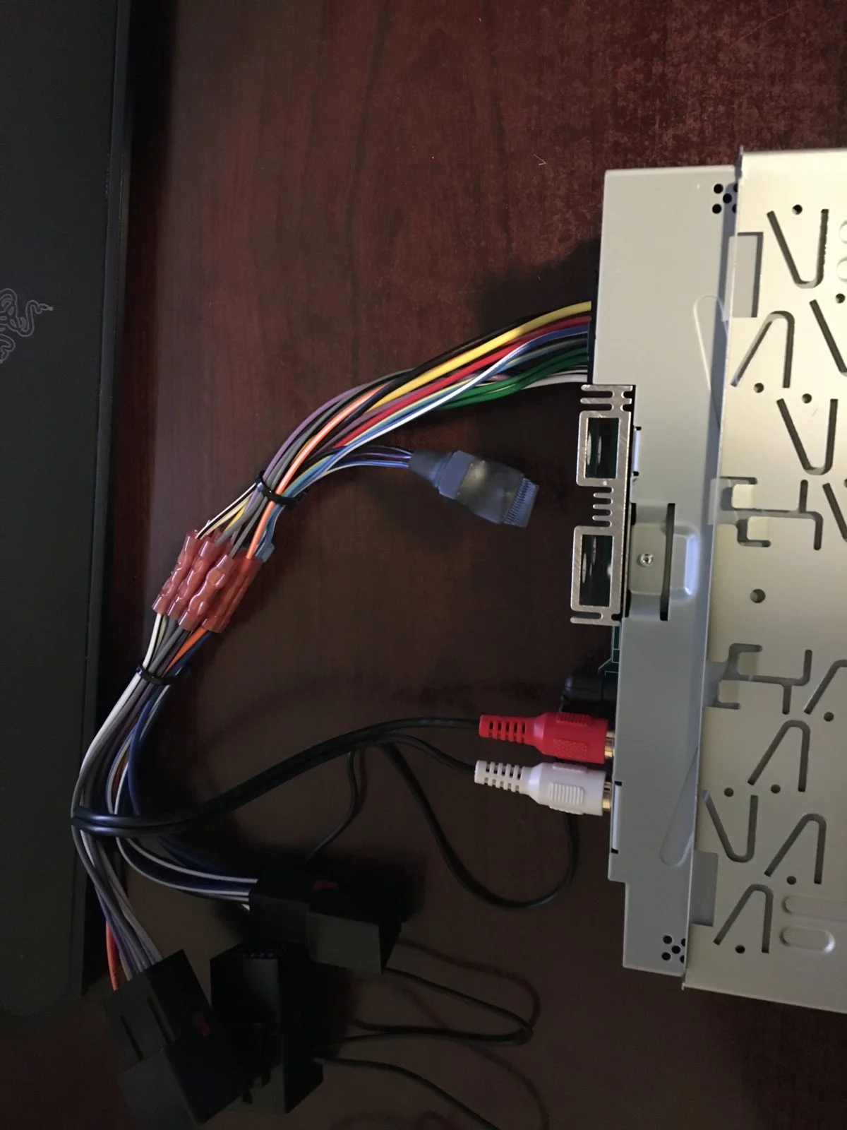

this is without the radio installed. however I think the harness on this current radio is incorrect in some way.

bigger battery installed with new terminal attachments

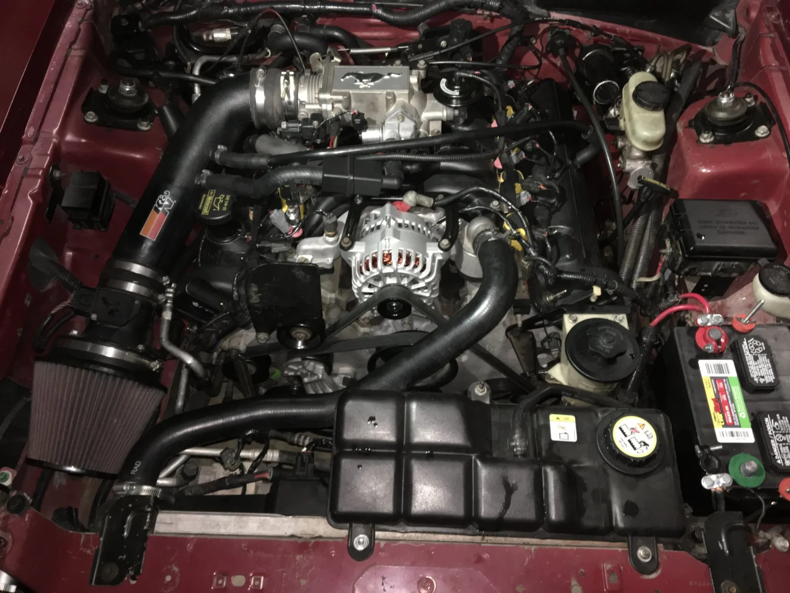

I haven't posted a picture of the car so here it goes -

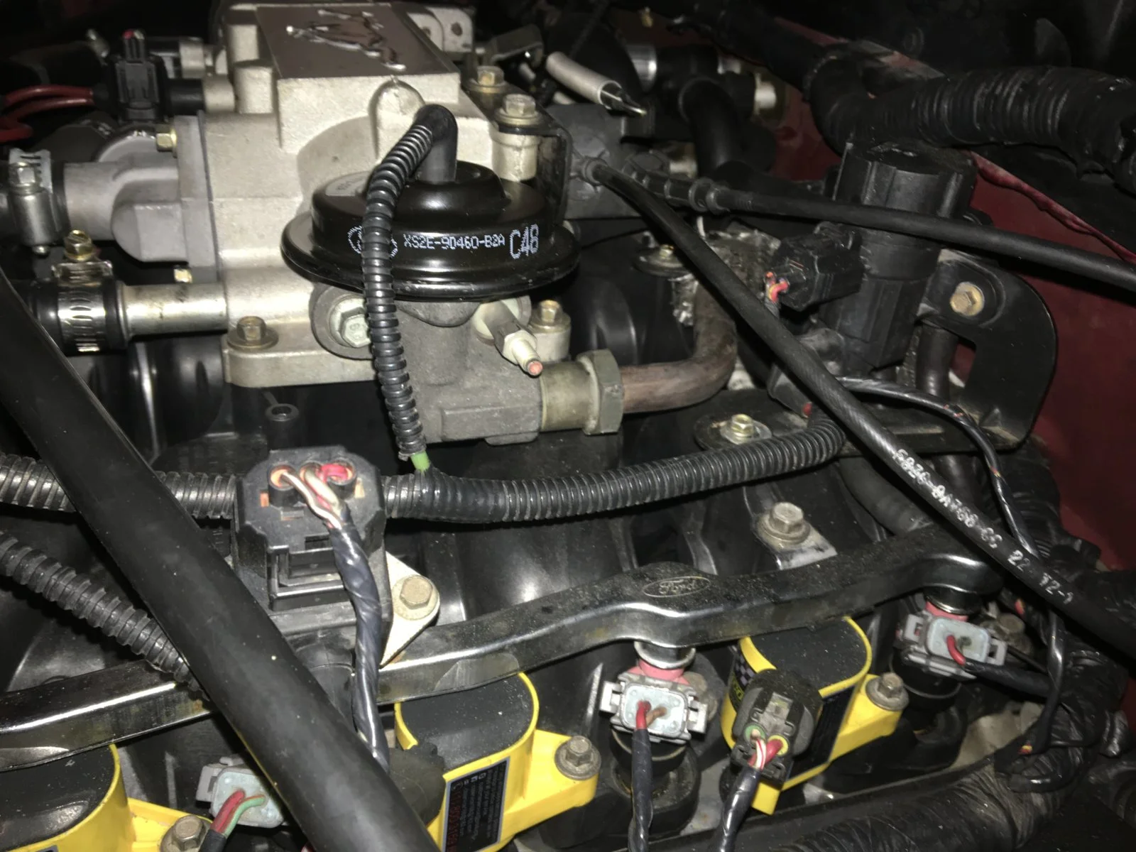

replaced the ac condenser but have not filled up with refrigerant yet.

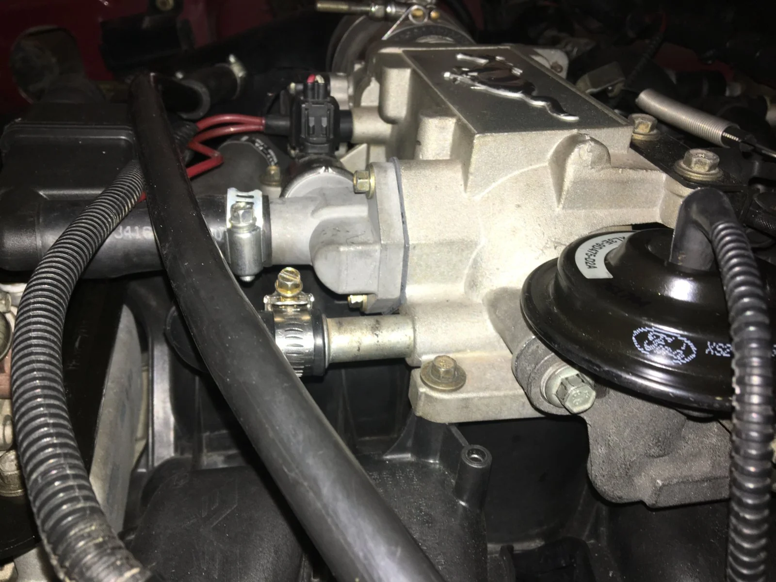

EGR Valve and gasket replaced
IAC valve gasket replaced

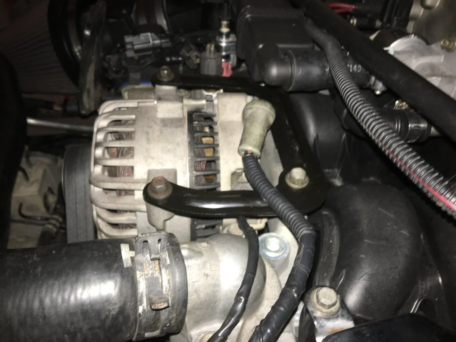

Alternator bracket installed
Also may have found a small leak in radiator - not sure I will keep a eye on it and if needed I will replace it with a new one later.
Start up after changes -
my car sounds great and idles great too. I did these replacements because I still have the 1131/1151 codes. So hoping that fixes it but probably won't because -holding in the brake pedal, I can hear the brake booster whine. Almost sure the vacuum is coming out or going in through it. I will look into replacing that asap.

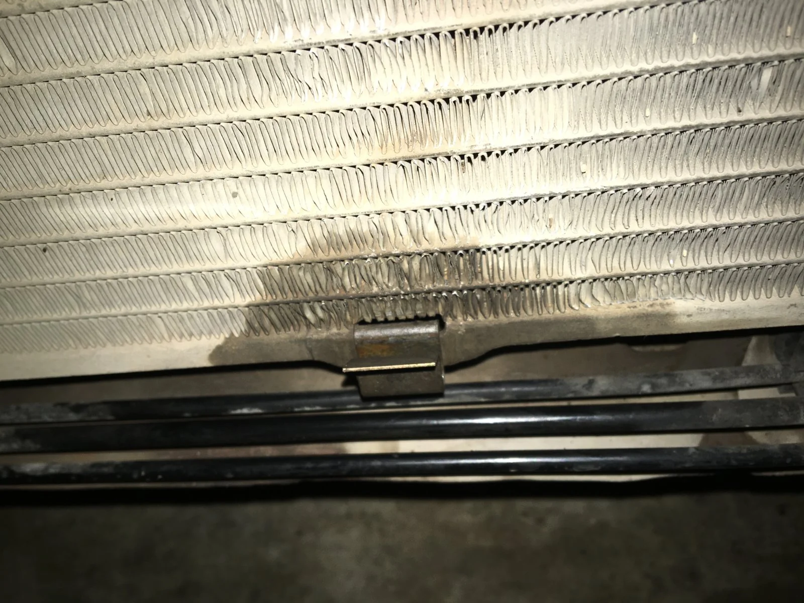

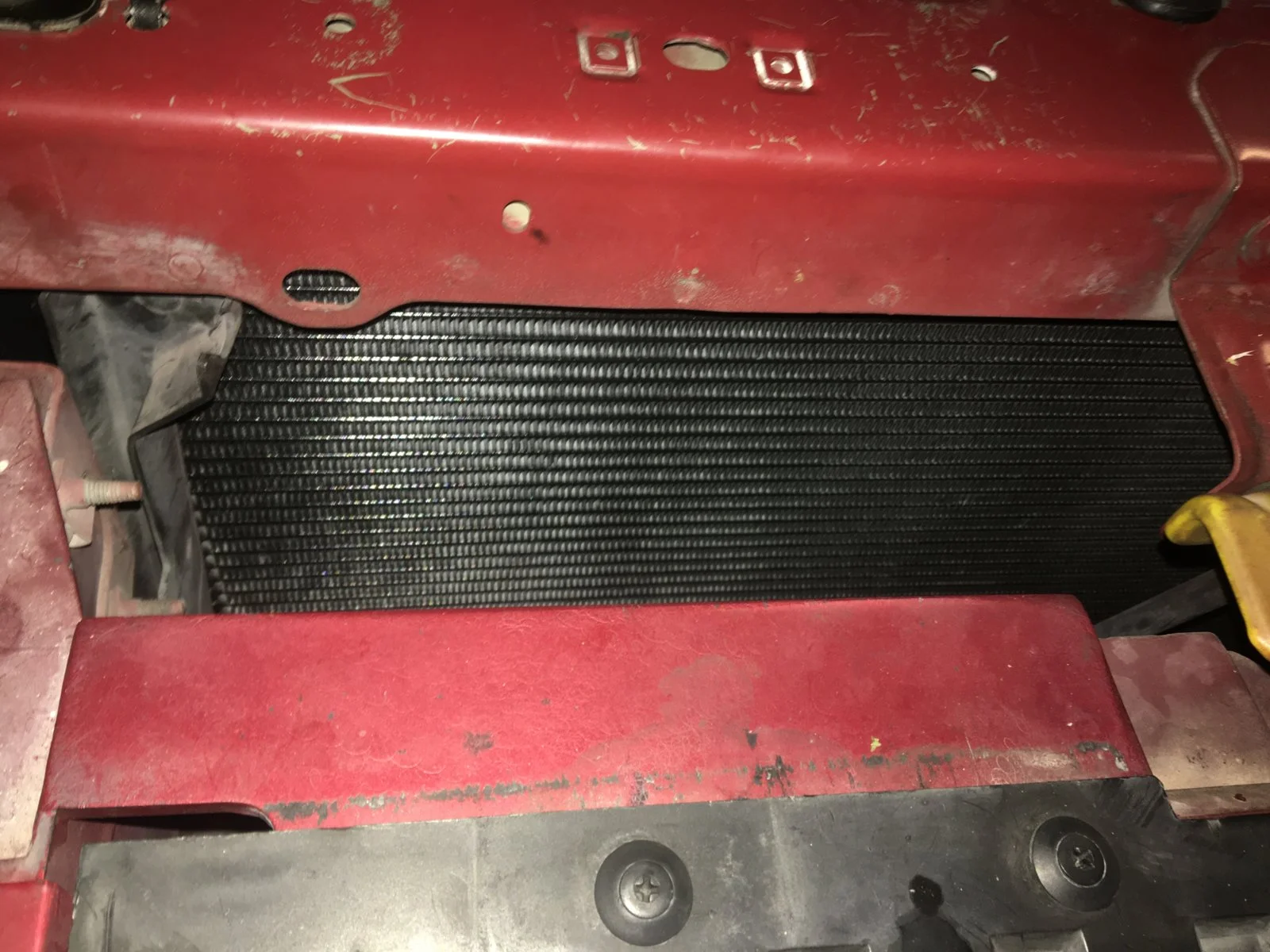

Condenser install 1999 - 2004 Mustang GT (for anyone searching)
You can remove the condenser and reinstall one without removing the radiator or draining the cooling system.
Move to the side the coolant reservoir and remove the radiator fan.
Unbolt the radiator and condenser
the wiring harness near the condenser needs to be unclipped so you can move the harness around while removing the condenser
push forward lightly on the reservoir from the top while removing the condenser
No you do not need a lot of force and this is easier with 2 people, one holding the radiator forward and the other working on the condenser
Takes 30 mins tops going very slow.
In my case the condenser leaked the ac system or it was never filled back up after engine swap.

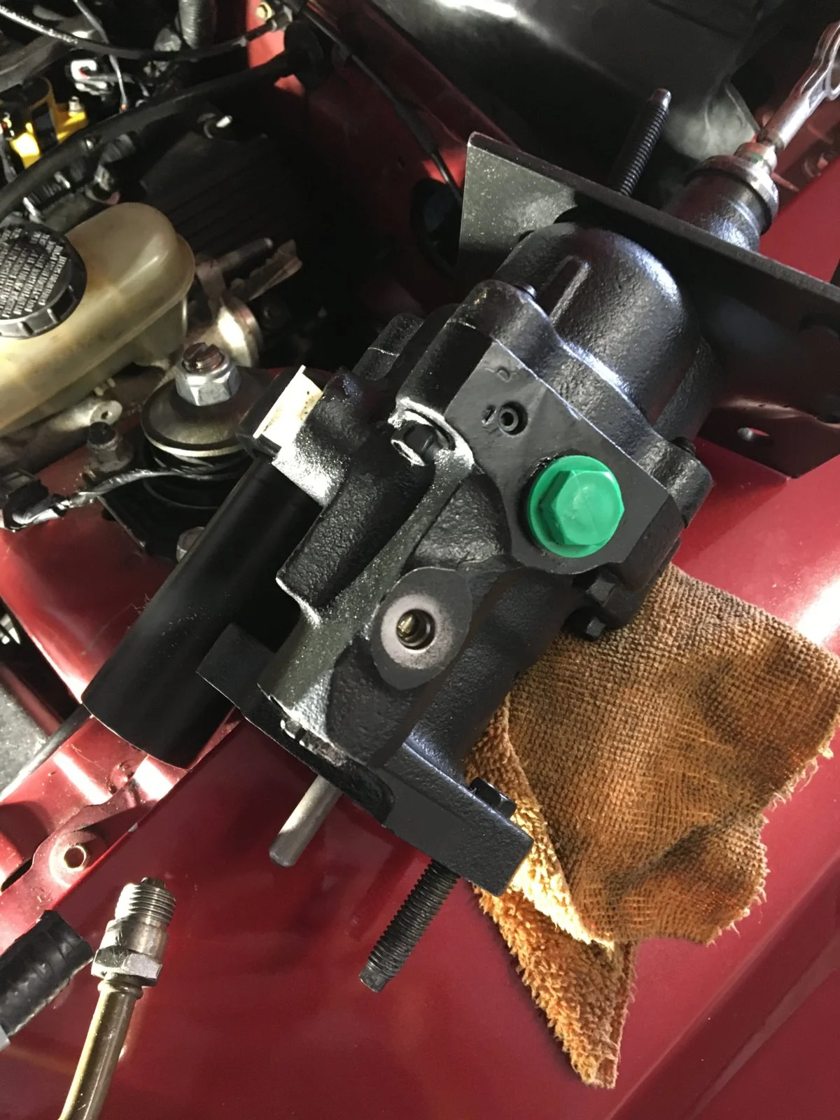

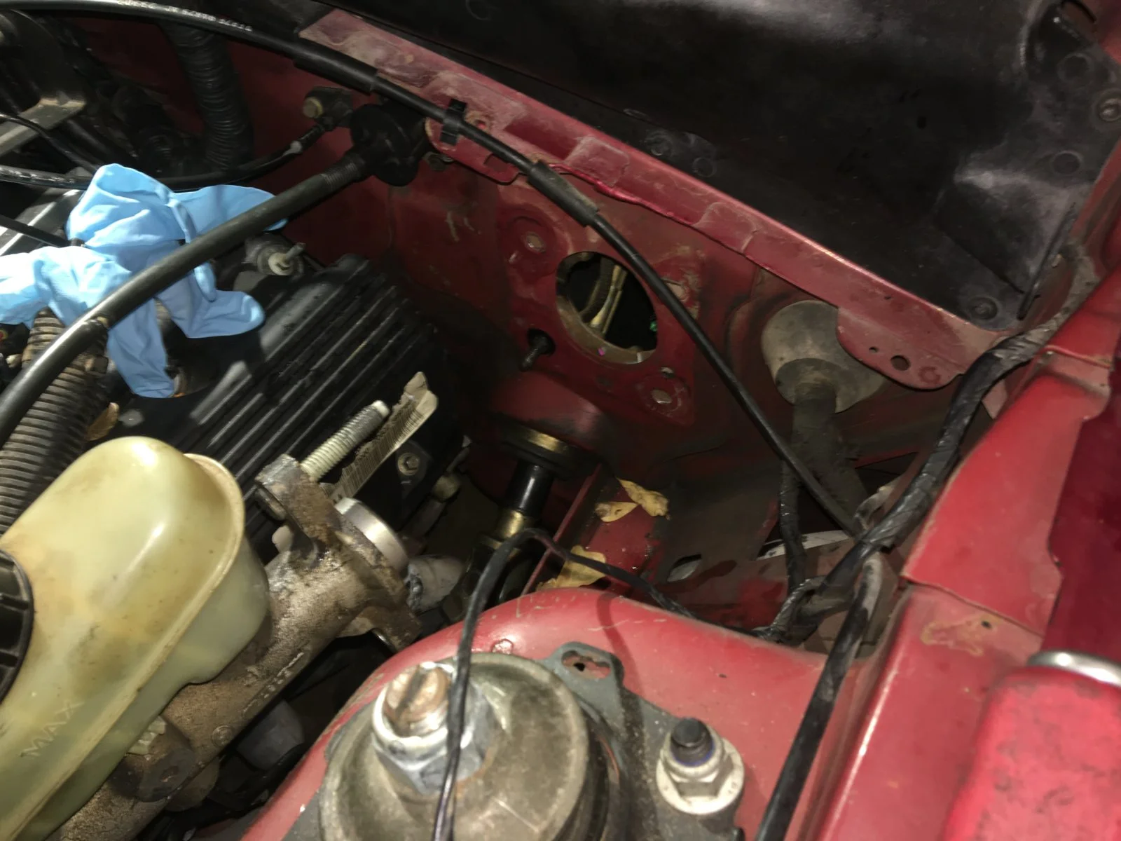

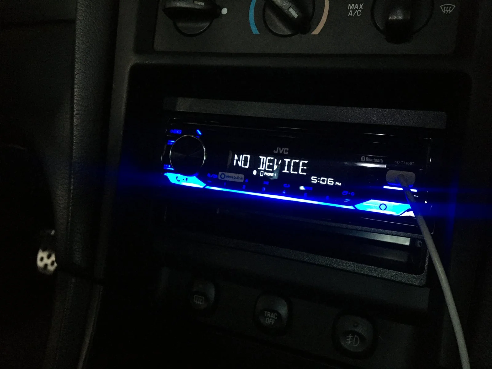

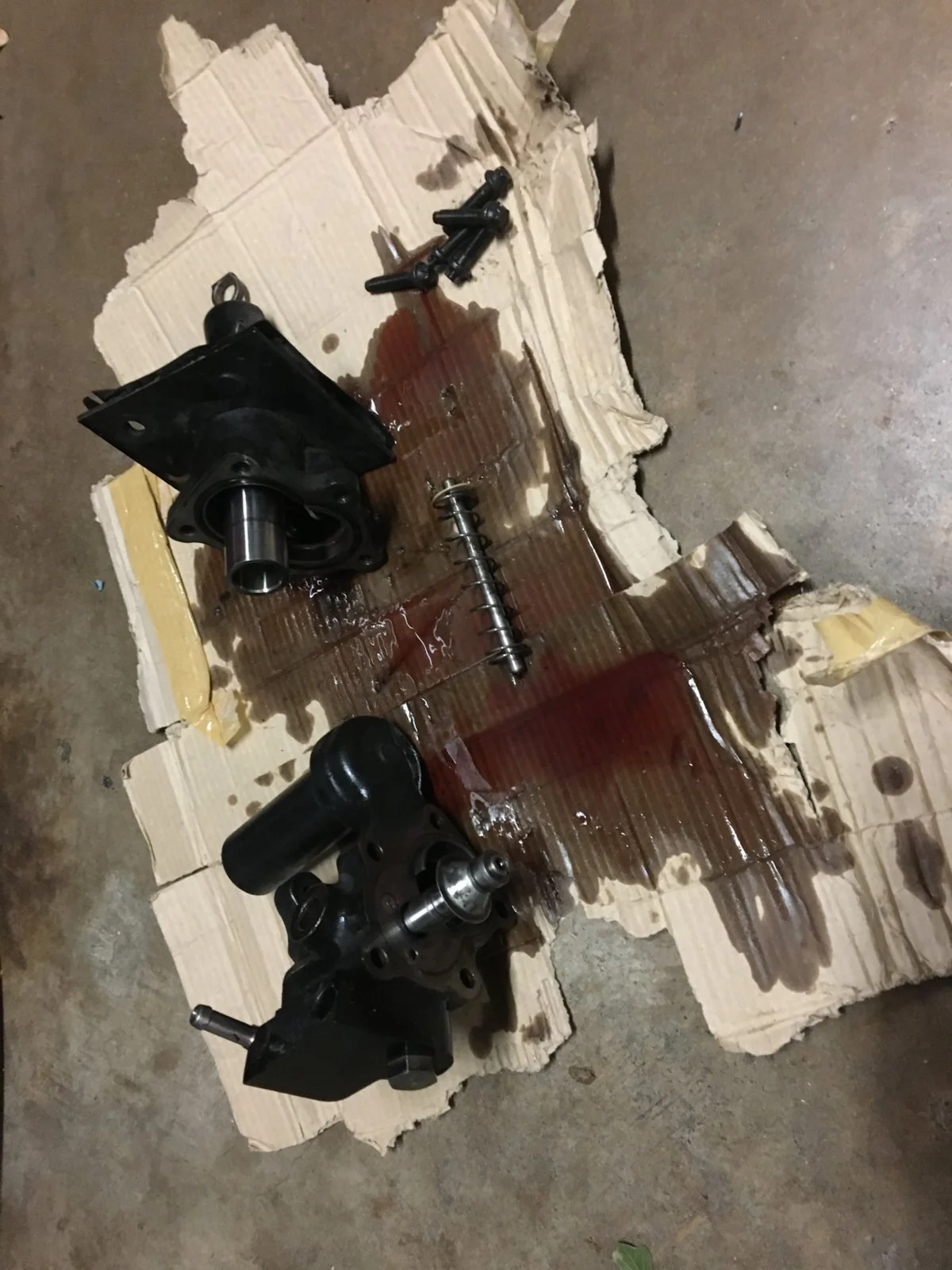

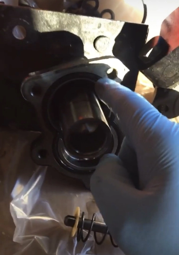

couple more changes:
1. new updated radio with new wiring harness
2. brake booster DIY rebuild
3. bled the steering system (couple bubbles)
4. no brake booster leak and no CEL p1131/p1151 //// could be fixed now because of the rebuild on the brake booster.
on the new condenser - I think there is a leak at one of the o rings, I think I only replaced 1 O ring so I will replace both later and get a shop to refill it.
Test driving this Monday to see how the brakes feel, and to see if the codes don't return. Car sounds better and much smoother when it is revved out.

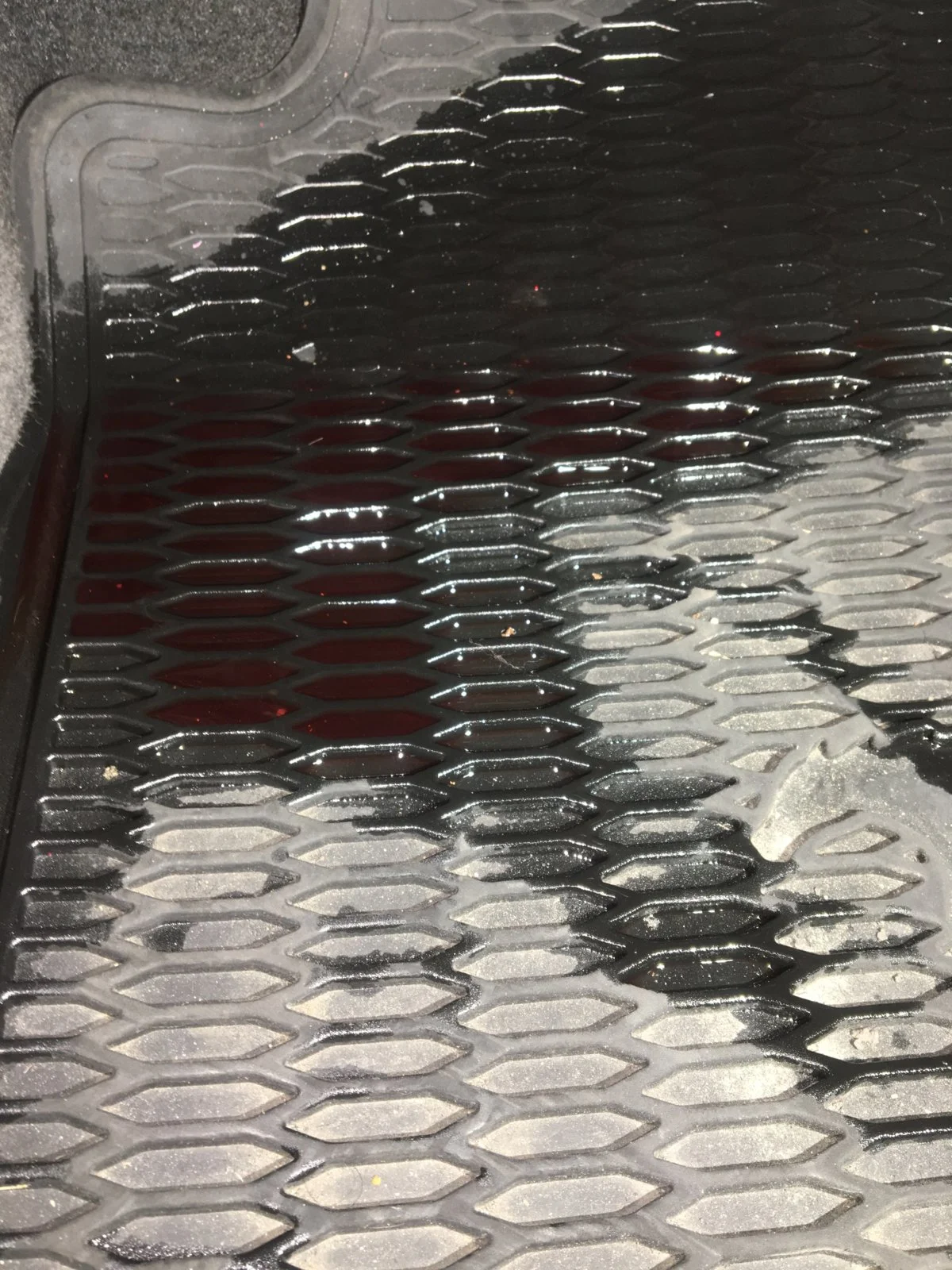

New alternator - the old one tested good but it through battery light on every once in a while so I didn't trust it.
New reman. brake booster installed like last month but today I noticed the puddle of power steering fluid... I already removed it and will be installing another replacement this afternoon.I went from having a leak in the engine bay to having one in my interior lol..
I also threw in a picture of how it sits at the moment. Pretty happy about the car. I really enjoy it. I can't wait to not have anymore issues though.
