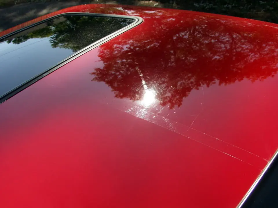

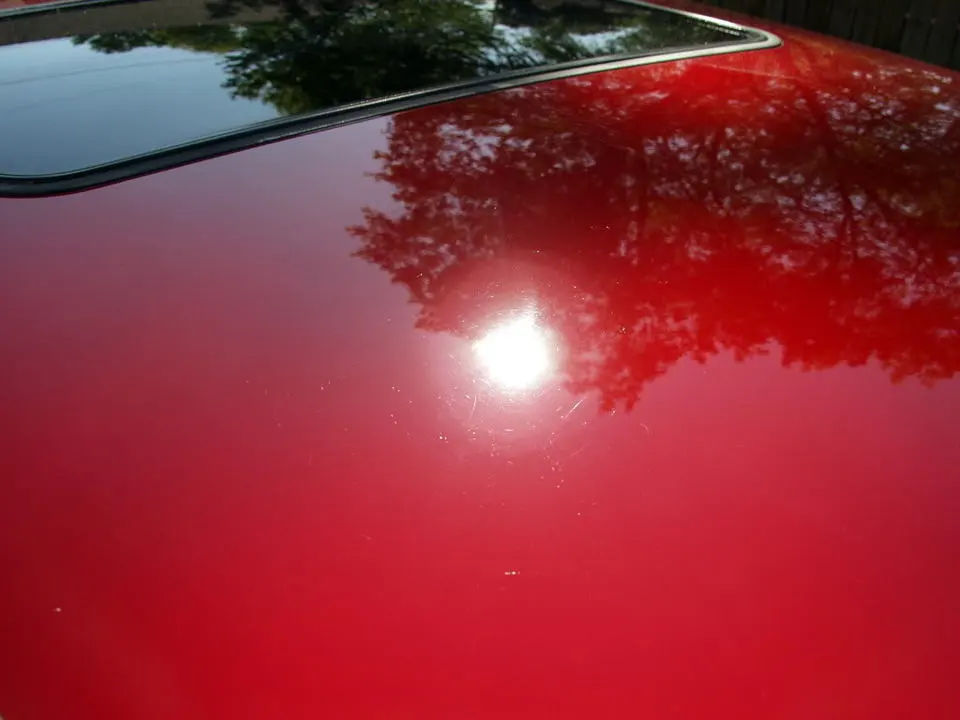

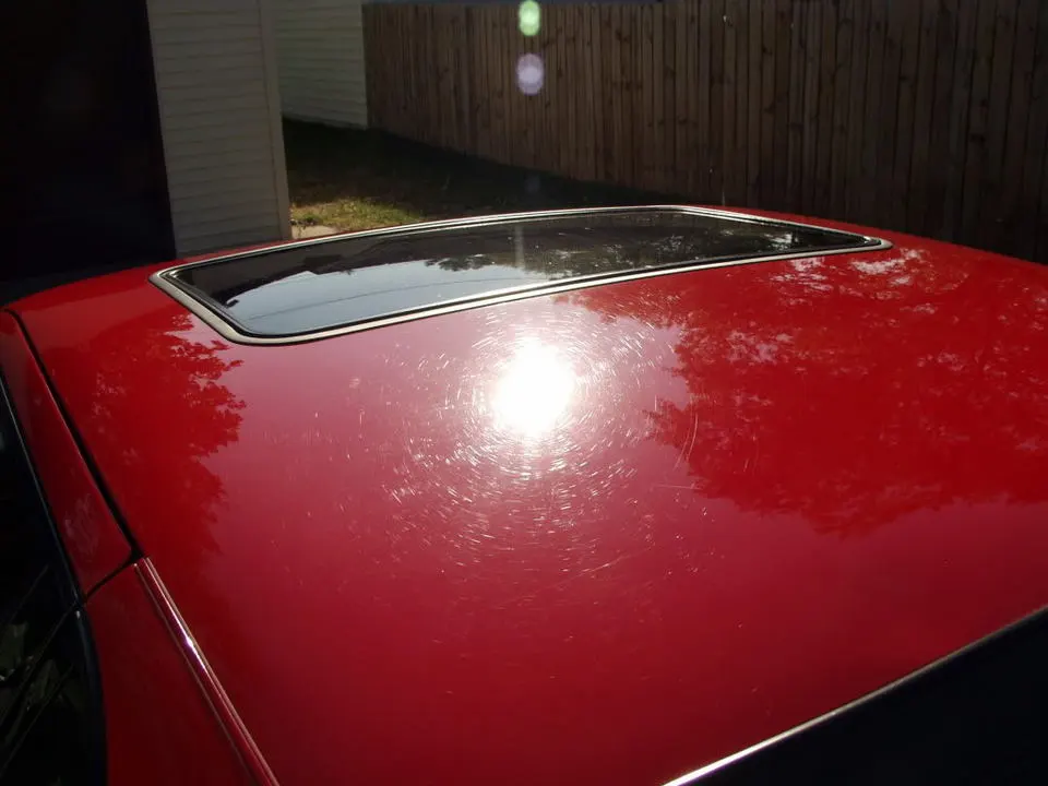

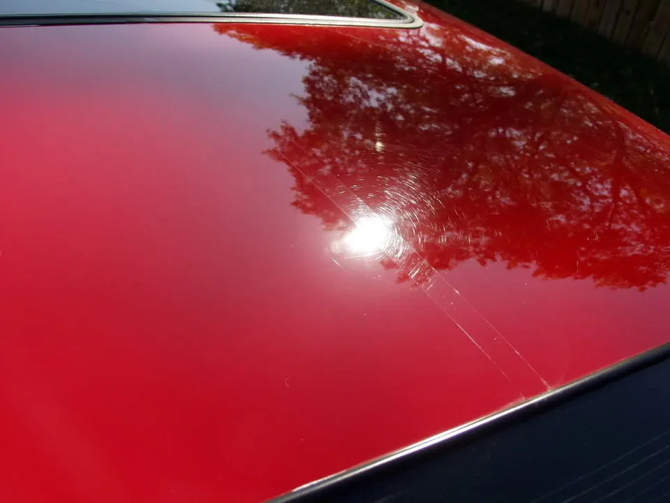

I have the PC7424 DA and also the Chicago Electric rotary, a handful of lake country pads (at least one of each: blue fine finishing, black finishing, white polishing, orange compounding, and yellow compounding), and a couple of wool bonnets. I've tried a few different compounds and polishes and I really like Menzerna products and the Meguiars M105 and M205 line. I tried the Pinnacle XMT stuff and wasn't very impressed. It seems to breakdown way too quickly and IMO doesn't finish off very well.
Here's a couple pics of my old Grand Prix GTP I detailed. I started with a wool bonnet and Menzerna power-gloss on the rotary, and finished it off with Pinnacle XMT fine swirl remover on a white polishing pad, and topped it with NXT 2.0 wax.
before:
50/50 (before the NXT 2.0 was applied)
after:
before:
after:
I think its safe to say that each person finds his/her own methods to achieve the desirable results. FWIW, this Grand Prix was my first attempt at detailing and it was a great learning experience for me. My Mustang was in much better shape than that car and I was able to refine the finish to bring out the gloss and cut down on the relatively few swirls that were present. I've also detailed a few other cars since then and I feel more confident with my approach each time I do it. If you're serious about trying to do paint correction, my recommendation is to buy a nice starter kit from one of the sites I listed above, practice on a car you don't really care too much about, and do what you can to educate yourself by reading the online paint correction tutorials that are contained in the websites I listed above. Good luck and if you have more questions don't hesitate to ask.
