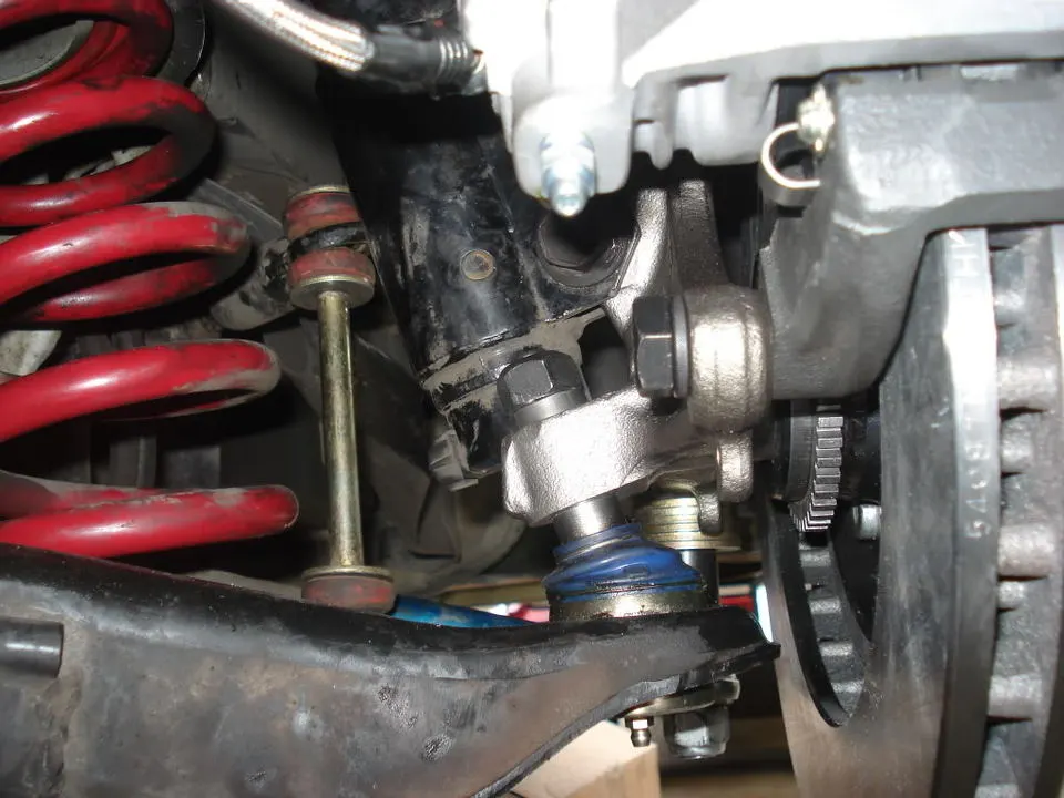

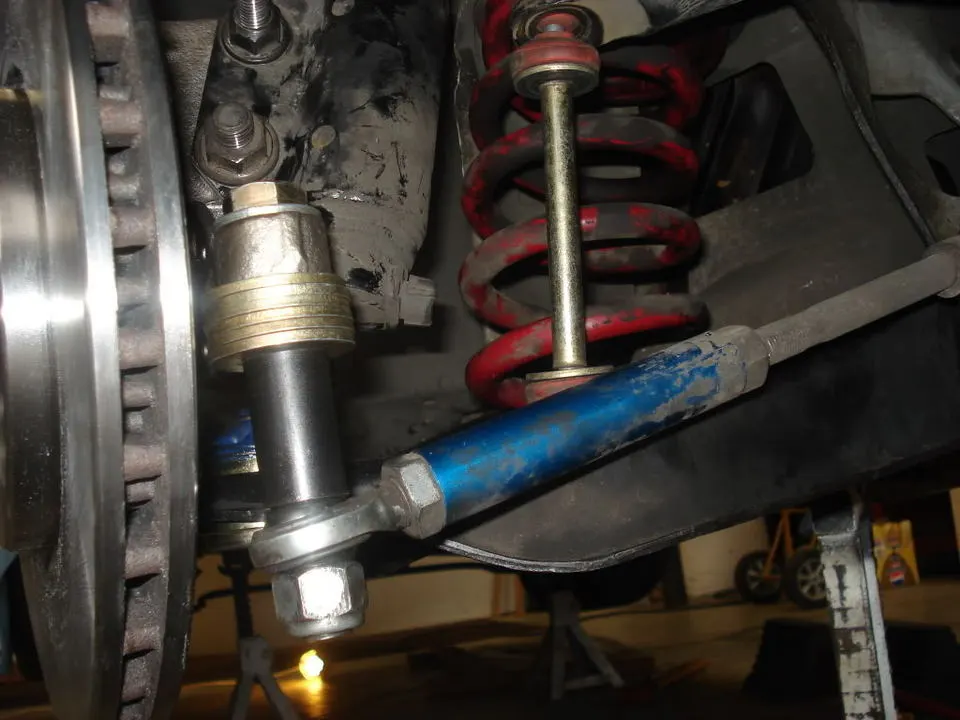

Alright so I got my dad to help me start the rear end (new axles, bearings, drums) on saturday then we managed to get the rear done and ALMOST finished the front today.
first off, thats awesome that your dad helps you do this stuff. just like 25th mustangs dad has that awesome drag fox. its nice to have some help. second off, in the first pic i quoted, what spindles are they? sn-95s right? you probably said it somewhere but i missed it, why are they so clean did you buy them new? where from if so? and the second one i think you can tighten your sway endlink some more, my trw ones dont have that gap in them.

Yea I still have the stock booster and master cylinder for now. I bought the whole kit from ssbc (stainless steel brake corporation) that came with the spindles, rotors, calipers, drums, hoses, and axles. The spindles are 96+ and they are refurbished ones which look pretty good for being remanufactured.

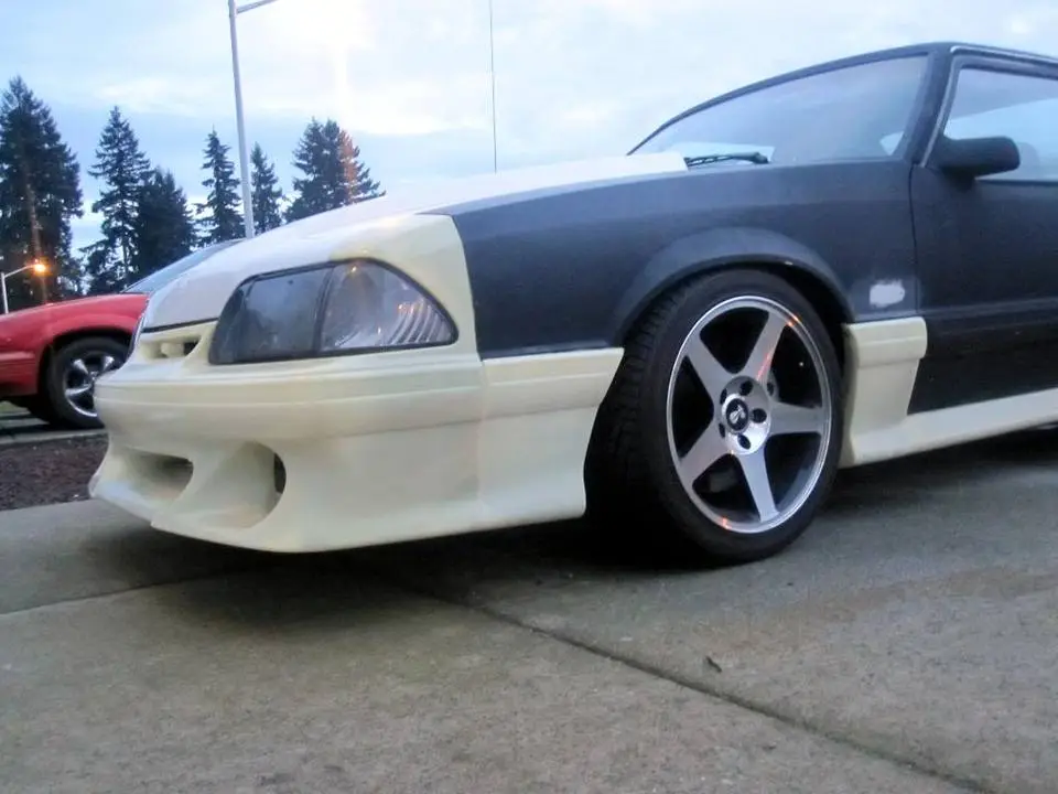

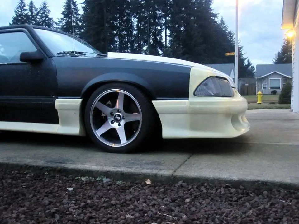

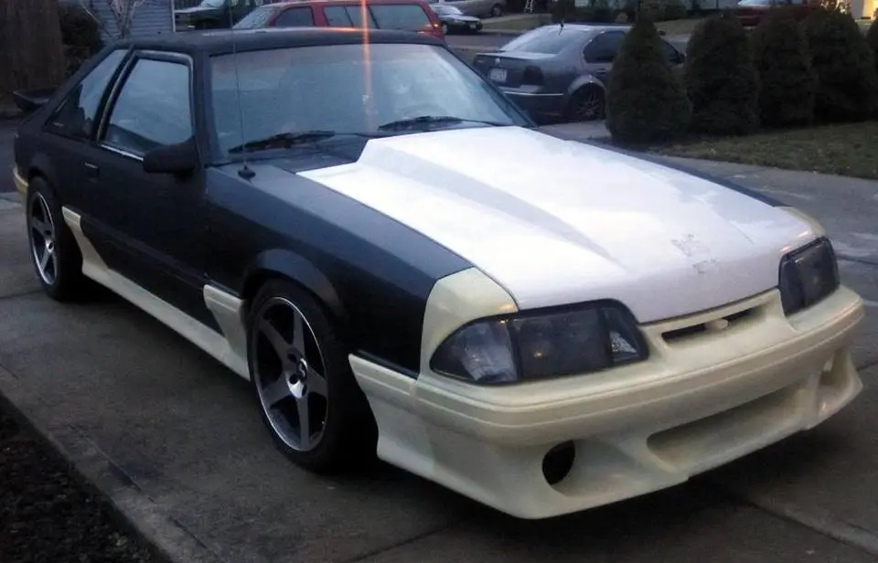

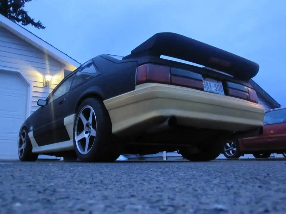

And here are a few pics how it sits as of right now ...

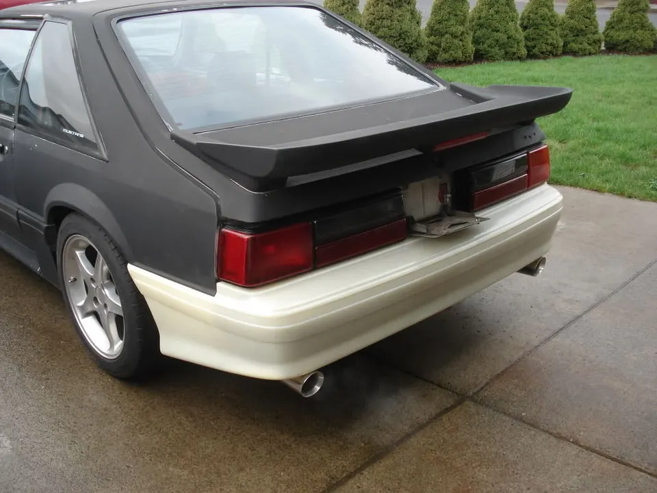

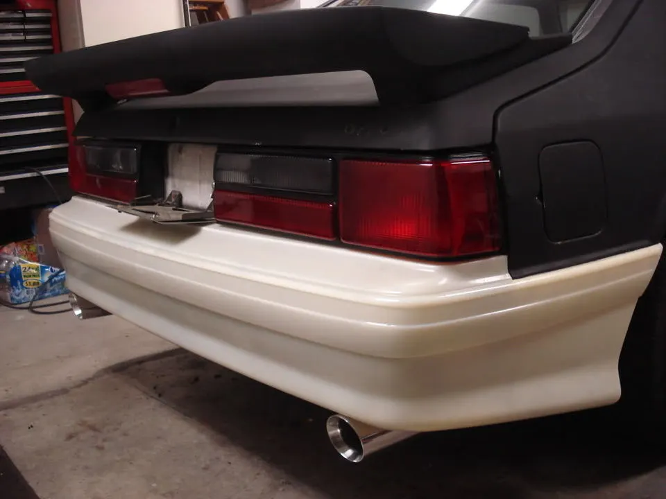

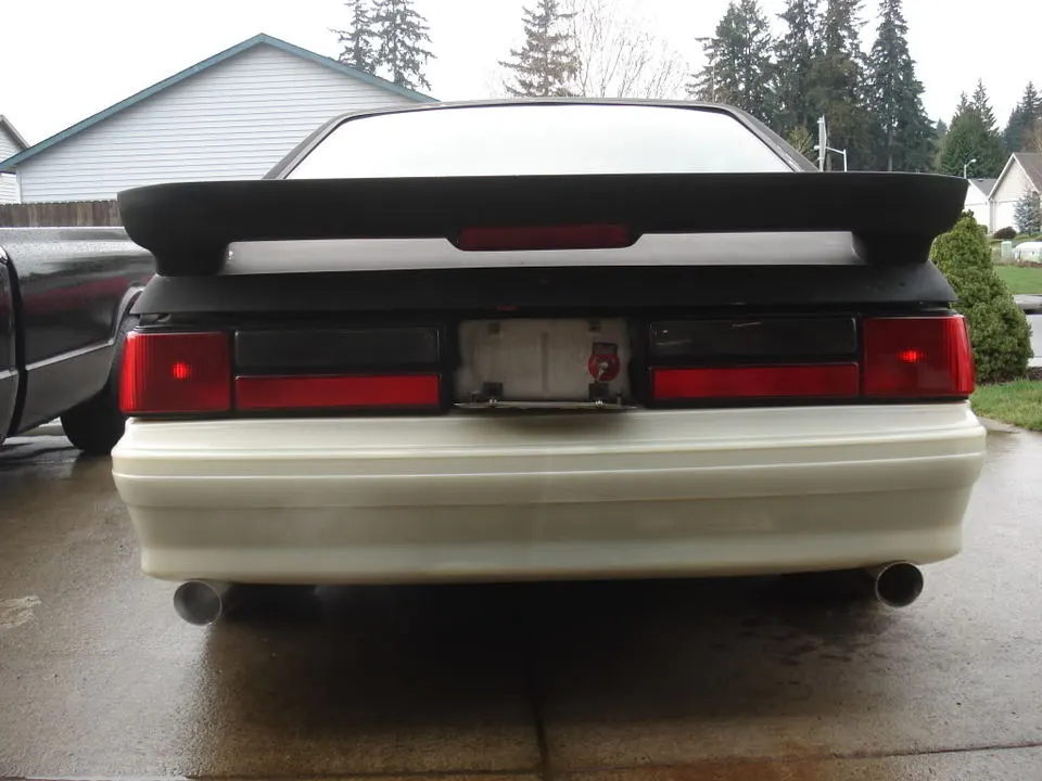

where did you find a cobra rear bumper that was 1 piece like that? or are all of them that way?

Alright guys so last nite I installed the cobra rear bumper along with the the polished tips and the lx tail light lenses.

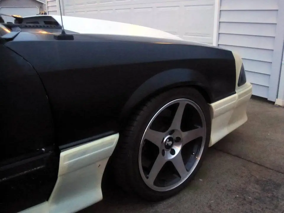

GAWD!!! That kit with that stance and those wheels looks T*TS!!!
Thank you :)

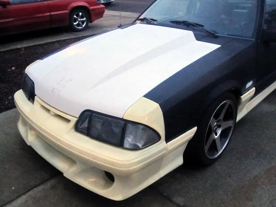

this car looks amazing and sounds awesome how much did the ground effect kit cost
Thanks, I got the kit from cervinis about 3 years ago and total with the hood was about 2k.
is cervinis the only ones that make the one piece rear bumper? car looks sick man, cant wait to ee it painted
There are a few companys out there that make them like abc exclusive but from what I've heard and researched the cervinis piece is a quality piece with great fitment as well thats why I went with this brand so I wouldnt have to buy something twice. Just get it the first time and never look back :nice:
