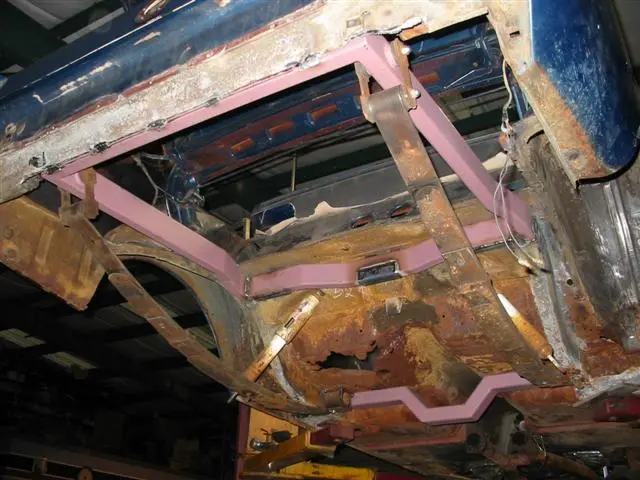

We relocated the leaf springs on my 'vert. Good bit of fabrication involved, but with the power this engine will have, we needed PLENTY of rubber.
Here is a construction picture: http://forums.stangnet.com/attachment.php?attachmentid=37453&stc=1
And yeah, this car had a LOT of rust!!!
But, once all is said and done:
*331 Forged stroker
*AFR heads
*BIG blower cam
*Kenne Bell @ 12 psi
*HEAVILY ported GT-40 manifold
*little shot of giggle gas [just to cool it off!]
=> I will need TRACTION! And more structural steel underneath to keep this beast from turning itself into a pretzel.
