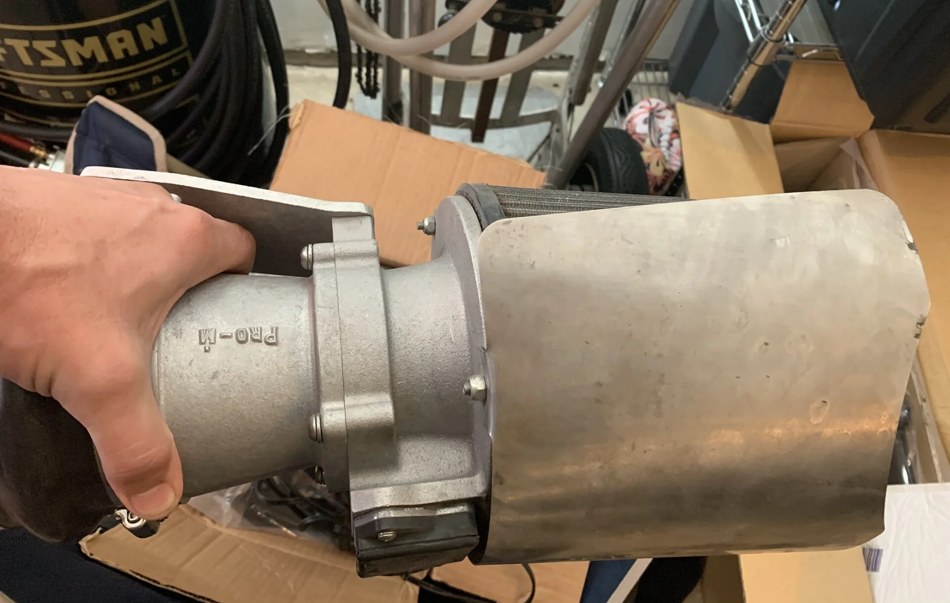

Engine Do they make a shield for SCT MAF filters like Pro-M here?
I looked around and find nothing. My tuner wants me to use SCT MAF. I really can’t find a ideal set up for open fender well. Not many filters at all also. Any ideas would be helpful. Also what are some of the filters being used currently? All I could find was Anderson one. Thanks

A splash guard for a CAI filter is probably a good idea. I bet it would be easy enough to make a shield and clamp it on with another dryer vent size hose clamp. Are you any good with tin snips?
What is the setup that needs tuned?
You could possible adapt the maf to a stock airbox, that is a cold air intake, or find/make a flange to bolt to the maf that can be used to get the filter inside the fender well.
My current Pro-M has a flange, I don't see a lot of pictures of these SCT MAFs or plumbing. If you recall the old March air Ram systems used a cold air box setup also. Still trying to figure out how not to cut a hole in my inner fender. Just trying to play catch up for what I missed last 15 years. Seems like larger injectors on the street and tuning has come a long way.
