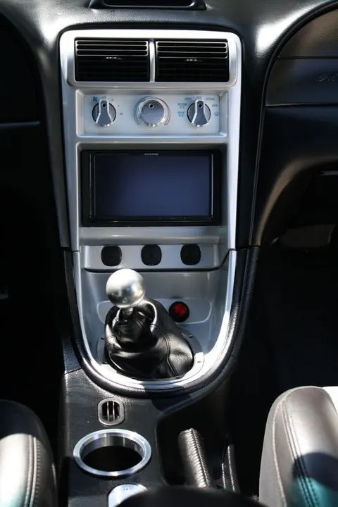

Double Din DVD is in!!! Painted 03 dash/console.. Done
turbogt
May 1, 2003
723
Montana
Here you go :)

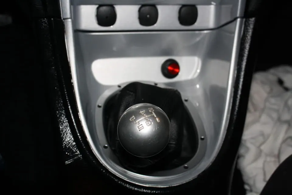

Its pretty much done, but I'm waiting on my custom itilian leather parking brake and shifter boots.. they will be black with silver thread..
I'm also having stickers made for the boost retard knob which has been relocated to the shifter bezel..

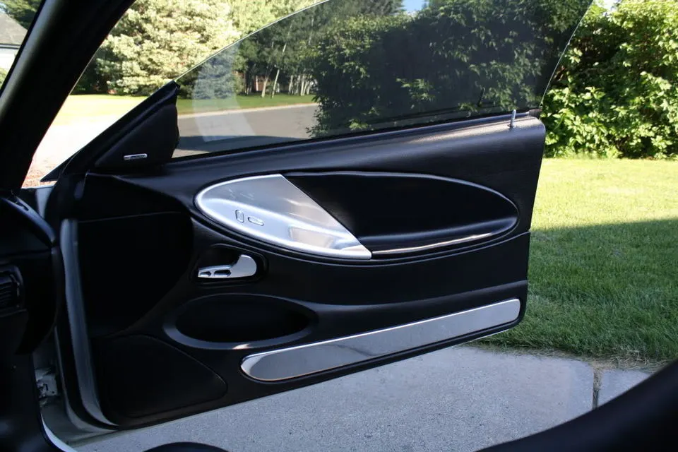

I've always really liked your ride. I keep meaning to ask about the inner door handles. I love those things. I probably don't want to ask about them (they look $$).
looks great:nice:
Hissin,i like those door handles aswell.
look like the ones from american muscle,$140.
SHR Chrome Billet Door Handles (94-04) at AmericanMuscle.com - Free Shipping!
I bought mine from upr.. they are the satin ones, along with everything else in the car... the satin stuff looks super shiny in the pictures, but is softer looking in person...
I'd wanted those doorhandles even when I had my first mustang, but could never fork out the dough for them..
They are one of my favorite mods to the interior, but are a drop in the bucket compared to how much everything else has costed....
LOL!
atleast we now know that console fits nice and snug with no fitment issues... what was used to paint/dye the center console?
I have bought three cans of vinyl paint and one can of vinyl dye from latemodel restoration...
NONE OF THEM MATCHED.. they were all too gray and not black enough, which really made me mad... They were supposed to be perfect matches for our interior..
So I went to the carquest paint shop and had them mix it on site for me..

This is pretty much what I'd like to treat my steed to, did you use the entire '03 dash or just the bezel, etc for the radio? Did you use '03 seats and the center console also?
Thanks for posting that, it's time to update my pony as well :)!

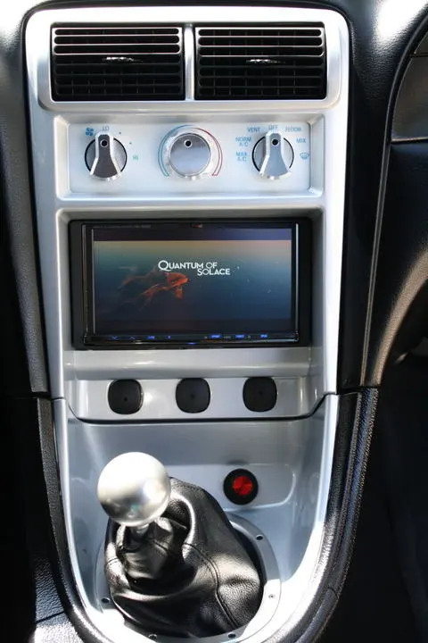

The Dash is original..
The Seats, AC Bezel, Shifter Bezel, and Console are all 03 Parts...
Using an 03 Dash in a 95 does leave you some radio mounting problems..
I had to fiberglass the mounting kit to the ac bezel, and then built a support for it to rest on when it is in the dash since the dvd player is so heavy...
Worked like a charm:D
