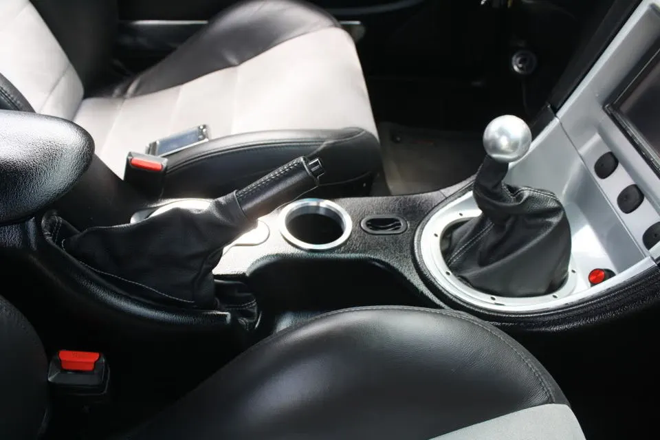

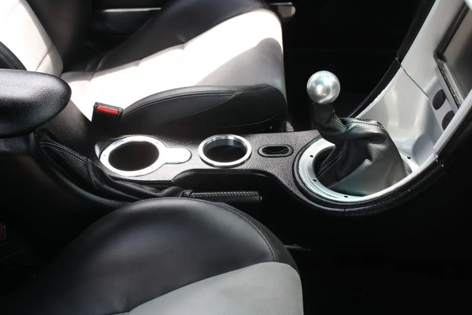

Double Din DVD is in!!! Painted 03 dash/console.. Done

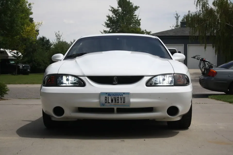

8k HID's

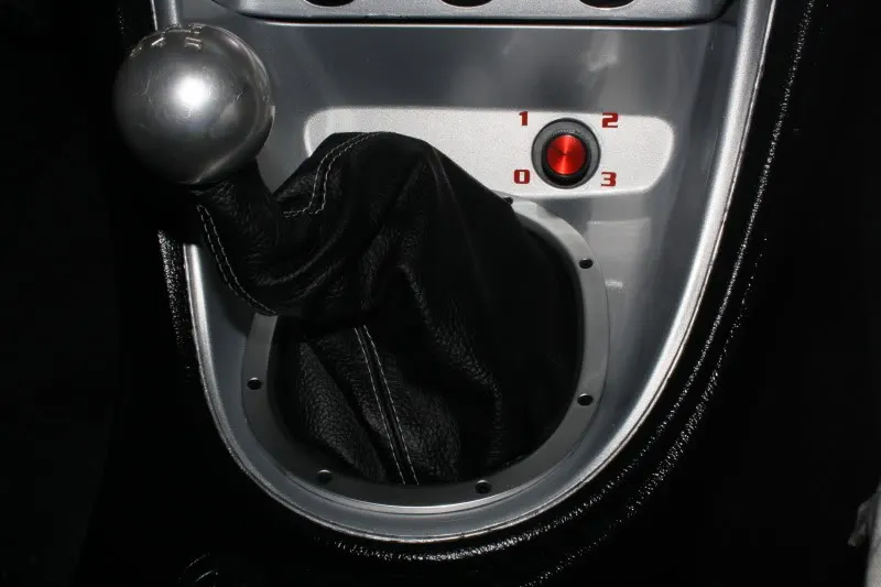

Dude, you have put some good effort and cash into your car. Its one of my favorite cars of our years for sure. The interior looks second to none, with the exception of the upside down bullitt knob. Get a dab of thread locker and let it dry overnight in the right position. I did that with mine, and was still able to break it loose when I replaced my boot.
Thanks man.. The knob is now straight.. Those first few pics were taken when the console still needed to be removed a few more times, so I wasn't concerned how the knob was sitting :nice: Notice in the last few pics it is straight...

Had the numbers made for the boost timing module...
I think it turned out good... Although I'm almost contemplating having them made in Black.. I don't know if the red stands out too much for me...
I would go with black on the boost numbers personally. I think it would blend a little better. Nice work with the shift knob, I wondered why you would leave it upside down when the rest of your car is so nice and detailed! Do you already have a taker for your old cobra bumper? If not, PM me about it.
I think I agree.. I'll have some black ones made up for me..

As for the front bumper, I have a friend thats almost local that has a white 95 GT who would love to have it..
Shipping big stuff like that really sucks...

any more details on how you mounted the radio? I will be doing this....i've had the dash for a while. Will probably get the radio this winter sometime.
It took some fabrication but overall was really easy..
I used a BEST KITS FMK554 Double Din mounting bracket..
I then centered it in the ac bezel (out of car) and glued it to the bezel..
once I was happy with how it was centered and level, I fiberglassed the mounting kit to the bezel.. I put about two layers of glass weave all the way around..
Sorry, I did not take pictures..
Once I mounted the Alpine in the mounting kit using the iso screws on the sides, I took some flatbar and bent it to at a 90 degree angle and then mounted it to the horizontal metal support in the dash that the original ac bezel used to attach to... after about 2 tries just using guess and check, I got my alpine to rest firmly on it after sliding it into place...
thats it. it all fits tight..
The shifter bezel is hard to get in, but once you snap it in, it locks the dash bezel into place..
