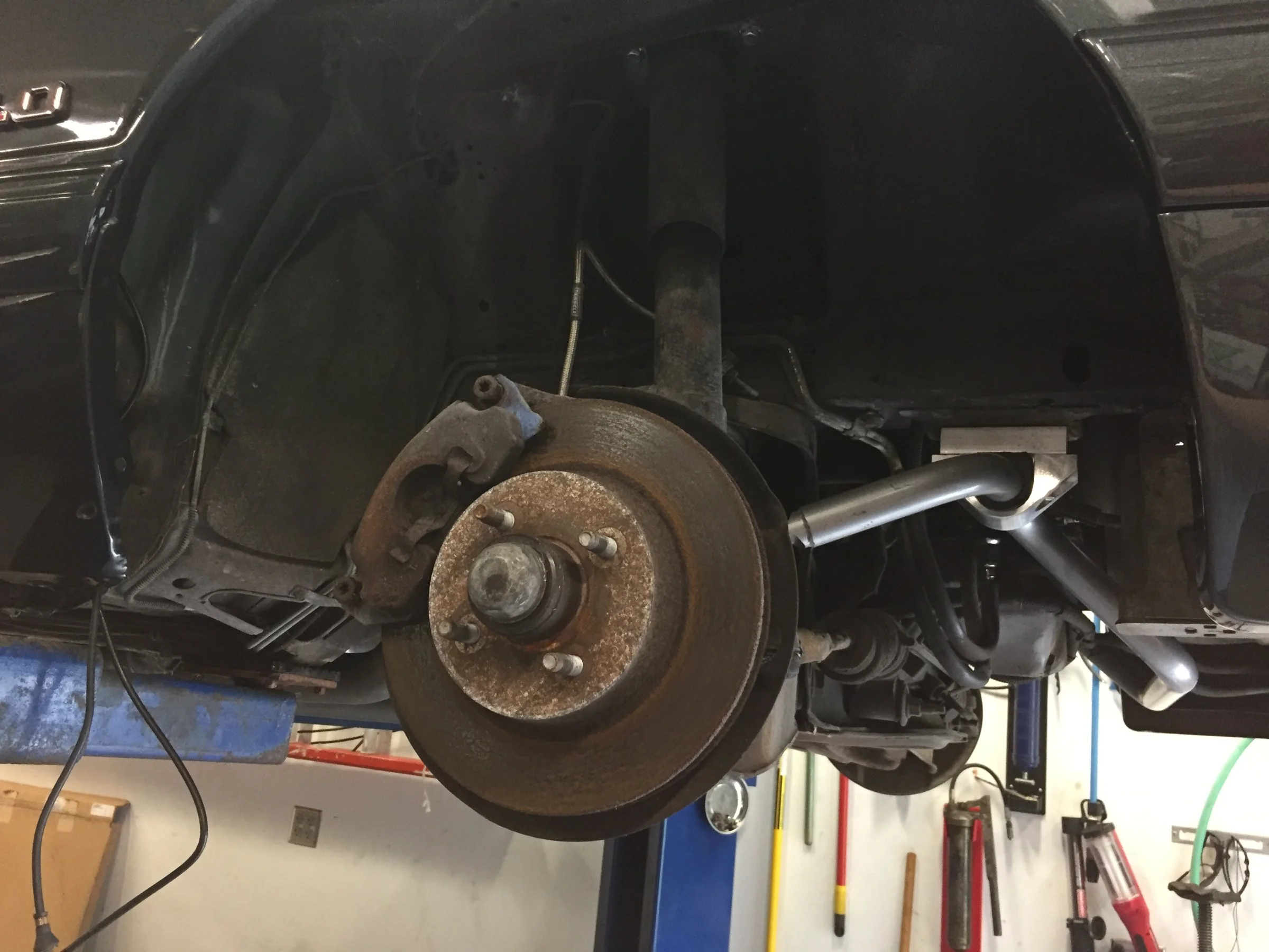

Got after it last night, pulled the front suspension back out and put her back on the dolly. What's that saying, two steps forward, one step back!? Oh well, I wanted to paint the K-member a different color anyways and it will be way easier to stand in there to grind and weld. So I'm focusing on the engine bay now, buying panels from scott rod and welding up some other holes. I do have a question after looking at a bunch of smoothed bays, do I need to run a sway bar? Can I swap in the SN95 sway bar that mounts under the frame rails? My gut tells me that I will want a front sway bar because I do live near some good twisty roads, but I see a lot of people not running one at all up front. The fox style sway bar mounts in the bay look pretty like crap unless you box them in. What are your thoughts and experiences with front sway bars? Anybody swap a SN95 sway bar into a fox? Any feedback is appreciated
qQqQe2KaEGHO7h4ab1vrB8wZComRwEwBYFjmDSv4NQDFIIz8q29s1vyxHYHfYSAh17c8mXk5WhnQfuU7Ij=w1267-h950...webp
Xdji7yzMoJWBYvttzr4BArsUaajcEsGYezUyZQIYJ78khQYHJM1gJxM9s-gm8Y42XWqlrr5ZkfPFSYCl5J=w1267-h950...webp
Reactions: RaggedGT
The only place you should have the sway bar off is at the track. Any corner without it on the street will be hairy
Most people will never look down that far in the bay.
Not worth the consequences to remove the bar. Not sure about swapping a sn95 sway bar. Would make an interesting read. :shrug:

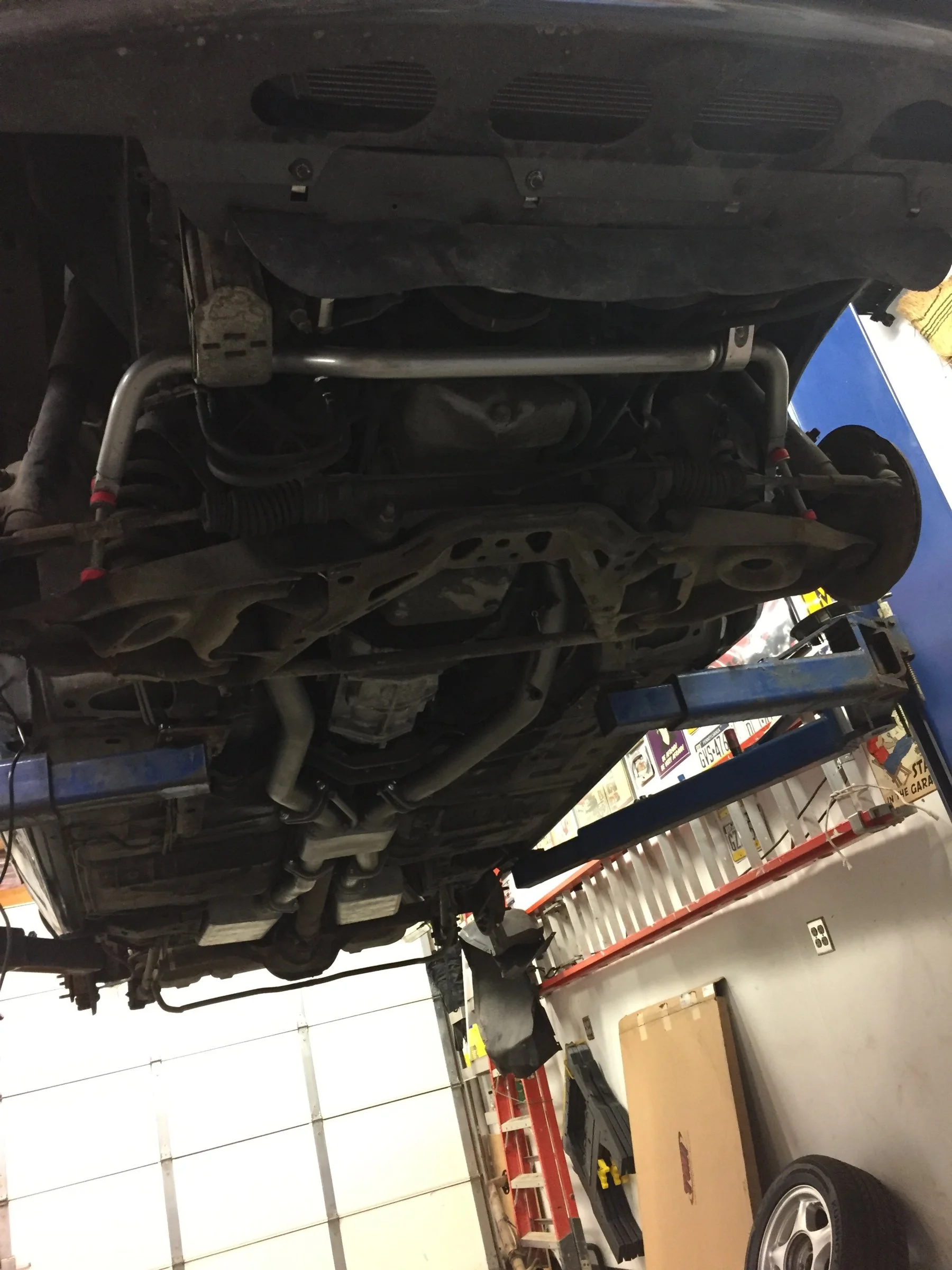

So all of these are track only cars? I don't see any provisions for a sway bar in any of these bays. I'm not trying to sound like a dick, I'm just trying to figure out why or how they ran without one? It looks like my best bet would be to box in the current sway bar mounts so they aren't as ugly. I just see a lot of bays with no mounts or sway bar what so ever, I'm confused...

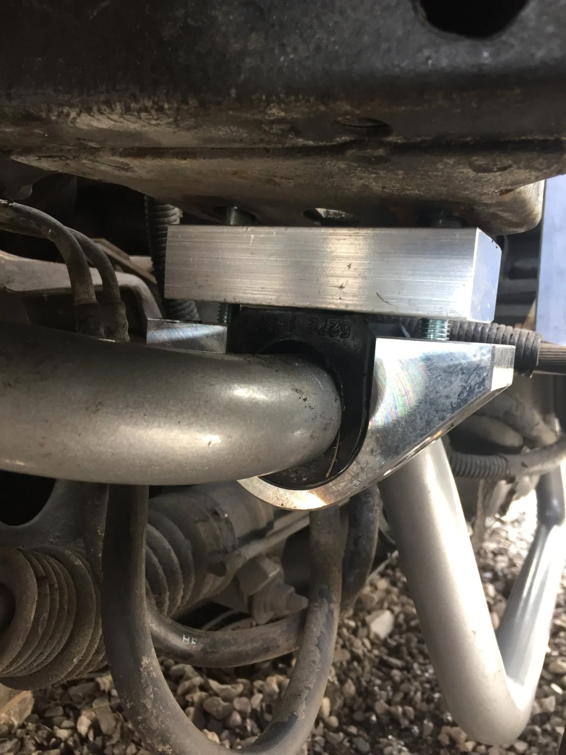

I can't comment necessarily on the importance of the sway bar, but having a car that had accident damage I was aware of, the sway bar mount was all mangled. I got the (expensive) Steeda sway bar mounts which at least look better and could be painted to match engine compartment. Just an option although they're pretty huge:

Thanks man! Do those bolt to the existing fox sway bar mounts along the frame rails? They look really solid, I like those. I'm exploring all my options and I really appreciate you chiming in
No problem; figured it was worth mentioning since I needed a new bracket anyway. Yes, it bolts right up. Way overpriced but it was right after deciding to buy a car and thinking that was really all I needed to have car ready to drive. I should have known better!

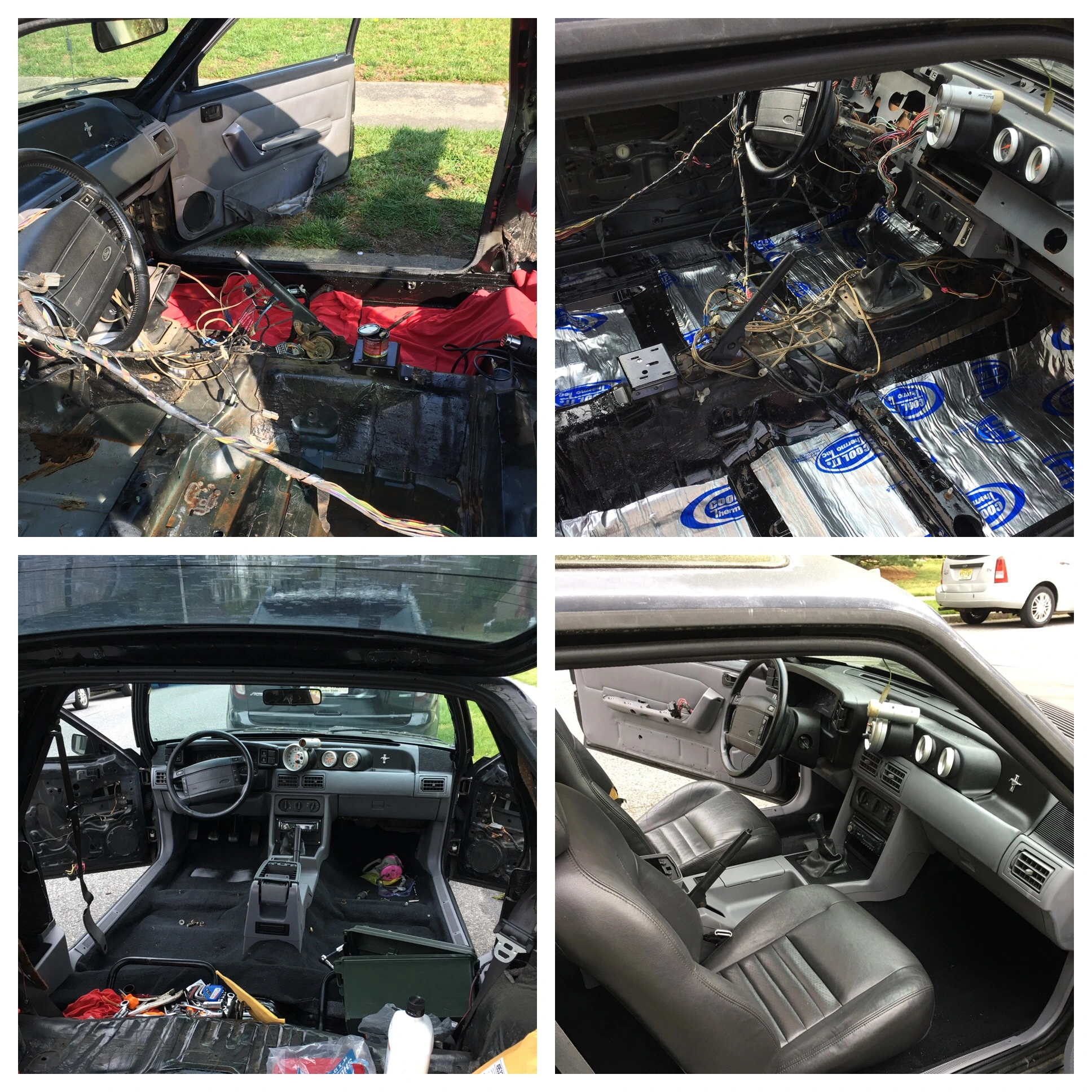

I agree , I actually have been doing that. Driving it around, sometimes with one seat lol. Here's what I done so far, 3 months. I got 99 gt seats in it now, still some work to do inside though , hatch and a few odds and ends.

Ok, run it without one. What's the worst that can happen?
Buddy of mine damn near got killed in a fox because of no front sway bar. When he bought it was missing the end links. He figured he would get around to replacing them in the next few weeks. A few day later he was playing around with the car and ran it up to about 75 MPH then got on the brakes hard to slow down. The brake dive caused the car to become uncontrollable and it spun out in the middle of a straight road. Luckily no traffic was around. The missing end links were replaced the next day and the sway bar was reconnected.
No way I would run any vehicle without a front sway bar that was designed to have one.
