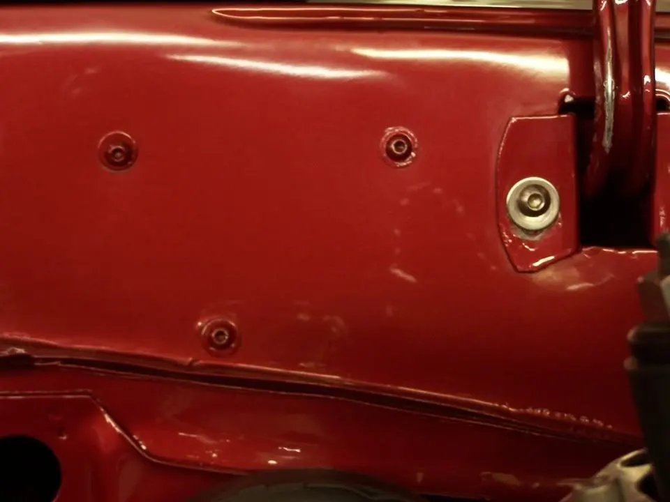

First attempt at hiding the wiper motor went well. I have a few adjustments to make, the motor needs to be raised up a little to allow the arm to clear the cowl. I'm thinking this will actually work! I'm going to remake the plate that attaches to the motor itself and raise it up this time. Then I have to straighten the linkage and the wiper arms and I'll have a stealthy wiper system! I also trimmed up the pinch weld and have been grinding welds like crazy! Spending all this time in the bay better be worth it!

What's the wiper motor look like from the front in the engine bay?

This is what it looks like from the front right now. I'm going to weld the bolts to the firewall and then grind the heads down. The area is concave and the only bolt that really needs to be ground is the bottom one. Then I will cover the concave area with a piece of sheet metal so the whole upper fire wall is nice and smooth. The wiper motor assembly can still be removed and replaced if there are any issues. Even just hiding the wiper motor and being able to see the plate and bolts is better than having that ugly thing hang in the bay, IMO. The way that Trbofox did it, he made the firewall flat but you could still see the three bolt heads. There are lots of options, just depends on how crazy you want to get!
