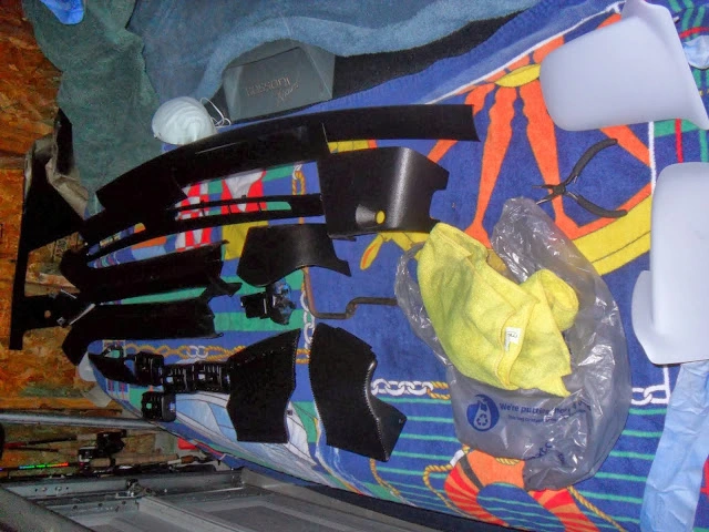

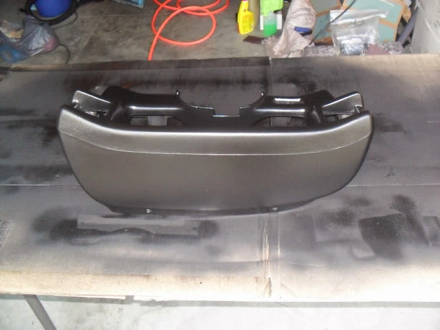

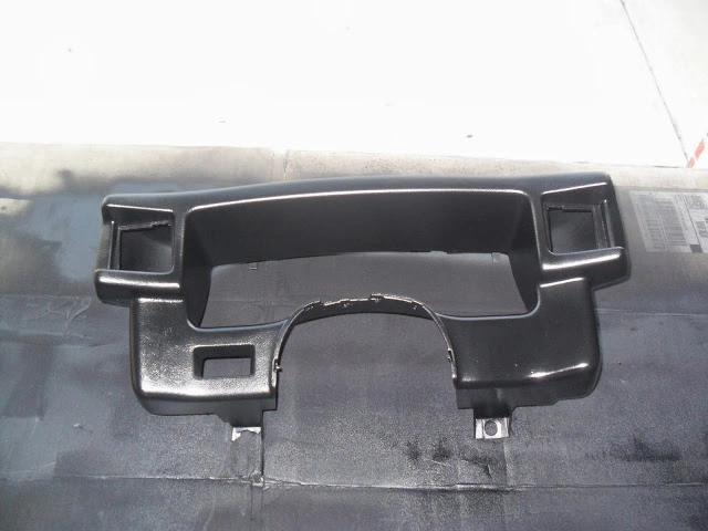

The trim pieces came out nice
Reactions: A5literMan

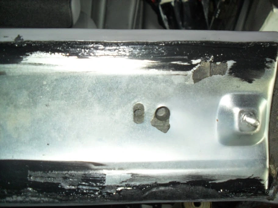

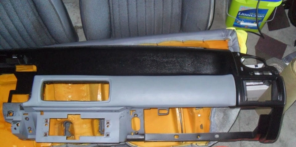

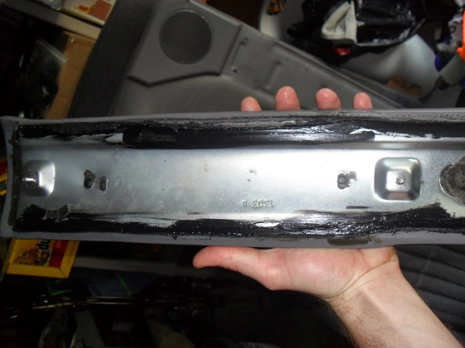

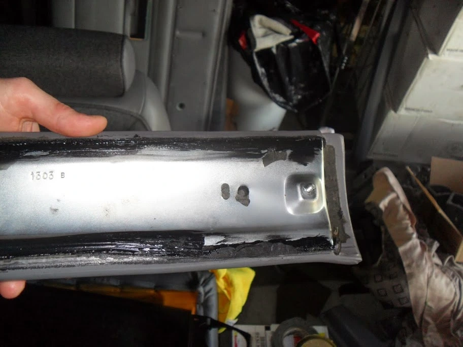

My factory dash pad was starting to do the usual, the foam was pulling away from the metal backing. Otherwise it was in great shape so I tried to save it. I cleaned it up as well as I could, scraping away some of the old foam off the metal. Then I applied a healthy amount of 3M black super weatherstrip adhesive(be careful not to get any on the front;)). I made sure it was formed the way I wanted and then I wrapped the crap out of it with painters tape. I let it sit for a couple days and it turned out great! It probably will only last a couple more summers, but at least I didn't have to buy a new one!
Are you leaving that piece opal grey? Nice work on getting it stuck back to the metal backing.
Thanks, I'm glad it turned out pretty well. I am leaving the dash pad opal gray along with the door panels and center console. I'm going for a black and gray theme and will add black accents to the door panels and other places. I don't have the heart to spray dye my original factory pieces.
I have an extra dash pad, I'm thinking of having it wrapped in black suede with red stitching. Sat in a Lambo with suede and it looked awesome, so I may try it on the pad.
Go for it! Suede is sexy! I tried to wrap one in black vinyl, but had issues with it sticking out too far. I think you'd have to remove some of the original pad to make room for the new wrap. Otherwise it might not sit flush and the vents may be a tight squeeze.

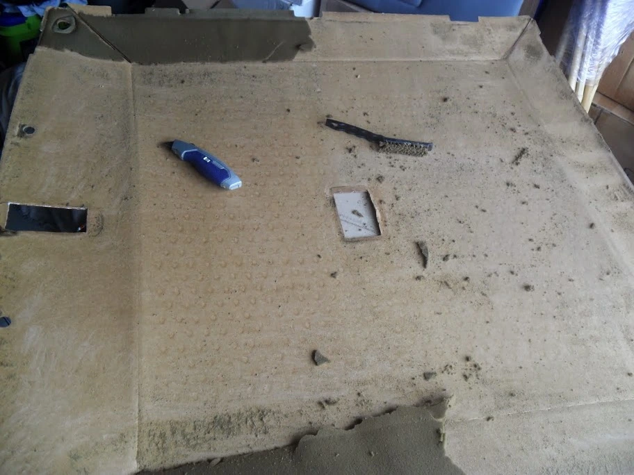

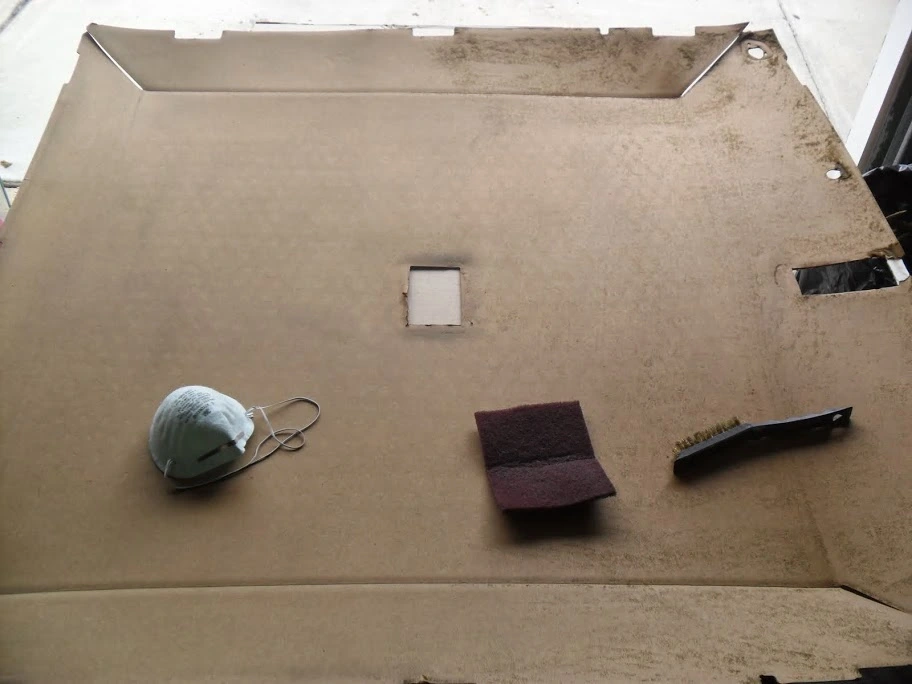

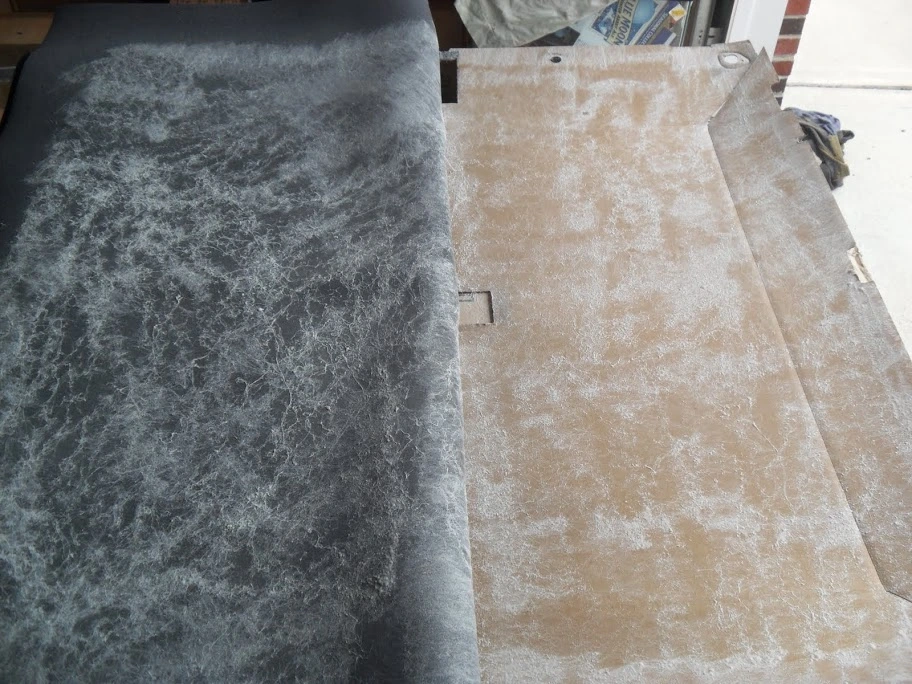

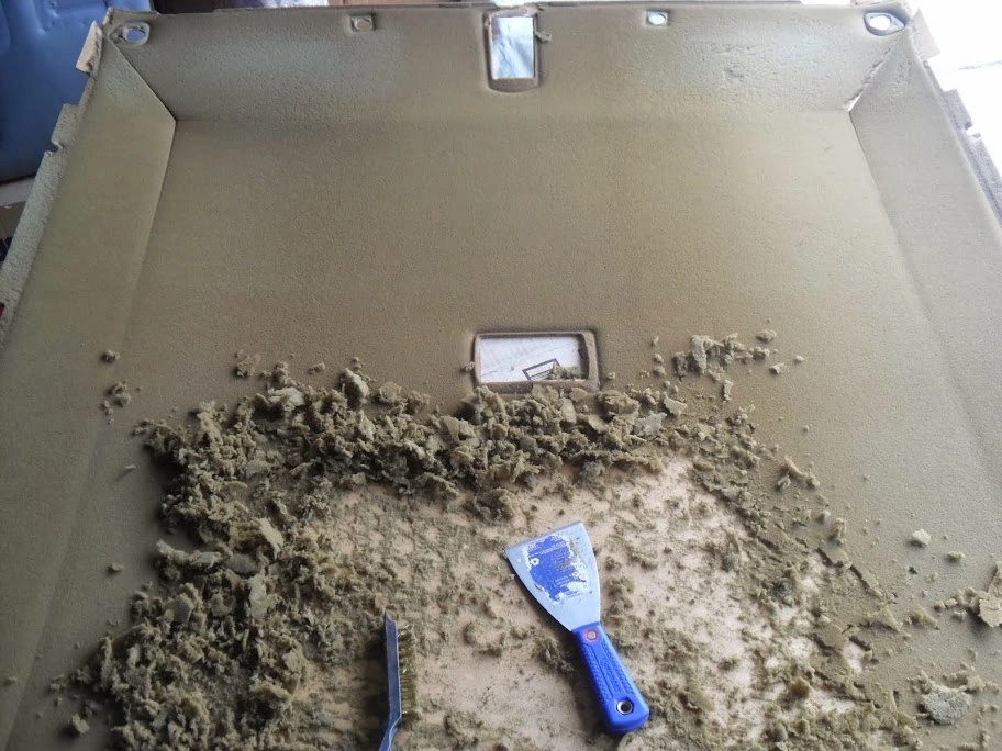

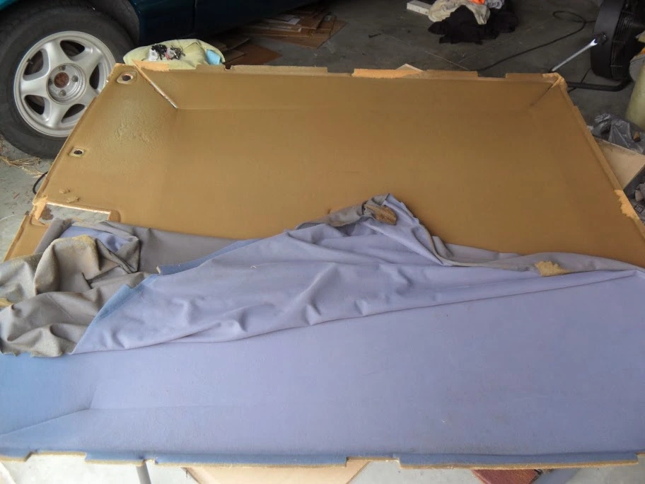

My headliner got trashed from years of trying to fit things that shouldn't be in a coupe. Like surfboards and drum sets and various lumber. So I found this gem in a little blue coupe in the junkyard. It does have a map light hole, but it was in great shape and I took that too!
I had to scrape off all the old nasty foam
Almost done
Then I sanded down the cardboard to get all the old adhesive residue off

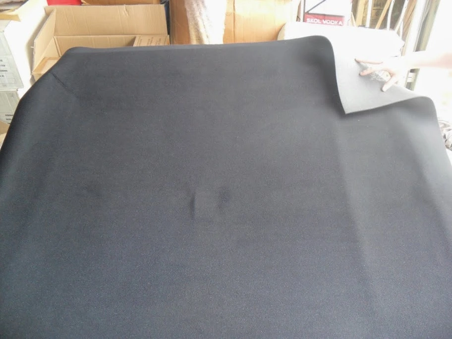

Line up the headliner fabric and spray it down with 3M. Doing half at a time makes it way easier

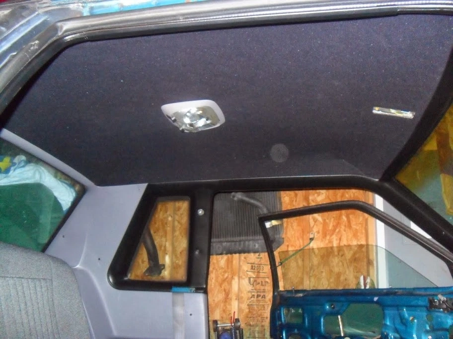

Wait for it to get tacky and carefully lay it flat. BAM, factory fresh!

Very nice! It makes sense that it's the factory light since it's a'93. Looks like they just threw in a light from a '94.
That headliner looked great as it was. That's one way you can tell if an old car was garage kept or not.
Thanks! I may still try to make an older dome light work. The map light and that dome light might look weird together. I had to throw that one in to hold it in place.
