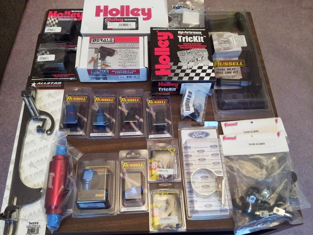

Thanks! I am pretty picky, but trying not to get hung up on all the little details too. The motor will probably be changed a lot as the project evolves. To start out with I'm planning on running a carbed 302 with a 100-150 shot. I have a victor jr. intake port matched to a set of ported and polished 69' 351W heads, holley 650 dp with mech. secondaries and some other goodies. I'm going to use a 100k mile 302 with a stock bottom end out of a 90' and spray it til it dies! The hypereutectic pistons in the 93' motor might not last under the NOS. I'm going to build up my stock 93 block on the side to a 331-347 stroker as the budget allows. The more I drive it, the more I will miss EFI, but I am anxious to get the car back on the road and I have enough parts on the shelf to start out with a quick carb car.
As far as suspension goes, I have a buddy that got me a deal on UPR stuff. I'm going to run the chrome moly K member kit w/coil overs and a-arms, strange 10 ways all around, poly bushings, rear control arms and possibly rear coil overs. I also got a quick ratio manual rack kit, bump steer kit and cc plates too. I'm staying four lug until I can afford the wheels I want, but I've been scouring the junkyards collecting SN95 brake parts. And yes, new parts are starting to pile up too :)

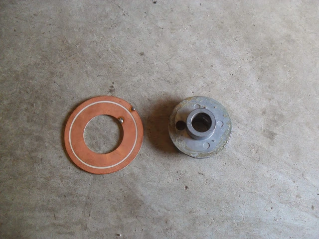

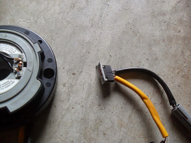

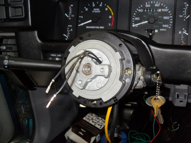

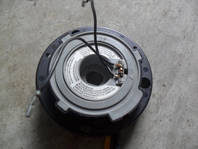

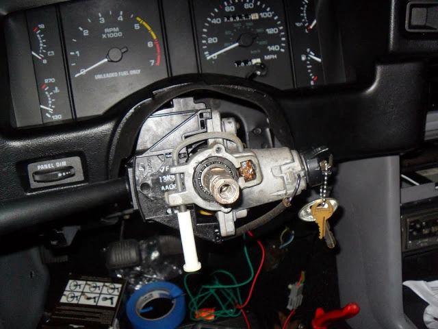

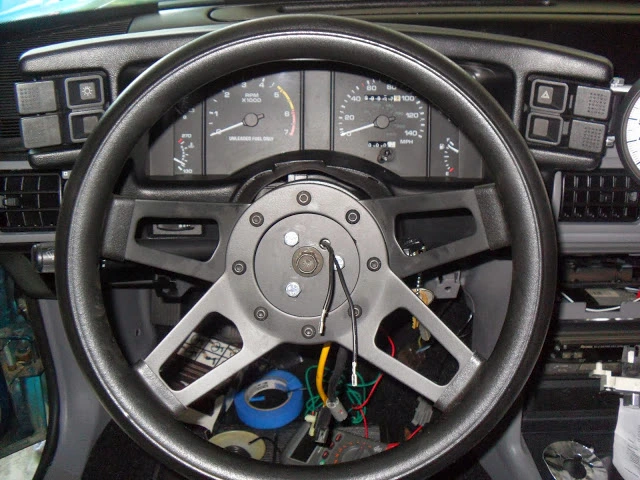

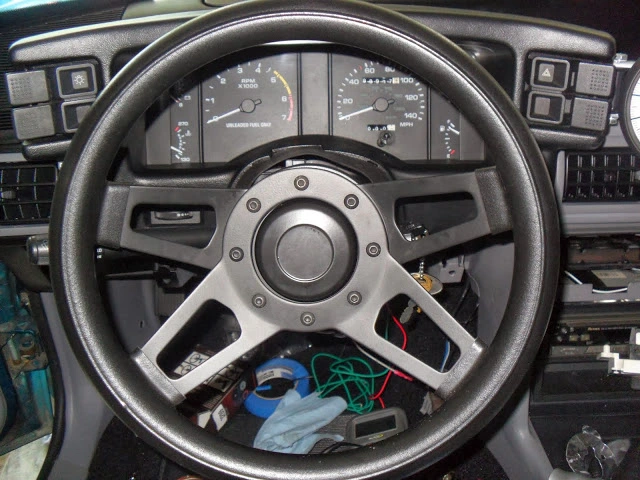

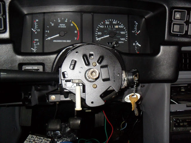

Got a cheap Grant for christmas and finally got around to installing it. The installation kit leaves a lot to be desired. Well, actually it blows. I got out the dremel and was able to modify the stock clockspring to make things a little easier. Came out pretty good, but I'm not fully sold on the steering wheel. Maybe santa will bring me a Momo next year:)
