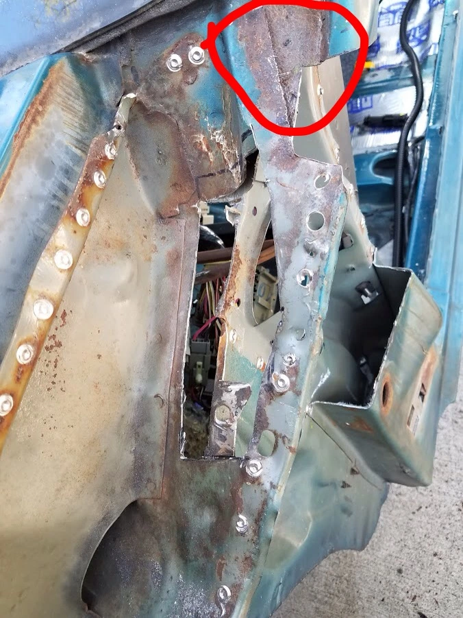

Fresh updates @Davedacarpainter ! I finally grew a pair and cut into the car. I think I got most of it out now, going to sandblast the area around it and make sure all of the surrounding metal is still good. Then I have to cut the donor car up and piece it all back together. Take a look:

Excellent job brother! Blast this area specifically, it looks ugly in the picture, but may not be too bad in real life.
Did you look down into the pillar towards the bottom hinge with a penlight?

Thanks man! It did look a lot better than I expected underneath everything. The area you circled does look pretty rough in pics, but I made a small cut and peeled that section back so I could see in between the two layers and I could see clean metal. The inside of the pillar looks great too. I'm going to sandblast and then start fabbing up little pieces. Can you talk to me a little about how to prevent this from ever happening again!!!? I'm going to use weld thru primer on all the edges and underneath the metal when I'm putting it back together. Then should I do a rust encapsulator and then some type of sealer? My long term goal is to get it painted the factory color again, I'm shopping around for someone to spray it.

There are rust encapsulators that have a flexible wand so you can spray it up inside the pillar after it's welded. I highly recommend this. It's as simple as sticking the nozzle in the hinge holes and rotating it while spraying. (I know this comment will get some of the baser guys here chuckling like Beavis and Butthead).
The outside will need etch primer after your through doing the metal and bodywork. Then just regular refinishing process of primering, blocking and painting..
