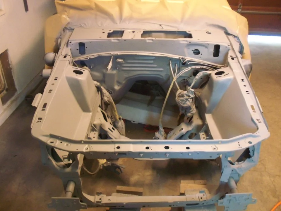

If you wanted a painter in your area (I think your around Charlotte) give Sam at Out of the Pasture a call. They are reasonable and have almost everything you will need.

Thanks man, I was starting to feel far from normal! I completely agree with you on painting the car. I have to do it now, there's no way I'm taking it this far apart ever again. I'm going to shop around and see where I can get the best bang for my buck. I'm not dropping $5+k, but I think I can get it done for cheaper and still be near show quality. The good thing going for me is that my car is really straight, besides the stupid rusty hinge and trunk corners. It won't take a lot of bodywork to get it ready for paint. Unless I get the welder out in the engine bay...
That's funny you mentioned Sam. I'm going to see him at the Charlotte Auto Fair tomorrow. He cut a hinge off a fox for me to use on my car. I'll have to ask him about paint, I didn't know they did that.

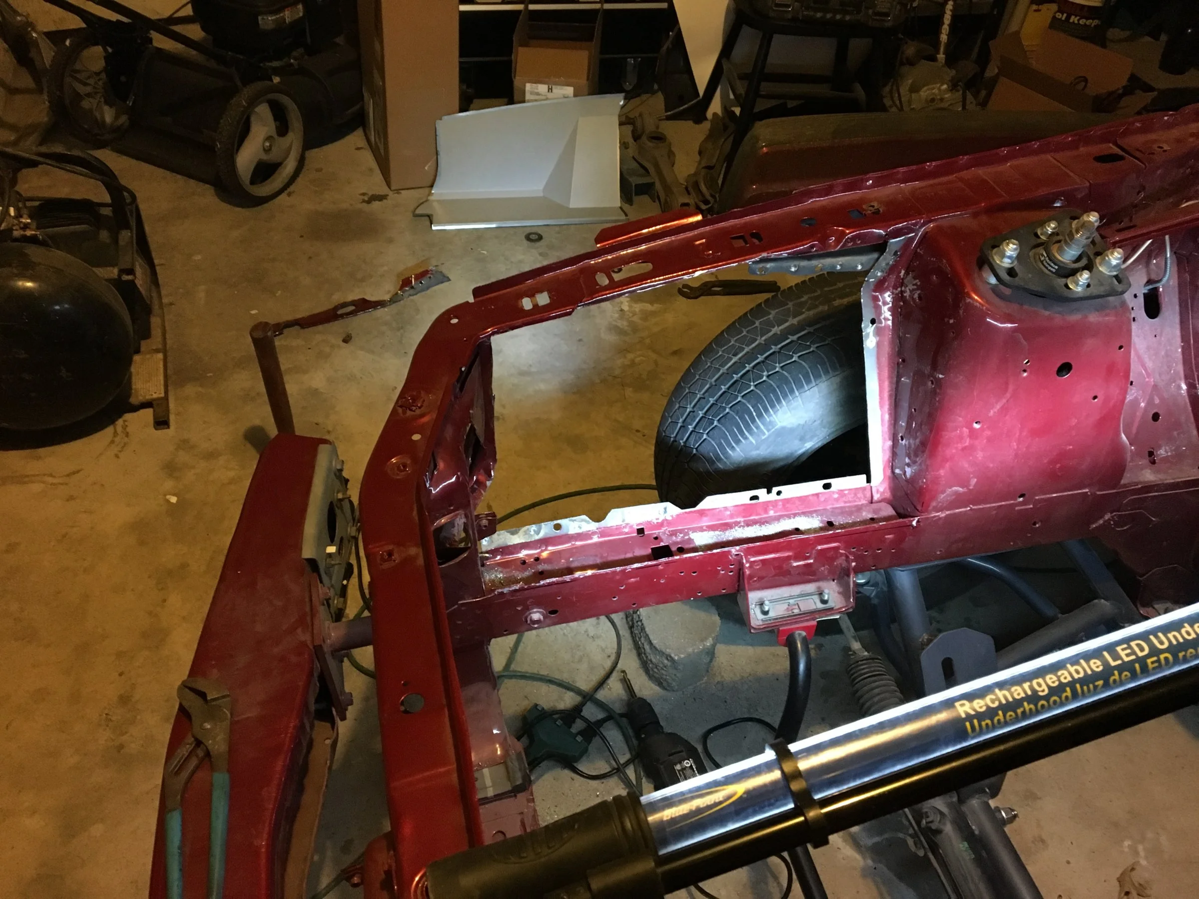

I was able to get the back glass out this weekend. I can't really lift my arms over my head today though, man that was a lot of scraping! I started with the back after hearing horror stories about the front breaking from looking at it wrong. I'm going to try fishing line/wire for the front as soon as I work up enough courage. Then just a little more rust to cut out and onto the engine bay. Which brings up my next question, what did you guys use for for smoothing your bay? Scott rod panels, LMR panels or make your own? I know I'm about to open a door that I never wished I had, but having a smooth bay will be totally worth it. I'm searching for as many engine bay threads as I can find, but if you have any tips or tricks or learning lessons you want to share, feel free.

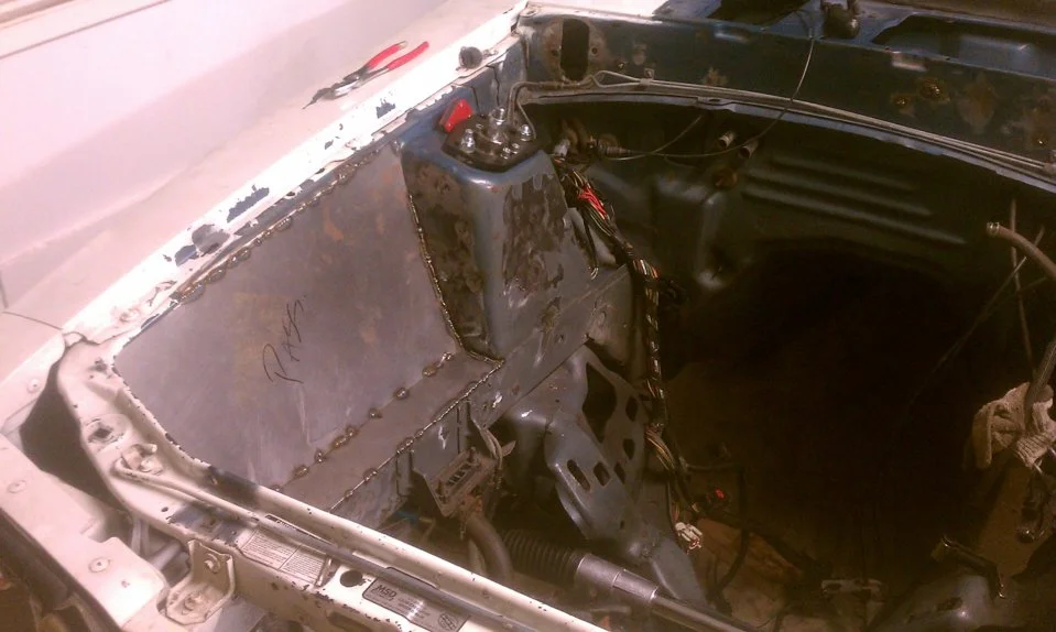

Are you wanting to relocate the battery to the trunk? There are a lot of different ways to skin this cat so it's really up to you and what you like to see under there. I fab'd up my own sheet metal and welded them in, other have bought scott rod panels which is nice to do as well. Either way you do you aprons, once you weld them in, you plug weld all the other holes and grind everything down flat with an angle grinder. Then go over the seams with metal filler (Evercoat is what I used), then I evened things out with a light coat of bondo and then off to etch primer followed by filler primer.
@Fordfreak93

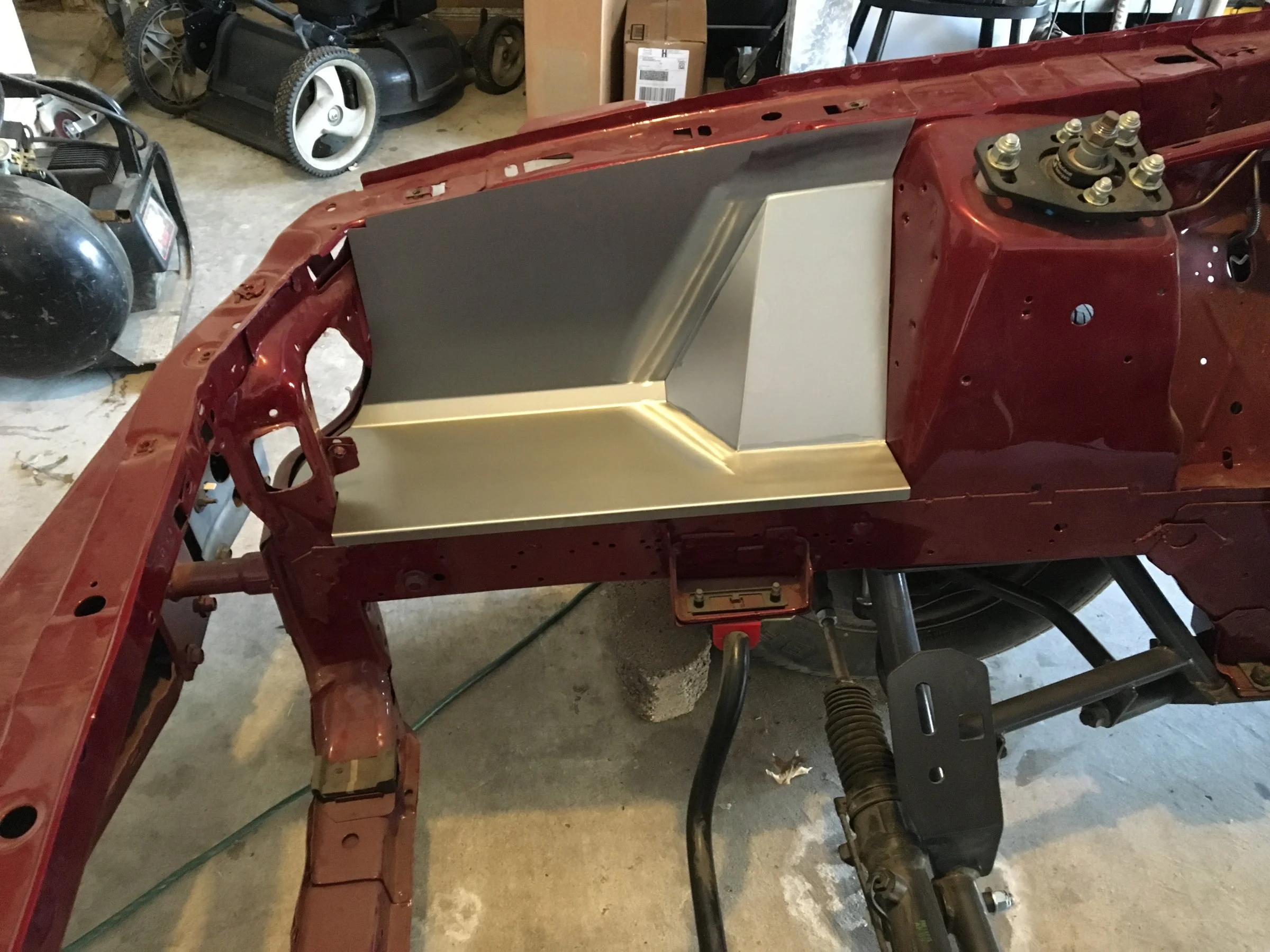

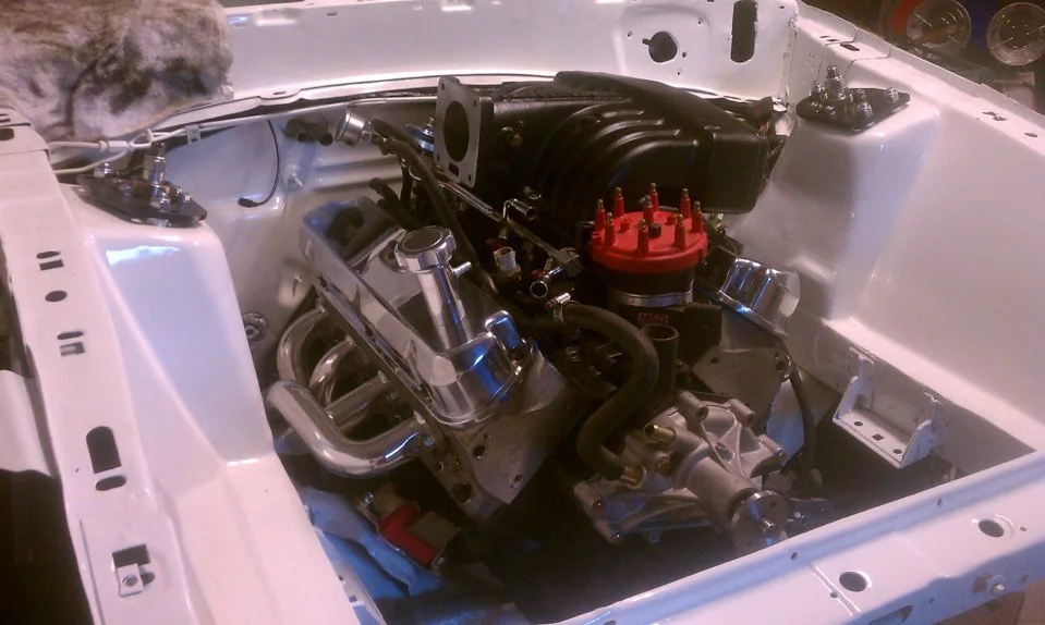

Wow, that looks great! Thanks for the pics! I have relocated the battery to the trunk and I'm strongly considering making my own panels. I don't like the crinkles in the LMR panels and the Scott Rod panels look too angular, when nothing else in the bay really does. I think I'll be happiest with making my own. Being in nascar country, there's a steel place on almost every corner so I should be able to get good prices.
Did you have to cut out these dips out that I circled to get them smooth? I also noticed you kept your sway bar brackets, are you still running one? I was thinking about switching to the SN95 style sway bar that mounts under the rails.
_w-lJVX2Ko4iRxW7amDblC-YBJn-Vfd7yCa3-Uqs6UwrSofRT6rVEjXdxRWodLtK53bowqITkh3AYvKxr3=w1202-h901...webp
I cut my sheet metal to continue straight over those dips then cut other oblong half circle piece of steel to close that hole up. I unlike Dave (@Davedacarpainter ), did not remove my OEM aprons. I wanted the original aprons to screw, weld, and attach my wiring that I was tucking to.

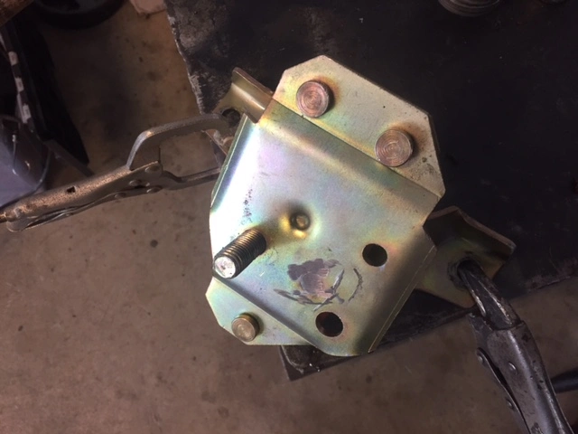

On another note I see that you have a UPR K member. Lets talk about my frickin headache with that pile of crap I had this weekend. First, please check to see if your motor mount for the passenger side fits in the two elongated slots. Mine did not, they are too narrow. So I had to grind the stud off (see picture). Then I found out, after installing my engine and trans, that there is hardly any clearance for the power steering lines and the driver side motor mount. Thank goodness I have offset rack bushings or else the mount bolt and my rack would've been occupying the same space. I had to modify some stuff to make this work. I must have an old UPR K member from when they were putting out a poor product and stealing peoples money. Most likely I'll buy a Maximum Motorsports K member and throw the UPR in the trash. Anyways, please double check your K member early although it looks like you have a manual rack right now. Just in case you ever go back to power I would be cautious.
Reactions: Fordfreak93
@FoxMustangLvr Don't give me another reason, I am so close to pulling all this UPR junk off my car and throwing it in the trash as well. It might be better than a lot of other junk out there, but to me it's still junk. Quality and fitment is nowhere near the level of Maximum. I got an amazing deal on the full suspension through a friend who is a dealer (k-member, coil overs, a-arms, uppers and lowers) and it was some of the first parts that I bought for the car. Looking back, I totally regret getting their stuff. Scratches and poor powder coating on every single part right out of the box, not to mention the fitment is garbage. I had to wrestle my front arms in, the jig for the arms appeared to be off on both sides. I went to install the uppers and lowers in the rear and the powder coating was just flaking off. Apparently the sprayed right over rusty metal, you can see it bubbling up on all of my control arms. Fighting the rear end in was just that too, a fight. I feel like all of this crap is just a little bit off. Maybe I got the stuff that was made at 4:30pm on a Friday, looks like they didn't care enough to make it perfect. I'm going to check out the motor mounts tonight and if they don't fit...
Look at this junk...
