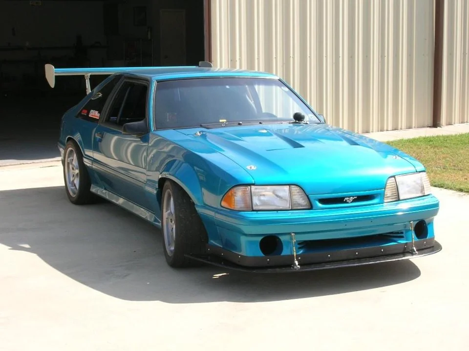

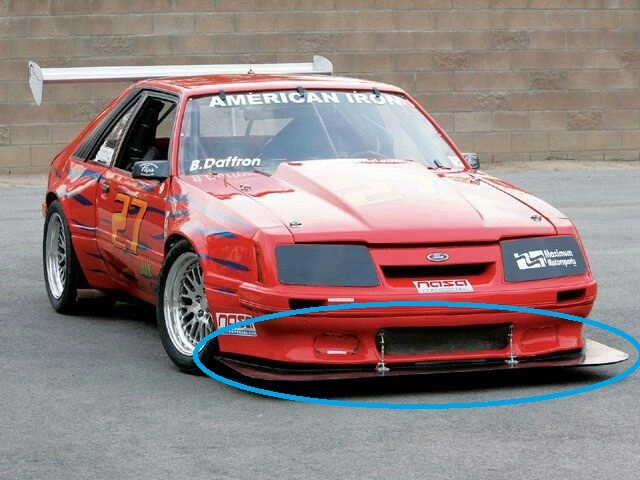

What's the proper name for the piece that I have circled? More importantly can someone go into detail about how this helps? Is it just more surface area for air to move over, effectivly causing more downforce?
Thanks,
Garrick A.R.

What he said.
Those aluminum rods in the front adjust the angle of the splitter. Lengthening the rods points it closer to the ground, increasing the air pressure in front of it, thus increasing the amount of downforce and front end grip.
You'll often see a lot of imports with giant rear wings on the trunk lid that do the same thing.
...unfortunately, increasing downforce over the rear end on a front wheel drive car has the opposite effect that most people look for....but it sure looks "mad tyte" though, doesn't it. :D

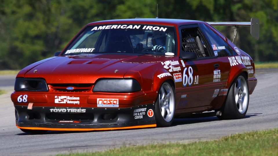

Thanks guys! Yes Brian, mad tyte Ha-ha. I read earlier that a rear wing actually needs to be higher up (closer to the line of the roof) in order to work effectivily. How true is this? I've never researched arodynamics or wind resistance.
I suppose to get maximum efficiency out of a wing It's good to get it out of the turbulence the roof creates. Steeds advertises their wings as being functional and they're not really any taller than stock.

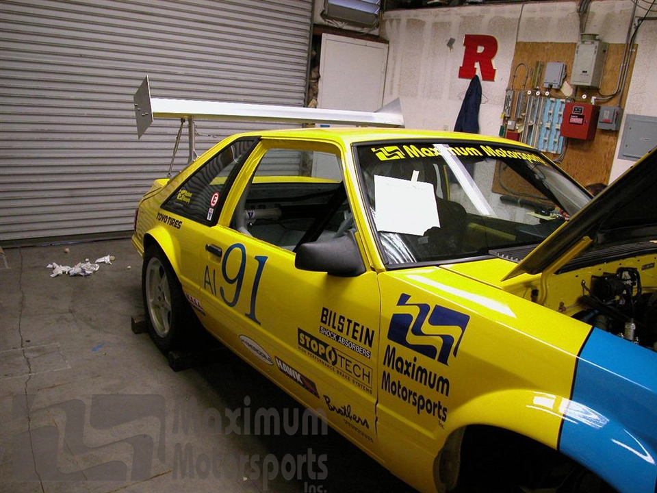

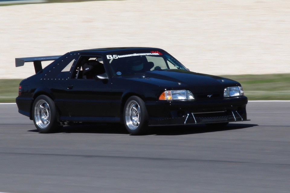

I'm wondering why people are using fixed splitters and wings. Why wouldn't you run adjustable ones so you can tweak them to gain the perfect amount of DF? Then again, is it safe to say you wouldn't be able to even feel a difference? Would you need a wind tunnel to get it correct?

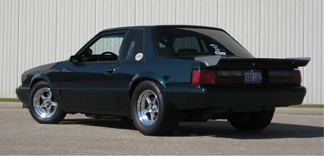

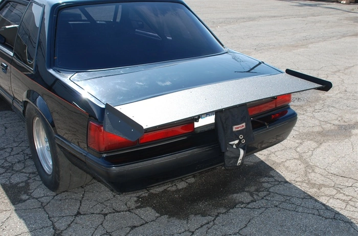

Gotcha. I must admit when it comes to "styling" I'm not the person to ask. What I think looks good most people wouldn't like and vice versa. I'm just worried about functionality. Ah, that was another question I have that Brian just reminded me of. I assume down force be down force, correct? Then how come drag racers run that wing that comes straight off the back and SCCA guys run the tall wings?
I'm sure there's a very good reason for the two different styles, but I don't have the foggiest idea what it is. I'd be interested in that myself.
How about this, the wing is a lot less susceptible to damage from another car hitting you in a corner than a pro stock style spoiler.
