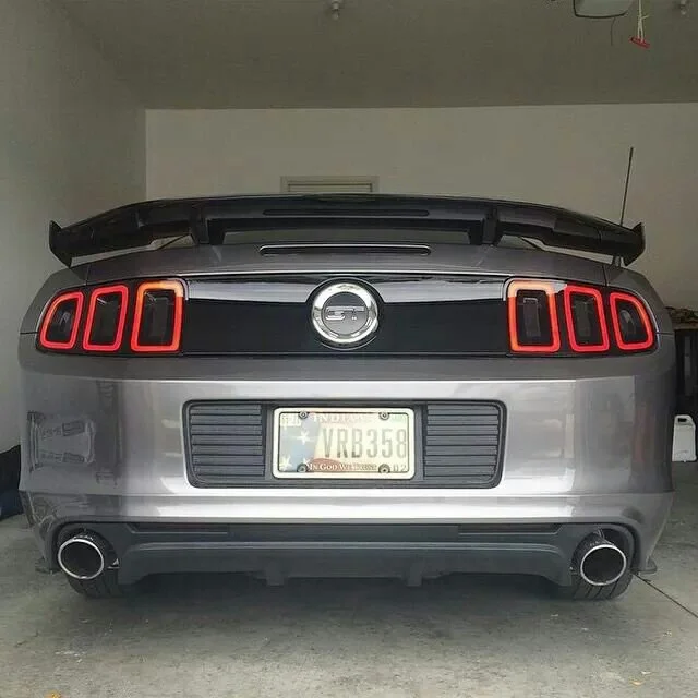

Saw this today. Thought I'd post it. Steeds race wing

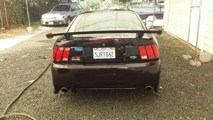

Steeds posted this, this morning. That looks good. A guy here in town put one of these wings on an SN95 and looks good. Not sure if it is "functional", but it looked good.
