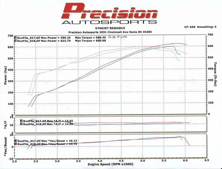

Wait, What? Which nozzle did you use and where was it placed?
Hi
Edit: We dynoed with only the one existing nozzle in supercharger, then added the second while on the dyno. Then redynoed.
Sorry about the confusion.... tried to use 2 nozzles but HP/torque rolled off, so we disconnected the pre-blower nozzle. The snow rep (Michael Plummer) wasn't a big fan of it, but I wanted to try it!!
I only used the snow nozzle going into the supercharger bung!!
Here is the graph, added 2 degrees timing and lost power.
Hope that helps.. Steve

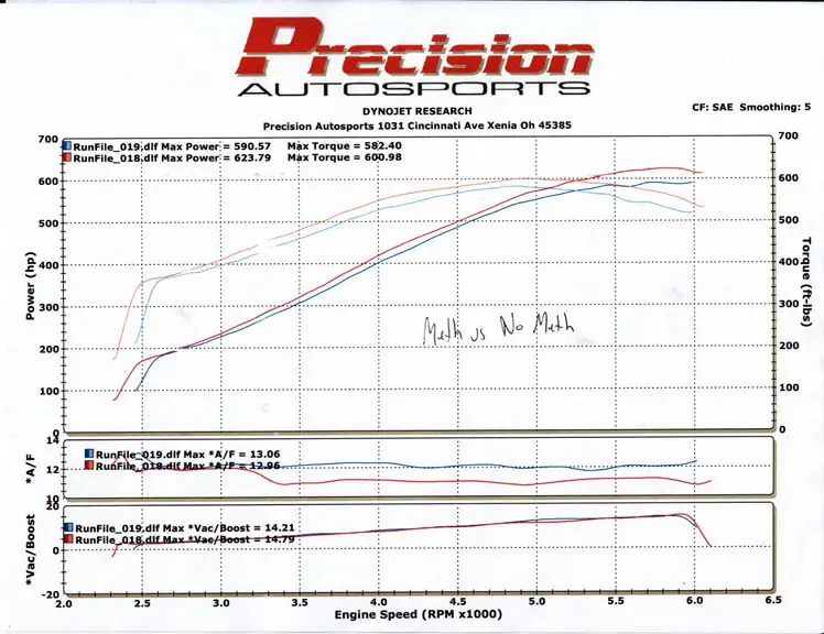

very nice numbers ! did you make a pull with no meth ?
Yes, have a multiple tune chip ? 0 is no meth, 1 is meth, 2 is valet .. 3k rev limiter... will never use it but what the heck
I had 543 rwhp last tuneup..... 43hp non meth increase..... I like it!!! $500 for intake, $220 for T/B That is about $18. a HP , Plus tune and a couple things... still good bang for the buck!!
